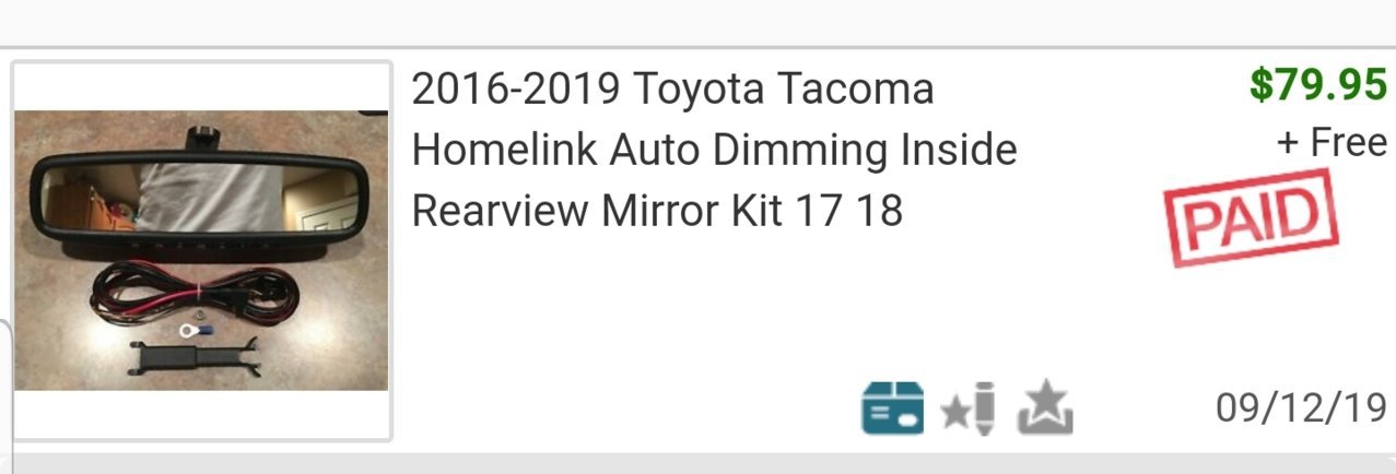

    Well tried to install the mirror tonight but the plugs are keyed differently. Any suggestions other than running the new wiring harness? The plug on the truck has a key in the plug where the new mirror does not have the key so the plug will not fit.

    Problem is I purchased the Homelink mirror on Ebay with a no return so I'm $80 iin already. Hate the thoughts of digging around in the headliner of a 2 week old truck to run the new harness but if I to I have to.

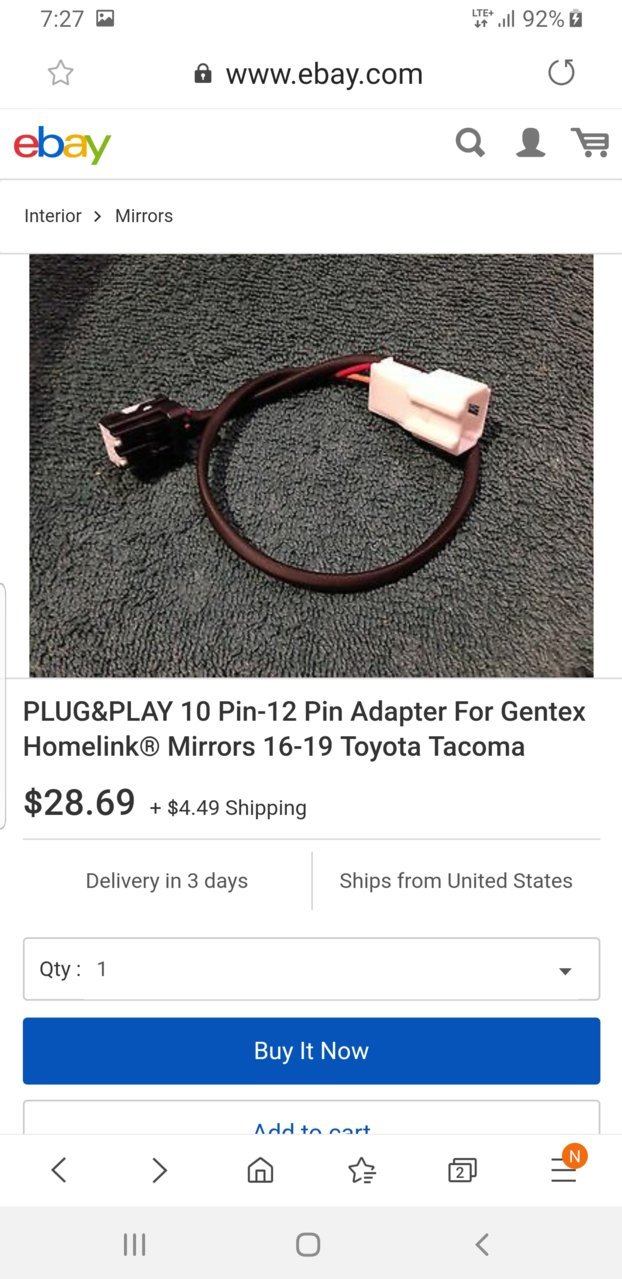

    Did some Goggle searching this morning and found this adapter plug. I'll check the factory mirror plug when I get home tonight to see if it's a 10 pin or 12 pin. Also attached is the Ebay post so I think it's the right mirror but possibly not.

    Yeah must have made a change on the 2019. Factory auto dimming mirror has 12 pins the one I bought on Ebay only has 10 pins. So guess I'll buy the adapter stuff the excess into the roof console area. Lesson learned, thanks for all the responses.
