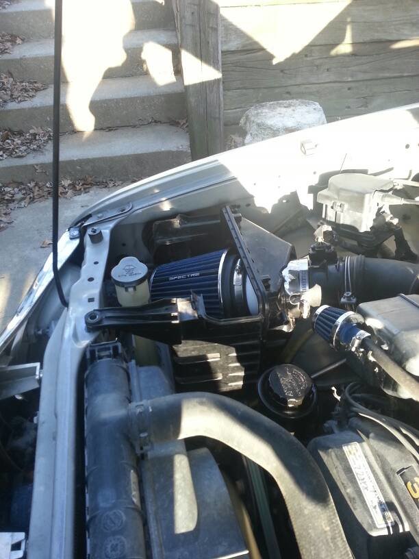

    Alright so I was tired of my deck plate mod airbox and crappy filter so it was either make a cold air or get a kn filter. I went with a cold air. I decided on a hollow ended spectre air filter that has a extra large hole for attachment to the intake. (I think my stock maf sensor was busted off so it worked out well) I just basically slapped the sucker on there and put a breather filter on the random hose that was left just in case! It seems to have made a pretty big difference already! Much better throttle response and it screams a little louder ;). You can hear it sucking air in the cab reallllly well and it sounds equally badass with the hood popped. Let me know what you think! :cool:

    Well...you asked what we think.....
    Instead of sucking air from the passenger fenderwell (which is actually cold air), you are now sucking in air that's 6 inches away from the exhaust manifold. Effectively you just made a hot air intake. I'd bet my money you dyno'd your truck before and after, you lost ponies.

    A warm air intake might get you better gas mileage in cold weather. Less oxygen=less power.

    Agreed. The factory Denso filters are top notch.
    And to the point of racetrucks that run open air filters in the desert, even they don't run a wide open filter because of all the dirt and shit that passes thru them. They all run a pre-filter screens over the open air filters.

    It looks cool, but I have to agree with jberry813 and Rich91710 that you changed it from a factory cold air to hot air, which is probably not going to help you a lot, especially when summer comes along. But for now, rock it!:headbang:

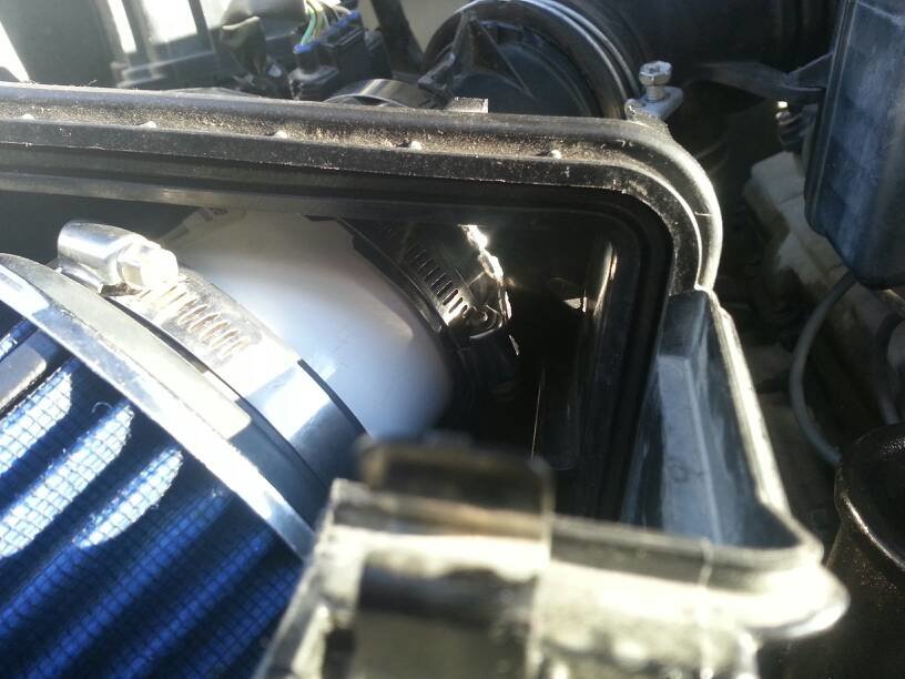

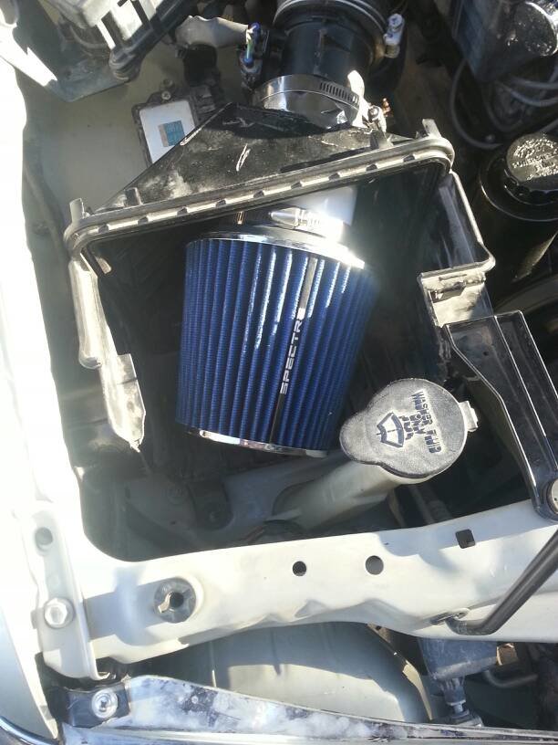

    Ok so you guys suggested a heat shield. So I got to thinking. I'm no fabricator by any means so I started looking at my stock airbox and my dremel and said what the hell. I started by widening the hole where the maf sensor was to at least 4 inches wide. (the sensor broke off years ago and it was taped on) then I took the lid off and the front wall off. Then I took the rest of the plastic in front of the lid off. I wanted to use the large cone filter still and I couldn't fit it on the maf sensor and have enough room to put it in the air box. So I went to Lowes with maf sensor in hand and played around for a while. I ended up with a 3 in pvc coupler and a 3in no hub rubber and metal couple with large hose clamps on them. This made the connections all air tight so the air comes from the filter. I wanted to keep all the mounts om the box so it didn't wobble so I replaced the bolts on those as I lost 2 of them when I took it out originally. :banghead: I hope this will suffice as a budget cold air and hope it will bring colder air to the engine and not from the manifold. Tell me what you all think! esa8uhuq_fca2c5943b263914e80510e6142243c684ebff72.jpg 2y7a3ypy_a68be4f4cf6e41a498eb3cd1b6f783536dc11980.jpgehy8eba6_f251120dafbb816ec610a1ead87611f47f92c699.jpg

    I like it :):)
    I would have never thought about using the stock box as a shield ^,^
