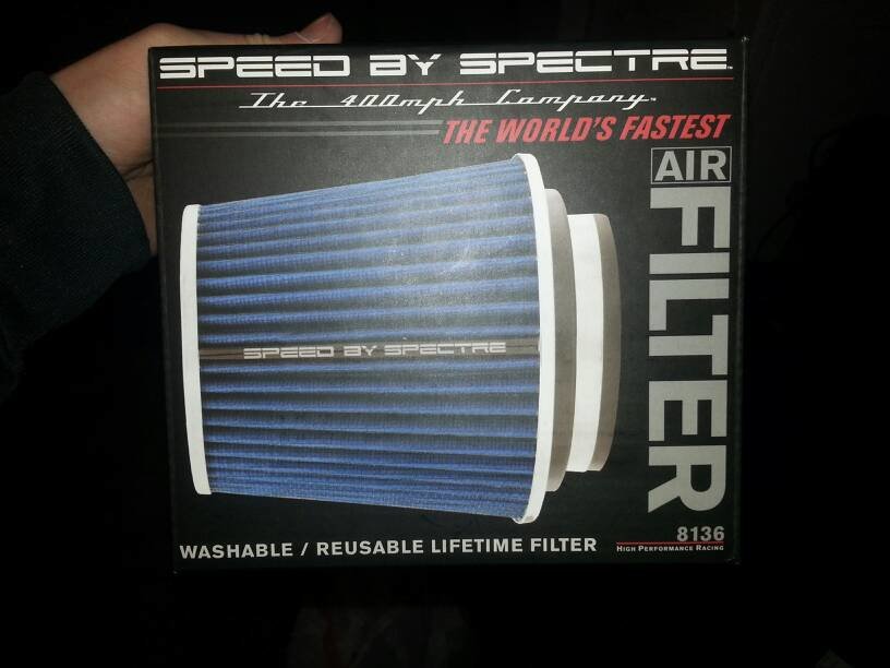

    The filter I have is a washable filter. Does that mean I could get the oil off of it by pressure washing it? I did that once when I pulled a shit ton of muddy water through it accidentally. 2asyvevy_c935296083b6c7c5963ceb9feaea1f25b9f40af4.jpg it says washable/resuseable

    Pressure washer (even a garden hose nozzle) will damage the fabric.
    If you pulled mud through that filter and used a pressure washer on it, it's trash.
    Never use anything more powerful than water running from a sink sprayer.
    A common old-timer's trick to extend the life of a paper filter was to blow compressed air through it.
    It worked if done properly, but if you got the nozzle too close, it would blow a hole in the filter... it's really not recommended.
    Water from a pressure washer can rip through that like a knife. Even if you can't see the damage, it's trash.
