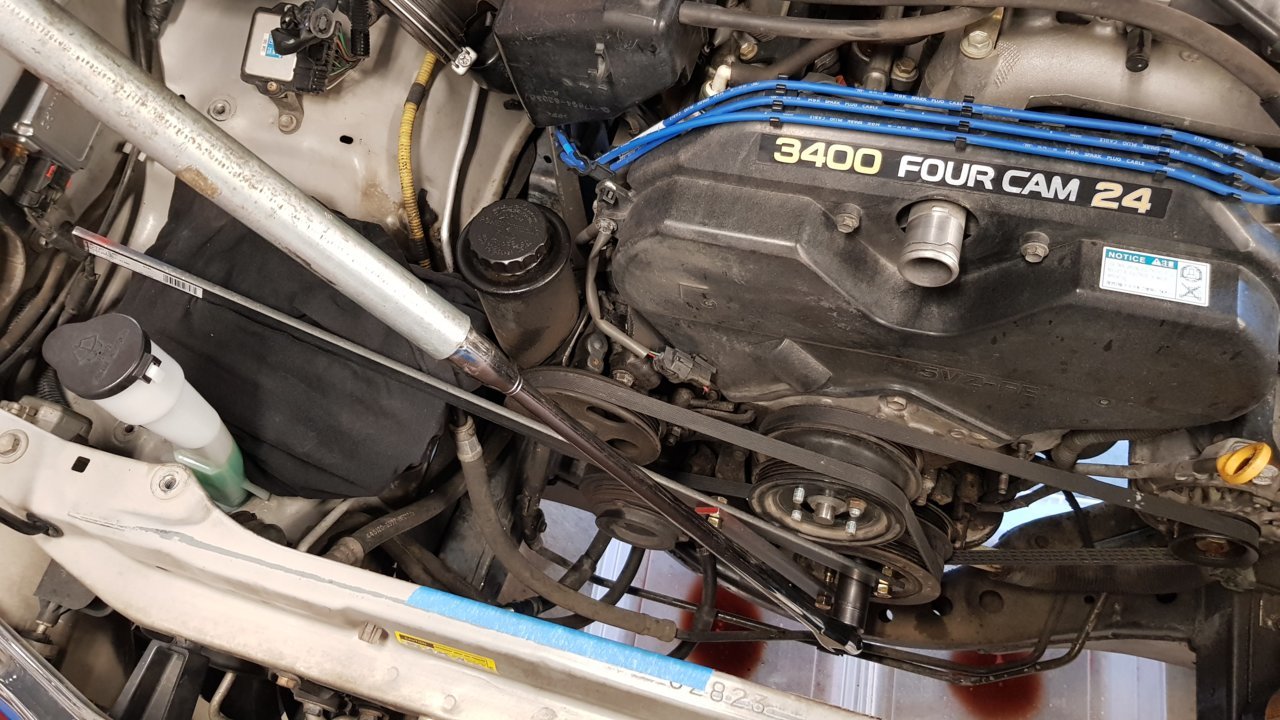

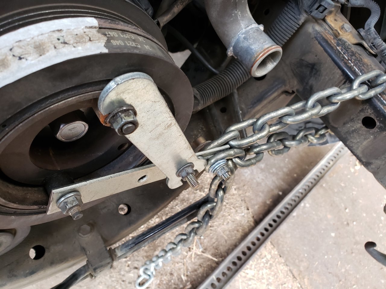

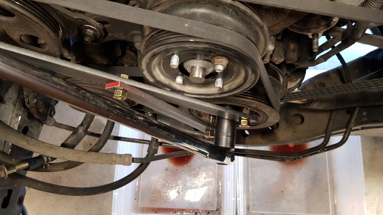

    Here's the one I made today. Less than $15 & quicker to make than you have time to drink a beer.

    I like yours, its adjustable.

    I made one like his and it was super easy to use - as you could see of course!
