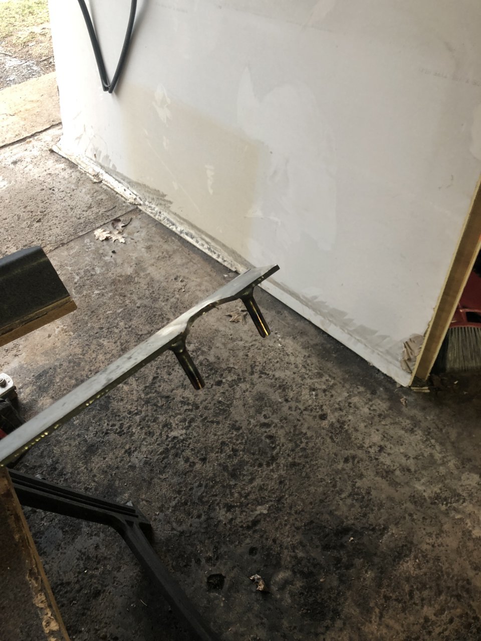

    I just whipped one up out of some bar stock and 3/8 rod... she’s ugly but worked perfect! Would be happy to TW express it to anyone in need! Having a welder now has opened up a lot of quick/easy avenues to get stuff done on the truck :cheers:

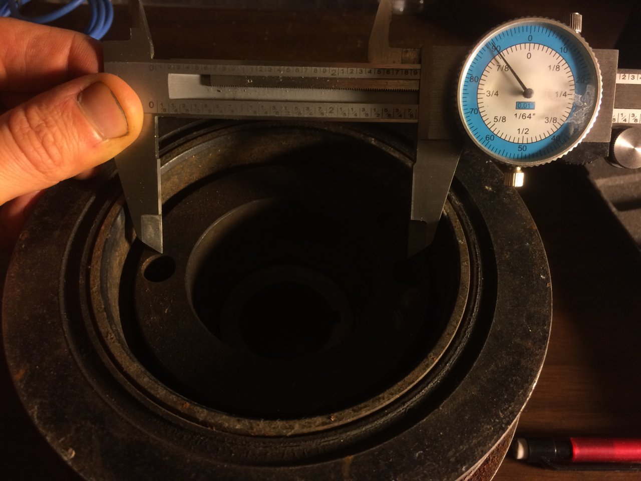

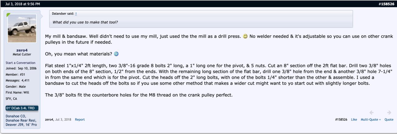

    Yes and to answer a previous question about the distance between the holes, it's 2.89" from center to center (a tiny bit more than 2 7/8"). As far as preserving the balancer, not likely, too early for a timing belt change?
    Most tools like @zero4's don't require that measurement as they are adjustable. Here's the specs I used for making his:
    https://www.tacomaworld.com/threads...st-gen-edition.138573/page-7927#post-18172014

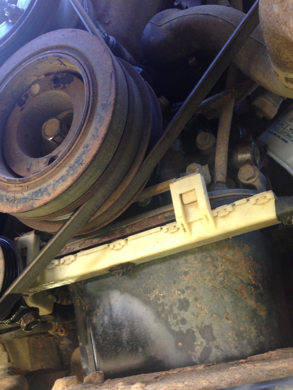

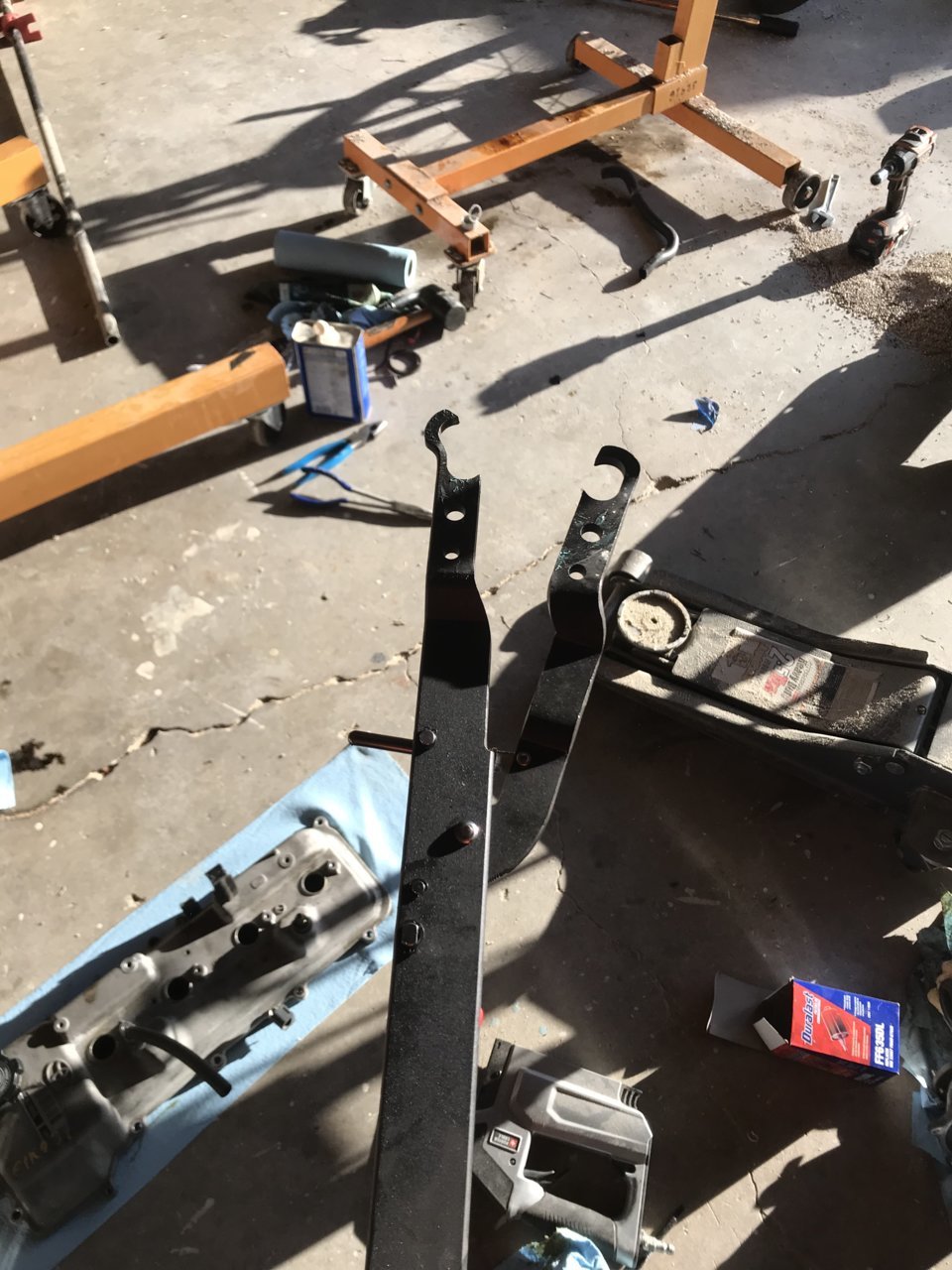

    Engine is out of the truck on a stand, I put a few bolts into the back of the crank with the fly wheel off and wedged this thing against the engine stand. spanner.jpg

    Yeah 1/8" isn't thick enough - 1/4" still flexes a little.

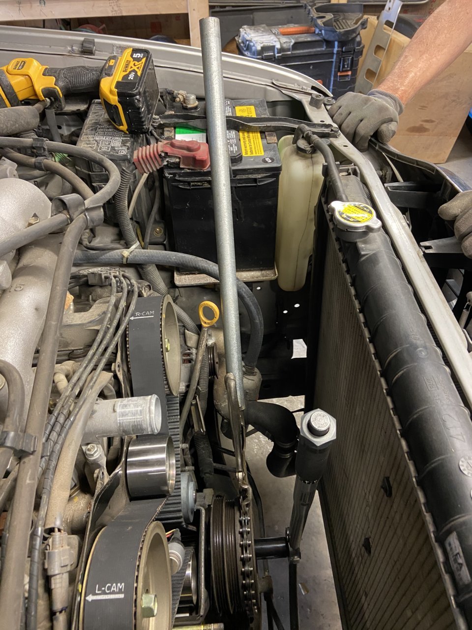

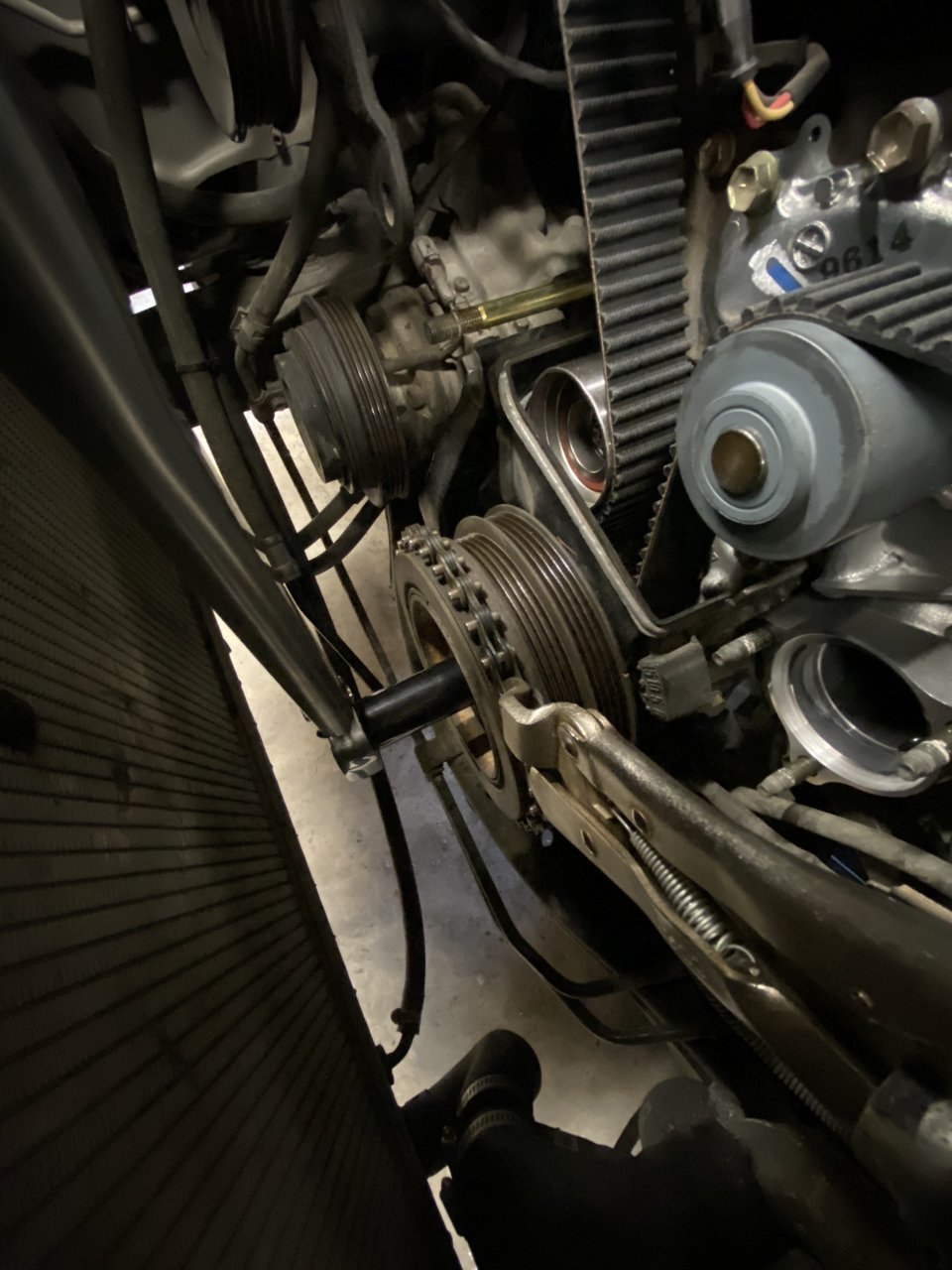

    My father in law and I devised yet another way to hold the crank pulley while torquing. We used a piece old belt wrapped around the pulley and a chain wrench tightened over that with a handle extension. Quick and free!
    (yes, I know we put the timing belt on "backwards" ...the arrows should point towards front of truck)
    Brie likes this.

    May not be a great way to do it. Some of the pulleys (harmonic dampers) have a layer of rubber between the inner part and outer pulley to dampen vibrations. By holding it this way you can damage the bond between the rubber and metal pulley. Sometimes this happens on its own after many miles.
    I'm not sure if the outer pulley you held has this rubber layer, but I'd keep an eye and ear on it for any unusual vibrations or noise. Make sure it doesn't develop a wobble, etc.
    Brie likes this.

    it’s solid metal

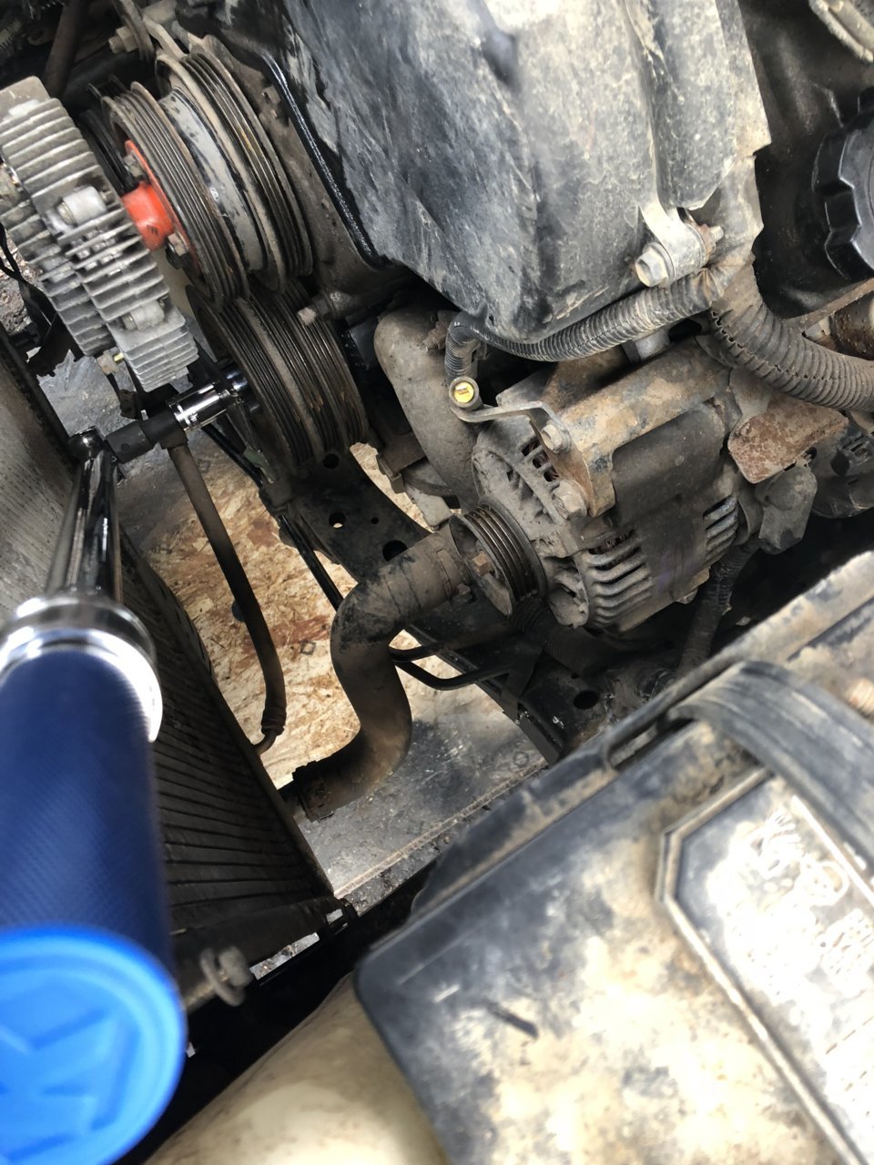

    Wanted to toss another one in that I happened upon whilst researching this -
    Two chains, one wrapped around the left side of the frame, the other, the right. Then bolt each of the two end links (or links that meet up when taught) into the pulley.
