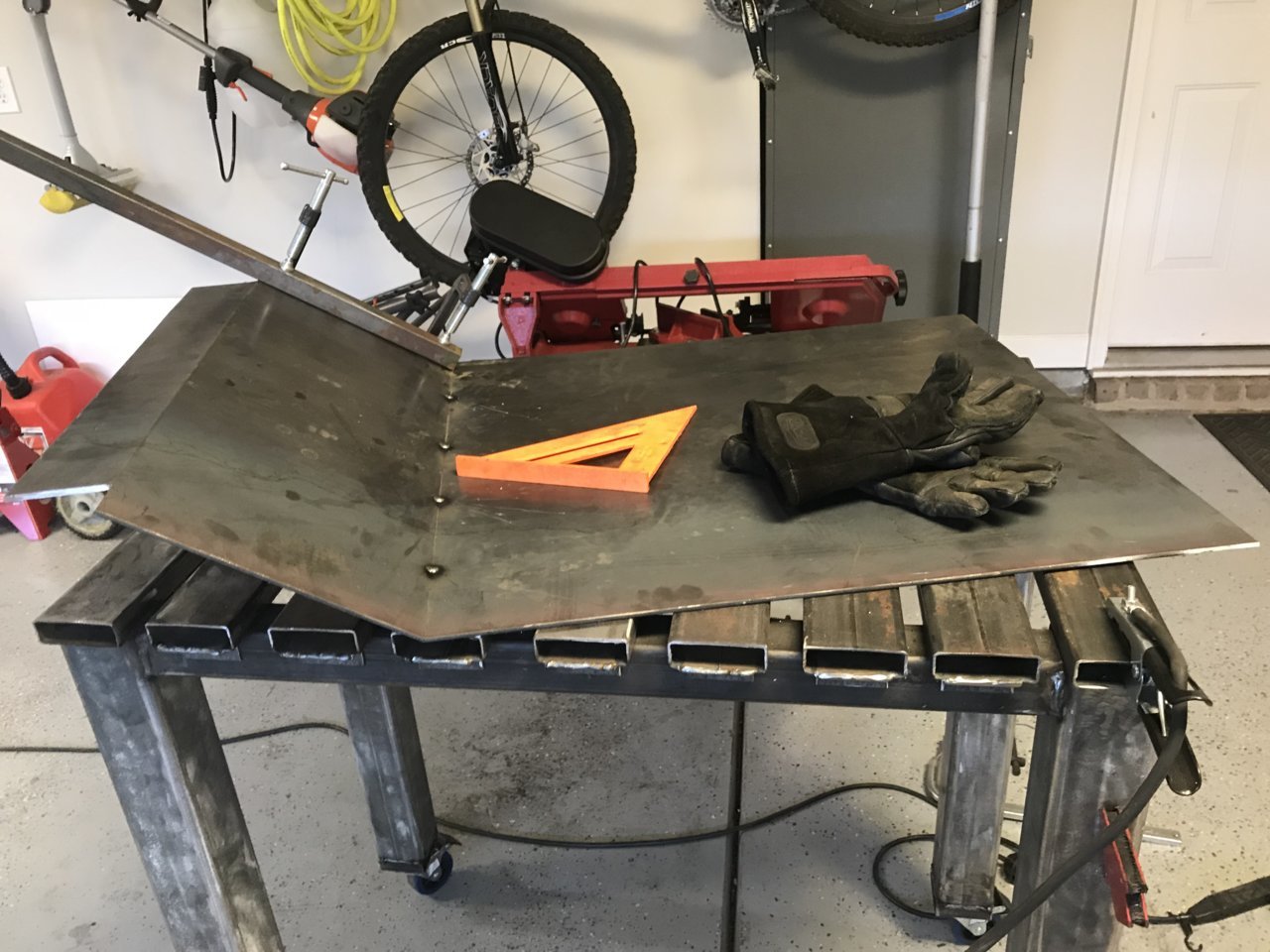

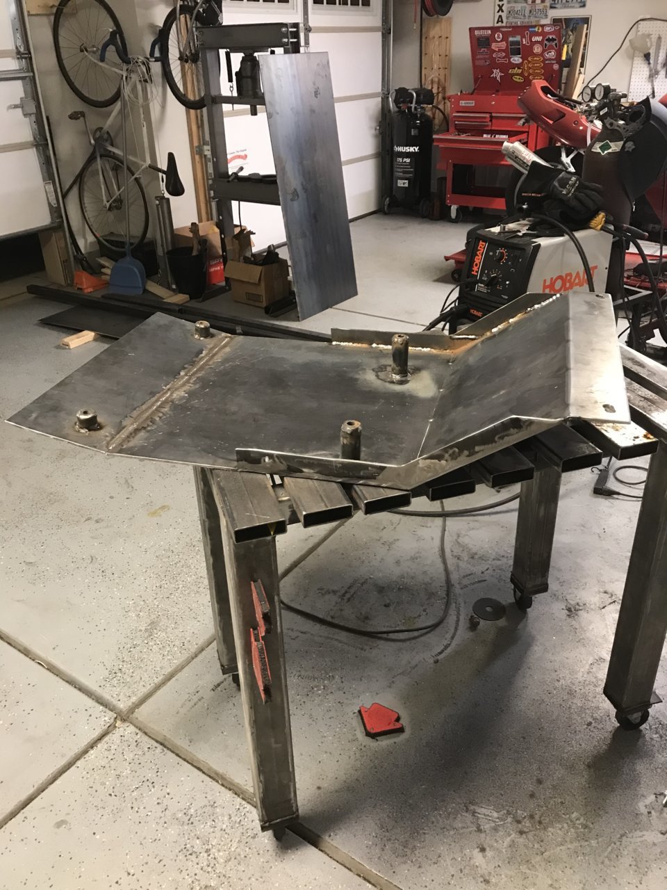

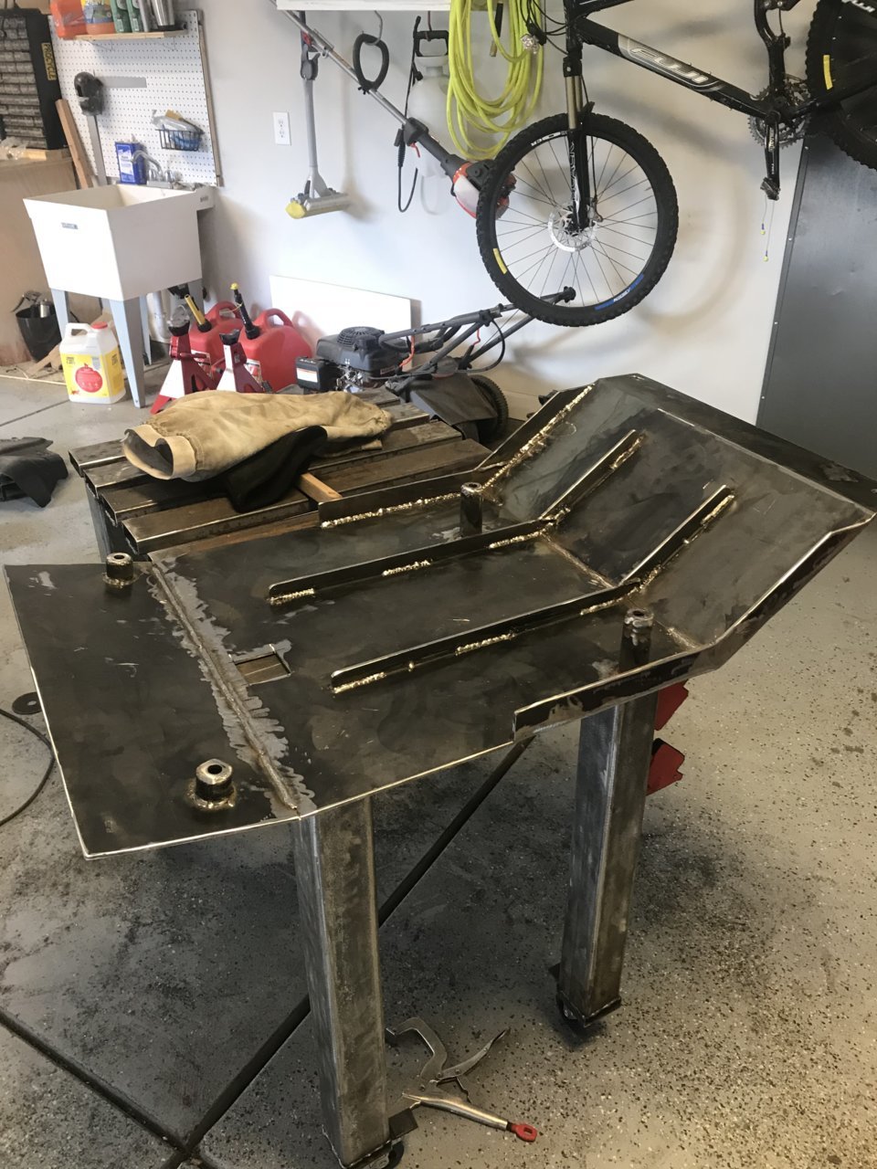

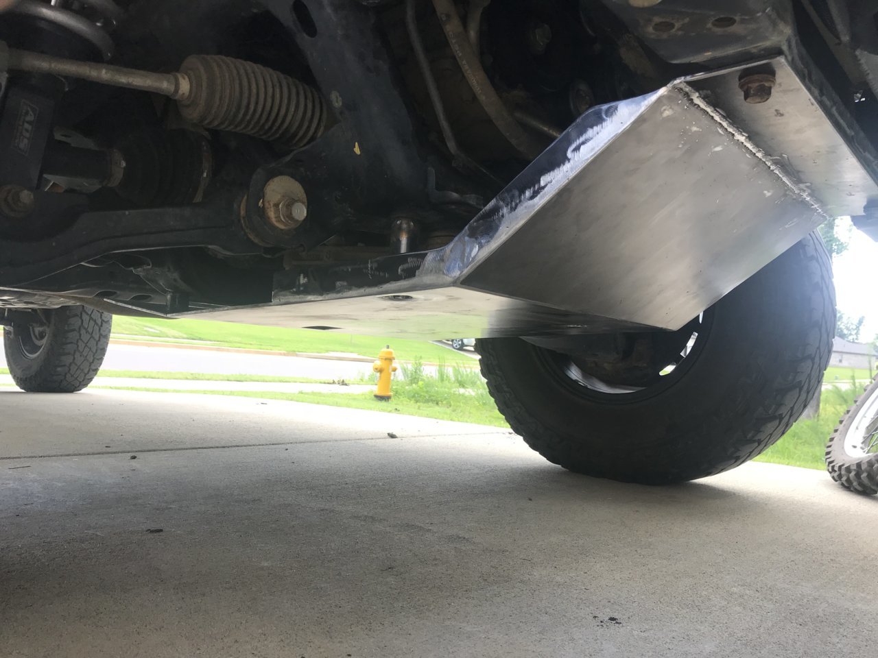

    Got the IFS skid done today sans the paint. Will be starting work on the transmission skid tomorrow. Everything fits as it should on the truck and I’m overall happy with the final product. AC22B64E-E789-435C-908B-A0AC502A9BCF.jpgD91DD822-9D55-4A40-B612-E30AA71756B4.jpg10051123-E3E5-4721-A1F7-2257709652D3.jpg5B22EBB6-5B45-4307-BE4A-BB46F3DFFA9C.jpg

    Are those whiskey bends or separate pieces?

    The 3 main bends are whiskey bends. All the supporting perpendicular pieces are separate, welded to the main plate.
