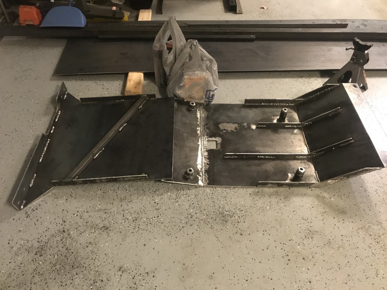

    **Armor** Home Fabbed Hybrid Front Bumper Home Fabbed Rock Sliders Home Fabbed IFS Skid Plate Home Fabbed Mid Skid Plate Home Fabbed Transfer Case Skid Home Fabbed High Clearance Rear Bumper **Suspension** ADS Front Coilovers (Extended Travel, 700lb coils, Remote Resi) Total Chaos UCAs Chevy 63 Swap w/ custom shock hoops 14" Bilstein 7100s **Wheels/ Tires** Spidertrax 1.25" Wheel Spacers Front/Rear TRD Rock Warrior Wheels 285/75/16 BFG KO2s **Electrical** Pelfreybilt Auxiliary Fuse/Relay Panel Blue Sea Fuse Box Bussman 100 AMP Breaker **Recovery** Smittybilt 9.5k Winch **Lights** 20 Inch Single Row LED Bar Rigid Side Shooters (Flood/Pair) w/ CBI Offroad Ditch Light Brackets Rigid Duallys, Amber for fog lights **Miscelaneous Mods** Rear Diff Breather Relocation RAM Mount A-Pillar Mod w/ Garmin Power Cable DRT Fabrication Cab Mount Relocation Pinch Weld Mod (Mini Sledge Special) Short Rise Bed Bar for Tire Storage/ Hi-Lift Mount
    Here's a semi up to date picture of my skids. Built the transmission skid much faster than the IFS skid. In addition to the current crossmember on the transmission skid, I add another that forms an X. I also match drilled two holes to bolt the IFS and transmission skid together using Grade 8 bolts.IMG_1571.jpg

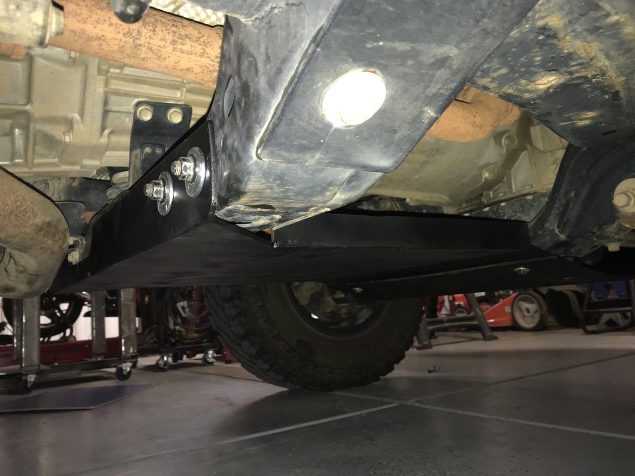

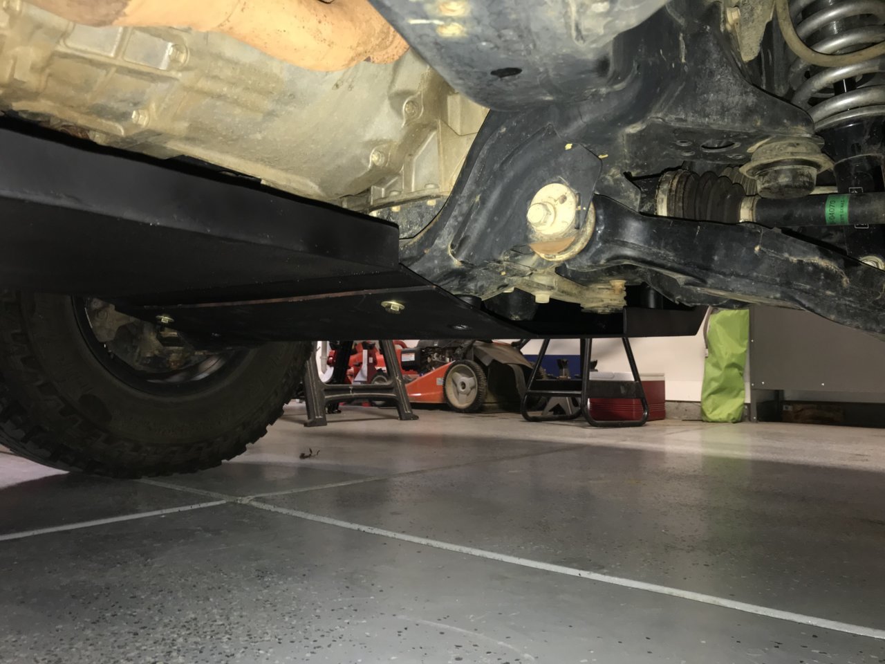

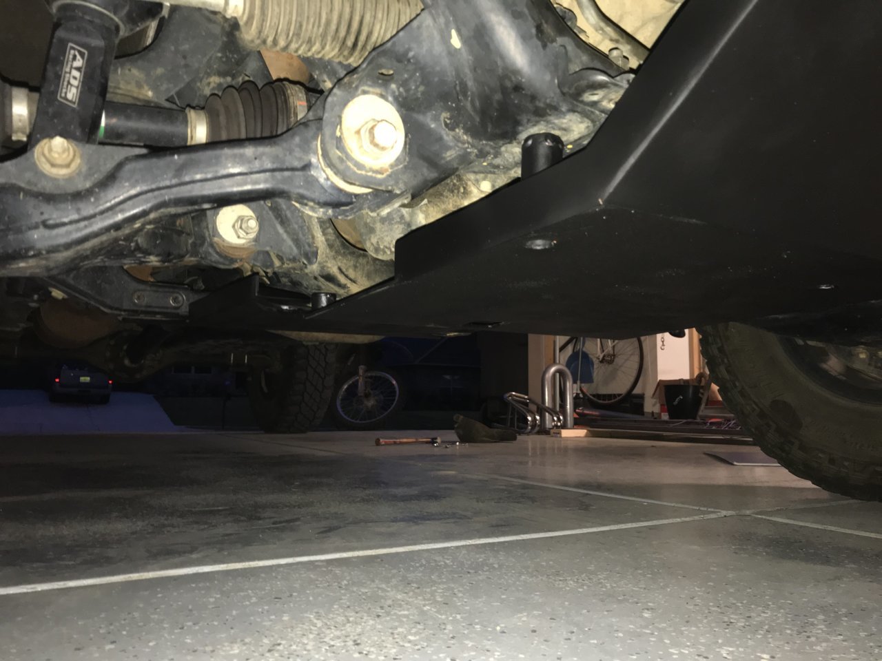

    Kinda hard to see because of the black paint but here is my final product for my IFS and mid skids painted and installed.
    10A94B98-9D90-4DFD-B692-B01EF6E8A71E.jpg 30C3EB65-517B-4541-A987-301E33EE7A97.jpg F02AFE19-85D9-4DC9-BA3A-BB3EBF760F0E.jpg

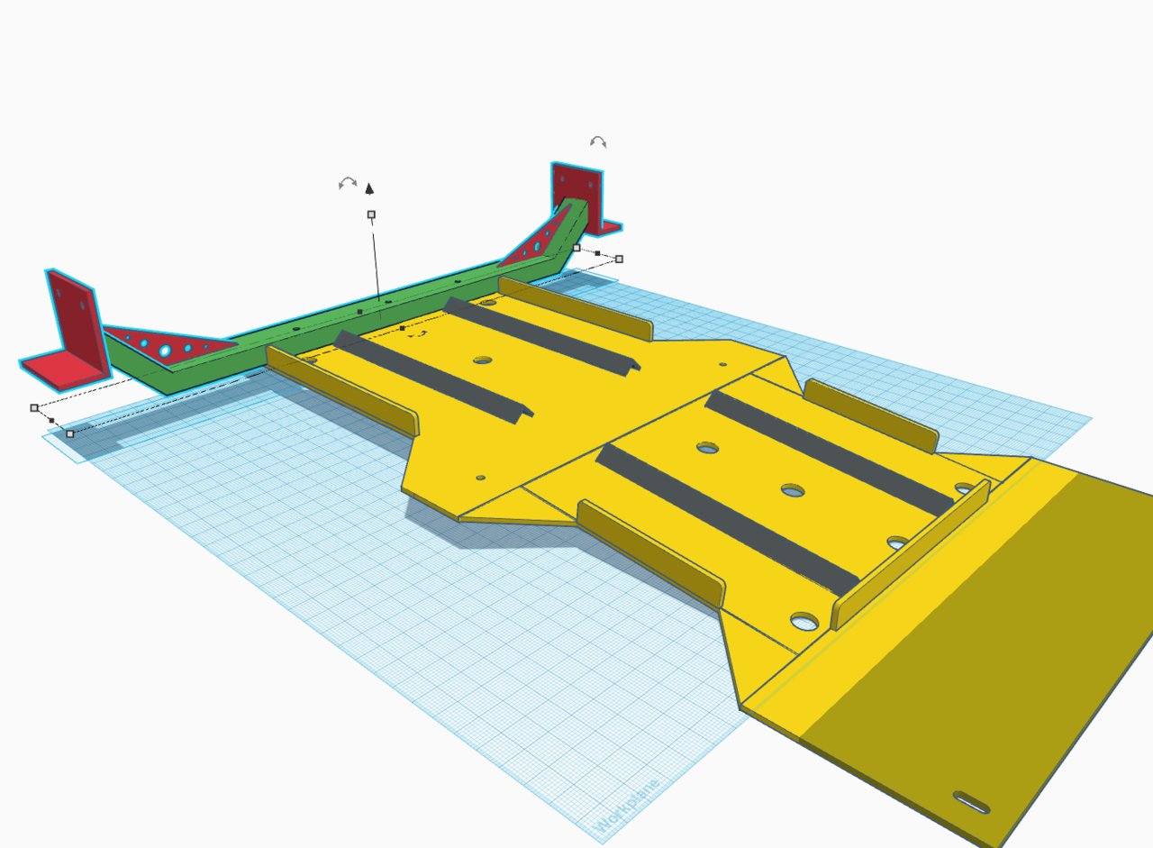

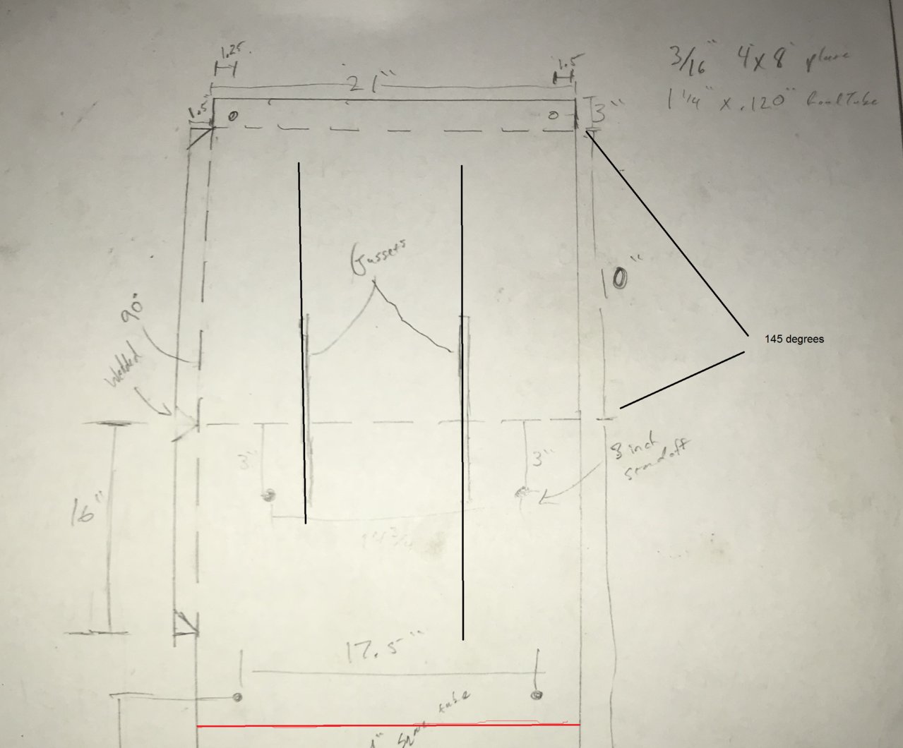

    So here are the plans I initially drew up for my skids. Was going to build a one piece skid from front to the transmission cross member however that proved to be too heavy to manage as a single person mounting it to my truck during various test fits. Some of the measurements were left out due to the test fits being the driving factor for where certain things were places and where holes needed to be drilled. Some measurements are also not 100% accurate since test fits made me change things after drawing these plans up. If you have any questions feel free to ask. This drawing is far from what I produce professionally and is lacking quite a bit so don't criticize too much. Lol.
    Slashaar likes this.

    I'd be interested in the CAD drawing as well. Skids are my next project. The more I look at my undercarriage, the more I cringe at my exposed trany pan.
    @Jerneyman
    @2BeersPlease
    A stupid question, though, it looks like your designs generally mount to the lower OEM bumper support, is that right? How would you expect this to work with an aftermarket bumper? I'm looking at doing a NWTrailInnovations DIY front bumper and it's not real clear how they mount up.
    Maybe I just need to do the trany skid for now, then when I finish a bumper, mount the IFS skid to it...

    Most Aftermarket bumpers tie into the OEM skid bolt locations.

    ahh, gotcha.
    Sounds like I need to just go for the trany skid, then worry about the IFS skid when I build the bumper.
    Thanks!

    Thank you. Do you recall the total length you ended up with?

    No problem. I’ll have to measure that. When I decided to keep it as two separate sections I measured, marked and forgot. Lol. I’ll measure it out for you tomorrow.

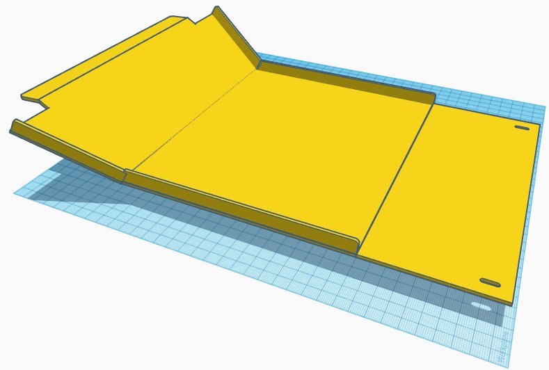

    Needs some tweaking as measurements are mostly close guesses when I changed it from the previous version. Once I get measurements closer I will link a downloadable version.
