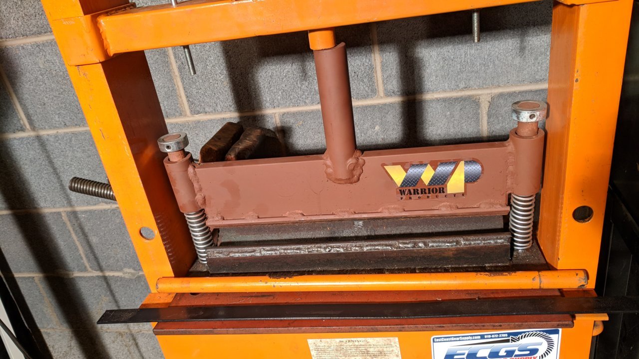

    Built this a few years back and it is awsome. Used it many more times than I ever thought I would. Only wish my press was bigger so I could have built a wider break. Will probably use whiskey break method and weld due to length of bends.

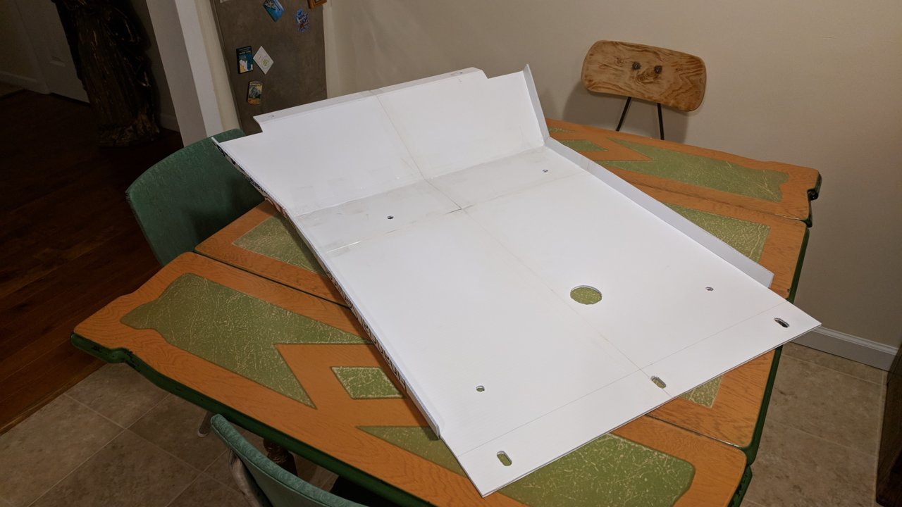

    Progress
    Printing real size and double checking hole alignments
    This is a flat sheet "cutting template" no bends yet.

    Is the rear portion also a 145 deg bend?

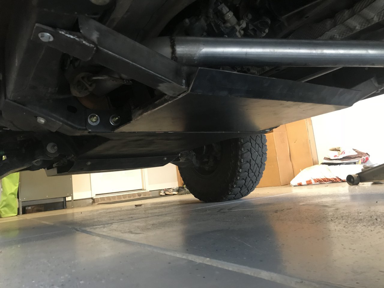

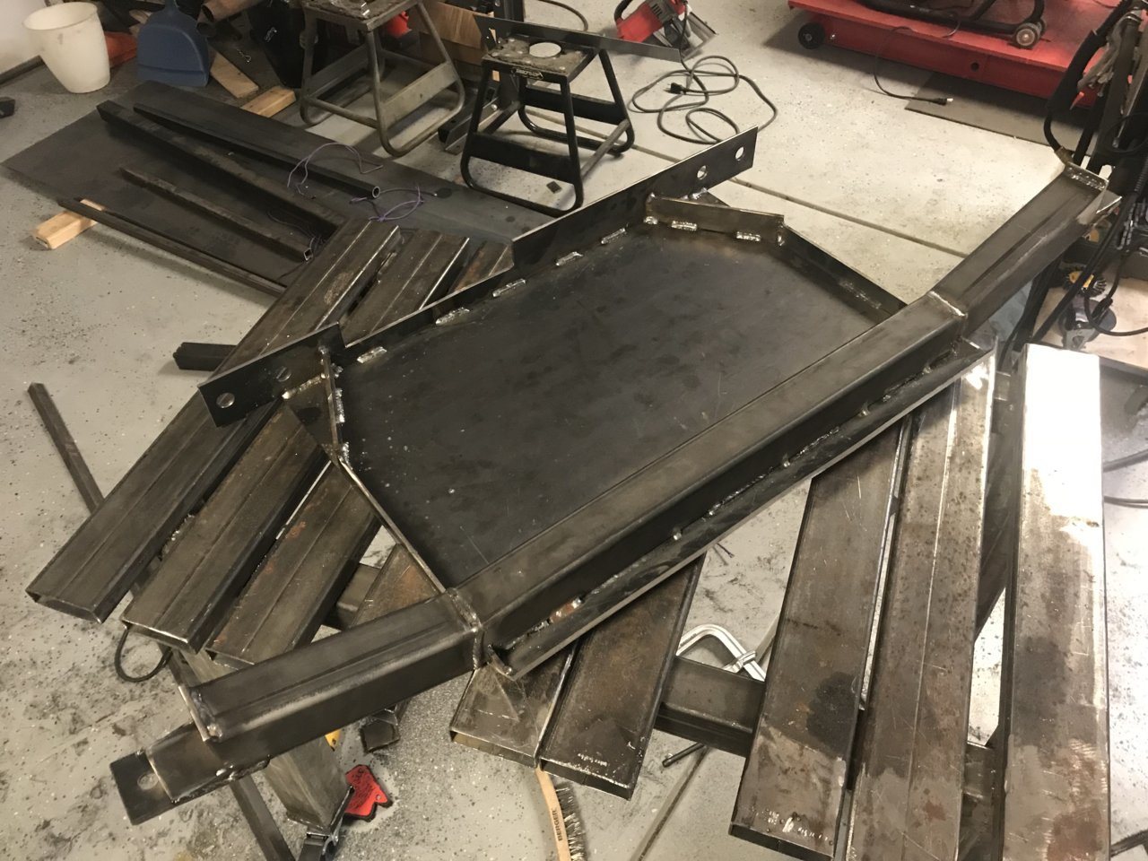

    Got my transfer case skid bolted up for the final test fit before paint. Everything looks solid.
    This is a few days before completion.

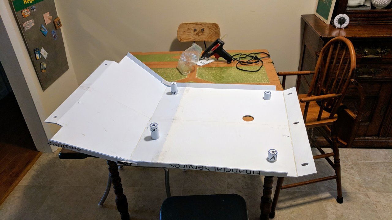

    Not sure yet going to test fit first and see what that angle needs to be.
    I am hopeful I can tomorrow if weather and work cooperate.
    Mock corrugated plastic sign skid assembled. Might be better than stock skids that are beat to crap.

    Test fit looks like the angled piece at the front of the truck needs to be closer to 11" long not the 9" in my original plan. Bolt holes seem to match up good. Not sure if I will have to adjust bolt holes any after changing the front angle. Probably won't have time to work on it anymore this week work just got real....

    Well got a few minutes to work on this today. Hopefully 3rd times a charm.....and hot glue guns work way better than tape...FYI.
