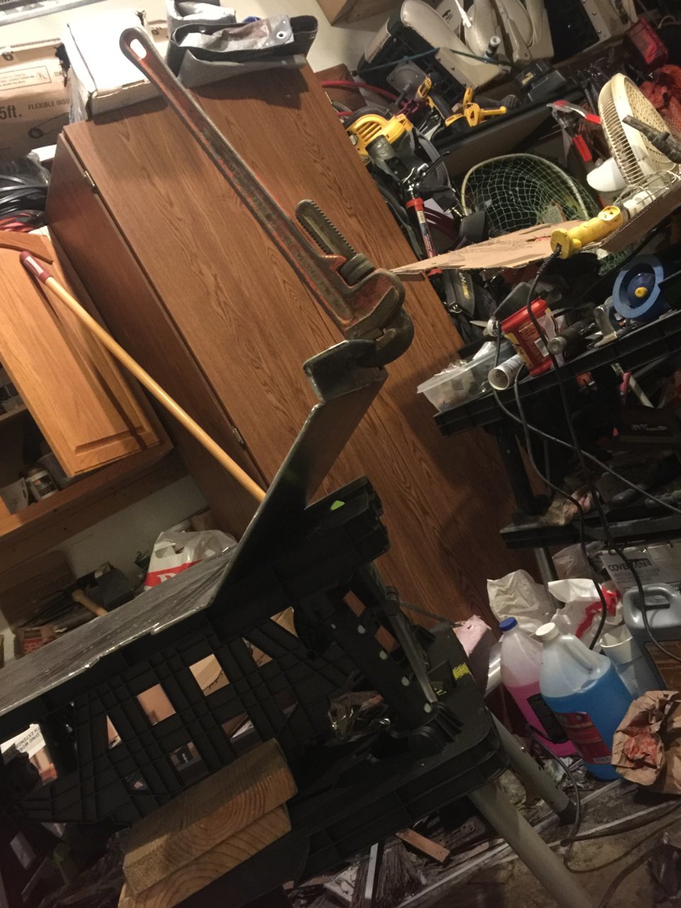

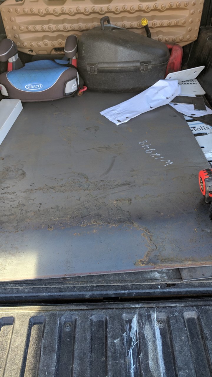

    Went to get a sheet of metal to make a skid I didn’t know there was so many choices for metal hot rolled cold rolled ect. ect. What are type of metal are you guys using?

    I bought Hot Rolled Steel Plate/Sheet A36

    Yup, hot rolled A36 plate is what you're looking for. There are lots of options, but that's the norm.

    Cool I got the right one then thanks

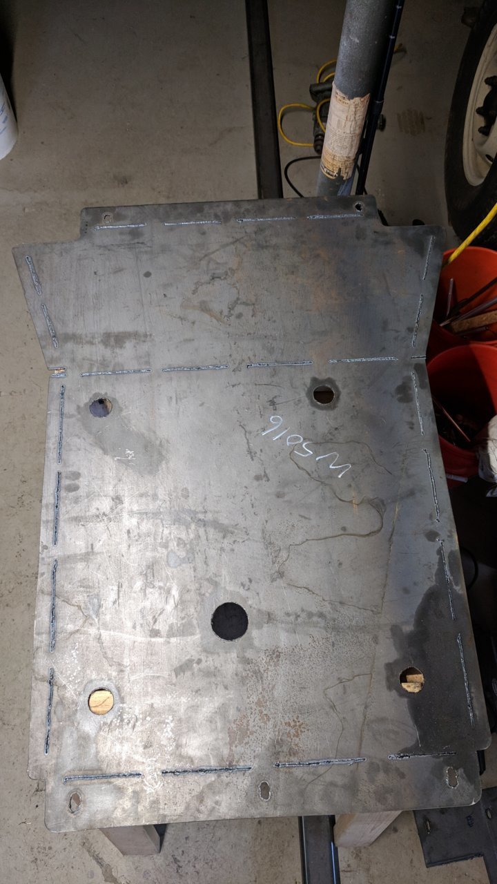

    Things are coming together. Finished plasma cutting front skid. Pick up steel today for mid and rear skids.

  17. Jan 31, 2019 at 4:06 AM
    #297
    03_taco_IN
    03_taco_IN Well-Known Member
    Sep 29, 2018
    #267850
    209
    Indiana
    2003 xtracab sr5 v6 trd
    Blue wire/ grey wire/rear diff breather mod/881s w/bilistein
    How’d the bends come out perforated with the plasma like that. I’m trying the whiskey bend on a 1/4 in and it’s kinda tough to say the least lol
    Slashaar likes this.

    Haven't bent the steel yet. Work six 17 hour days in the last week. Maybe tonight and tomorrow night I will be able to work on it.
    First impressions I think it is going to be easier than I thought. Will update soon.

  20. Jan 31, 2019 at 2:24 PM
    #300
    03_taco_IN
    Sep 29, 2018
    #267850
    209
    Indiana
    1/4” is for the front skid. I’ve seen people use both 3/16” or 1/4” so I opted for the thicker. I only want to make it once. It was challenging but I got it done only cutting a little over half way thru, or that’s what I was aiming for some of my cut was a little deeper. Then out came bessy lol a big 24” pipe wrench for leverage
