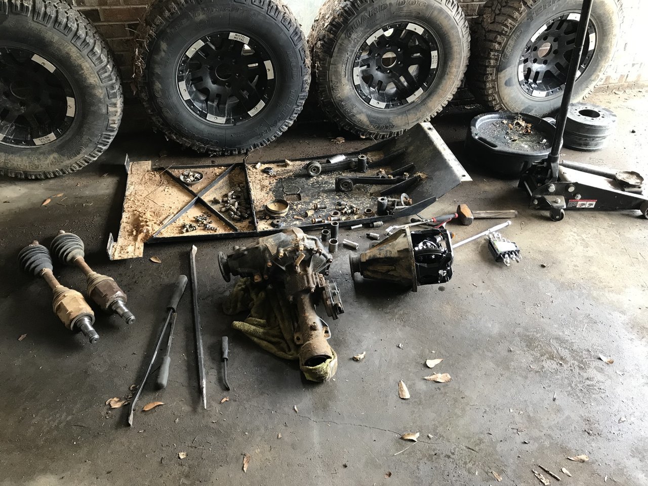

    #330
    mynewtoy
    mynewtoy I like men
    Apr 16, 2011
    #55023
    2,559
    greg
    Mississippi
    09 double cab 4x4
    Detriot locker rear ARB air locker front 4.56 gears OME 3" lift, SPC uca's , moto metal 951 wheels 315/75/r16 Treadwright guard dogs, homemade front plate bumper with smittybilt 9.5k winch, homemade skids, homemade Bed bars, Mobtown offroad high clearance rear bumper with tire carrier, Homemade rock sliders , U-bolt flip, Wheeler's super bumps, BORA 1" wheel spacers , Black headlight mod , black tail lights, Satoshi Grill , autoPage C3 RS-665 alarm with remote start, flowmaster 40 series exhaust, cruise control,bed/ground effect lights, wet okole seat covers, tinted,windows, weather tech floor mats, AVS vent shades, debadged, hidden cobra 19 cb, 7" offroad lights behind grill, rear diff breather relocate, abs kill switch
    Mine is a 2nd gen so it's a little different but here is what I did. Yes the back is full of mud
    Slashaar likes this.
