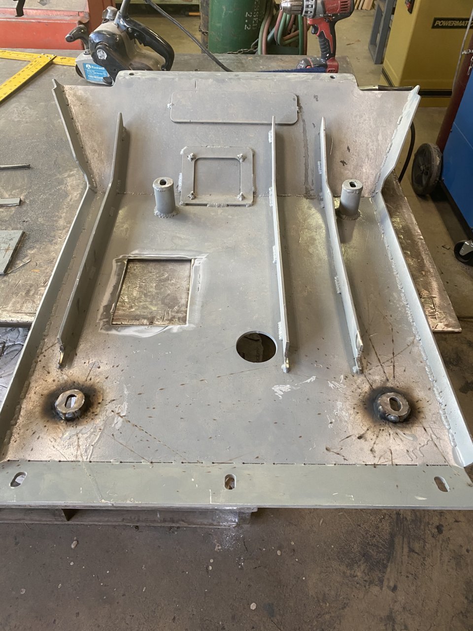

    UPDATE 11/16/20
    After putting this thing through the ringer, I decided to change it up a little. I made the rear mounts shorter and cut out a diff bump out. I did this for a couple reasons.
    1) I did not like the slope of the skid plate. With 2.5 and 1.25 offsets for the risers you clear the diff well but end up with 9.75” of ground clearance in the front and 8.3” of clearance in the back. I was not a fan of the skid sloping.
    2) increased clearance, while yes the bump out will be lower, I decided I’d rather have more clearance in more area with one small drop than the whole skid be 1.5 inches lower all around.
    I think the thing to do would be to increase the front riser heigh to match the angle and make the whole skid level, but then you would have less clearance all around. Or cut out a drop under the diff, which is what I decided on.
    New Standoff measurement: front 2.5 rear .5. Now I have 9.75 of clearance in the front and 9.25 in the back of the skid, much better than before.
    I will update the CAD file when I get a chance with the trap door cut out. Also had to cut the bent up sides slightly under the LCA to fit.

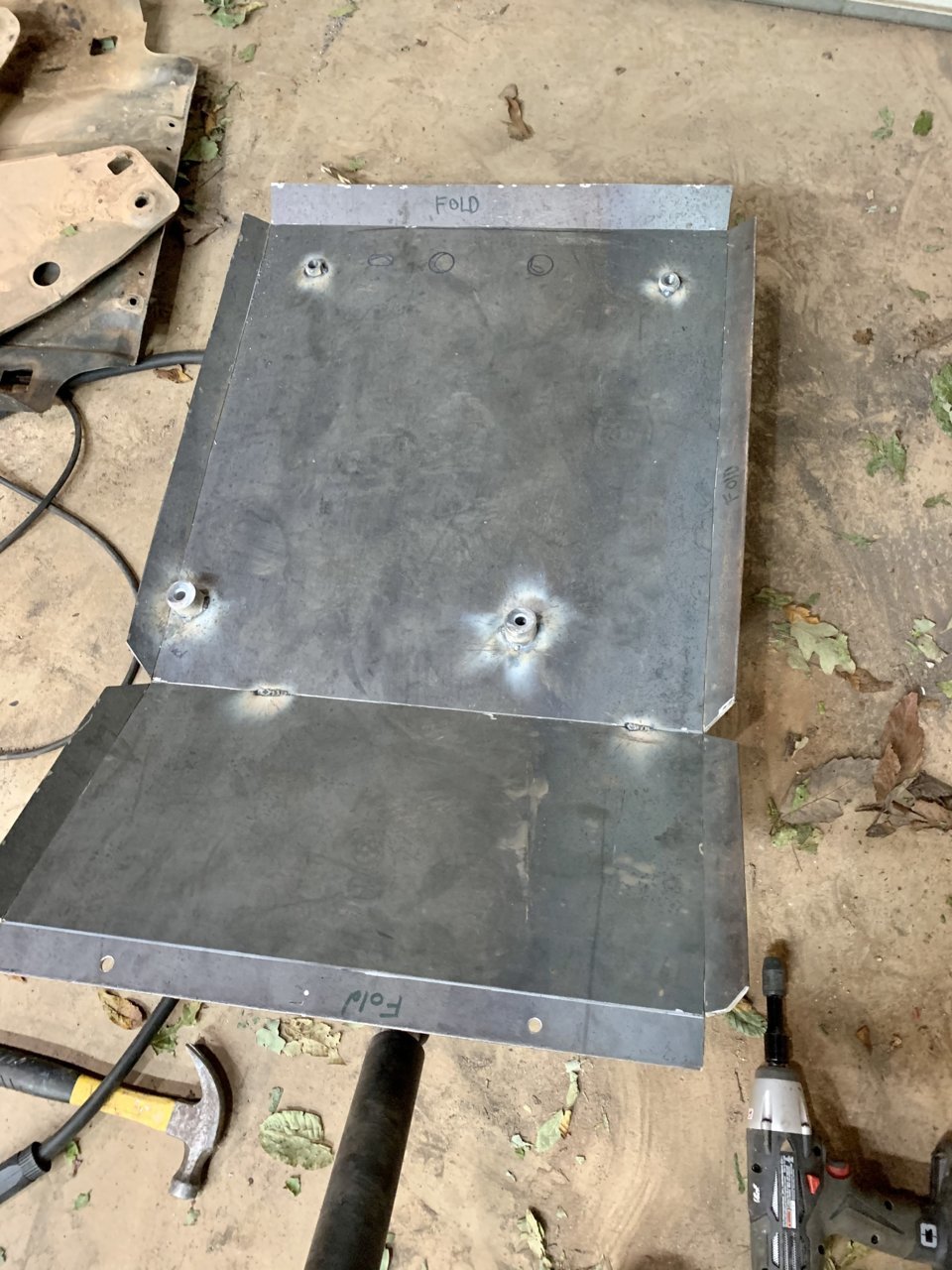

    Cut the sides and top plate for the diff drop section. Updated the dwg file.
    Mock up is upside down to see if it fit.

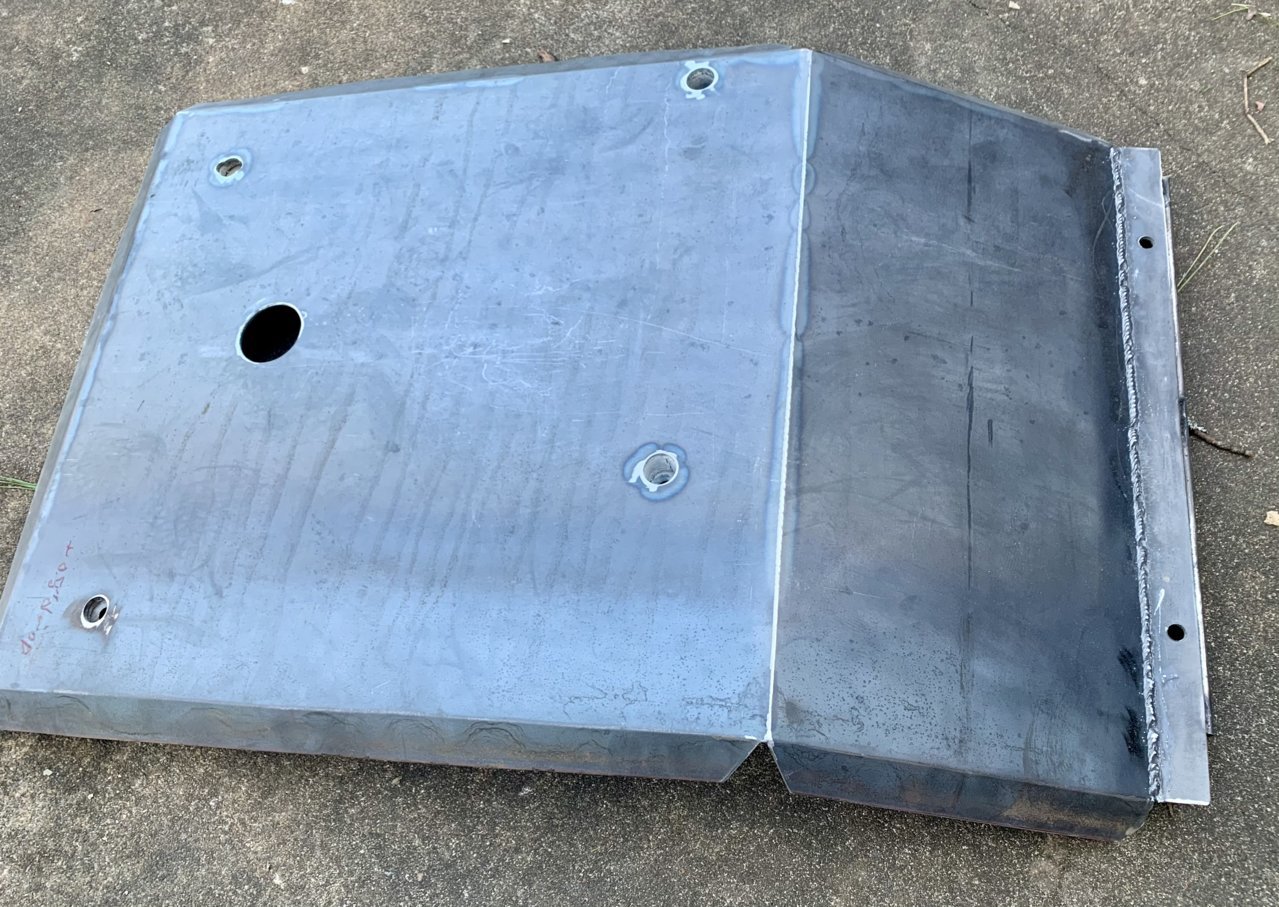

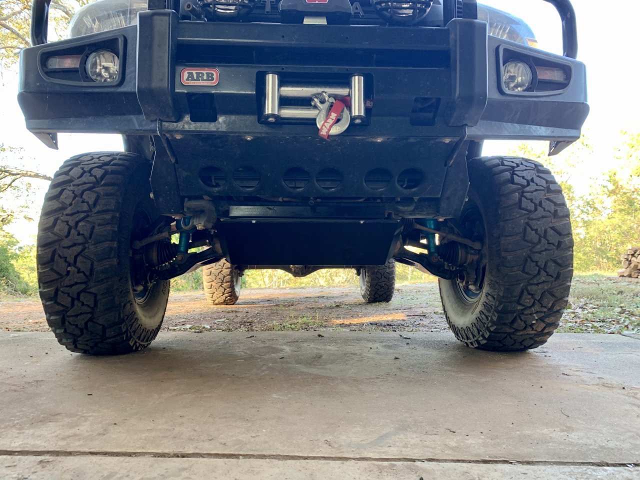

    Here are my basic skids. Pretty much just stared at the all pro until my hands made it. First time making something with bends like this. Need to make the rest of the skids.C146F46C-830C-4368-867D-4E0B697041E9.jpg6F2091F6-EB04-44F7-B763-4413CFB994E4.jpg
