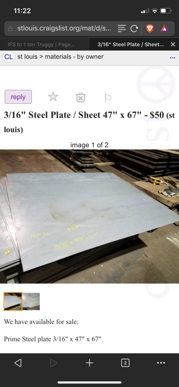

    I would check Craigslist or marketplace for steel plate as well. Found this in the spring and I think I figured it was enough for me to build a gas tank skid and two rear skids (first gen) as I already have a IFS skid, but I decided I didn’t want to mess with it.8D3739E2-6E7C-40FC-B774-EB25D423F76E.jpg

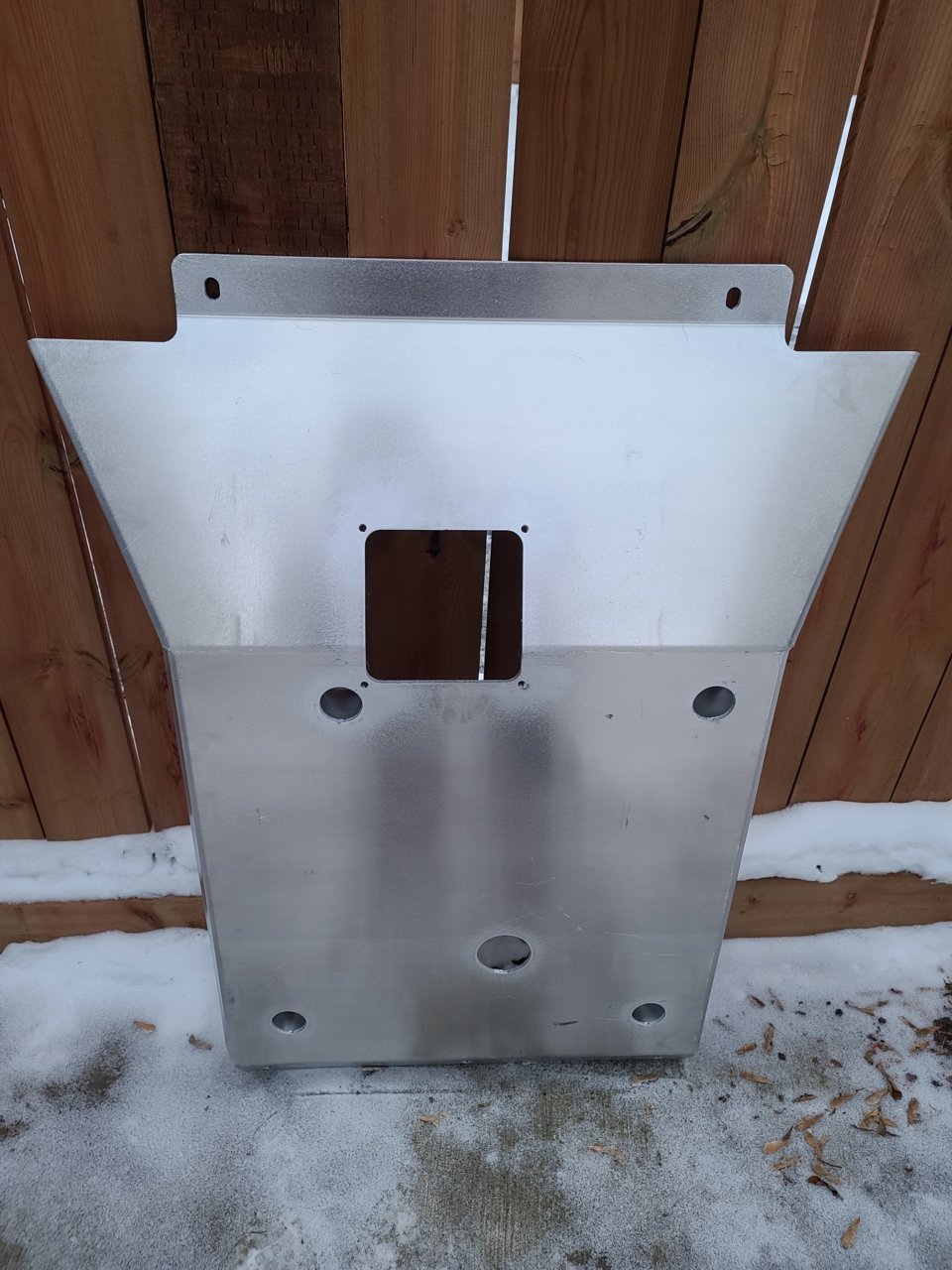

    JDUB-Fabrication helped me out with this thing. Kudos to whoever posted the original file and to JDUB for his skill and effort. Now I’m ready for the mall.
