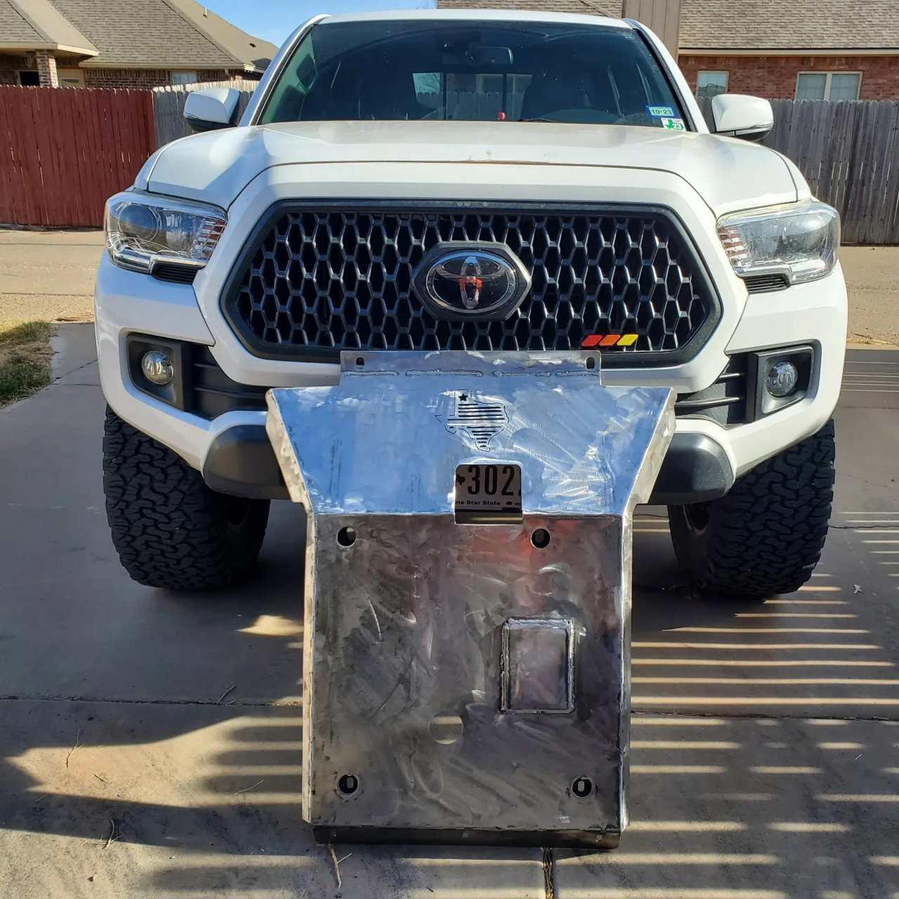

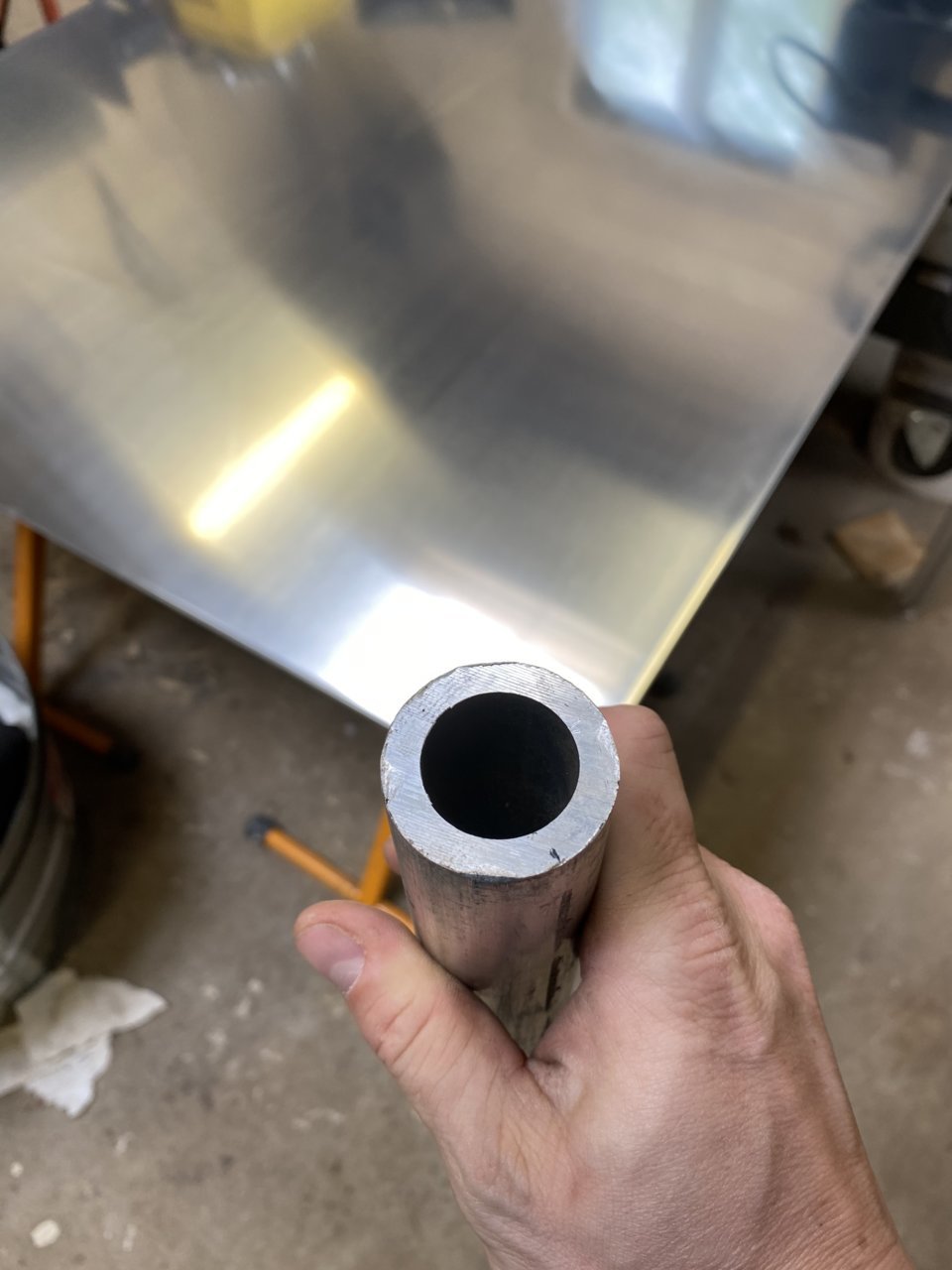

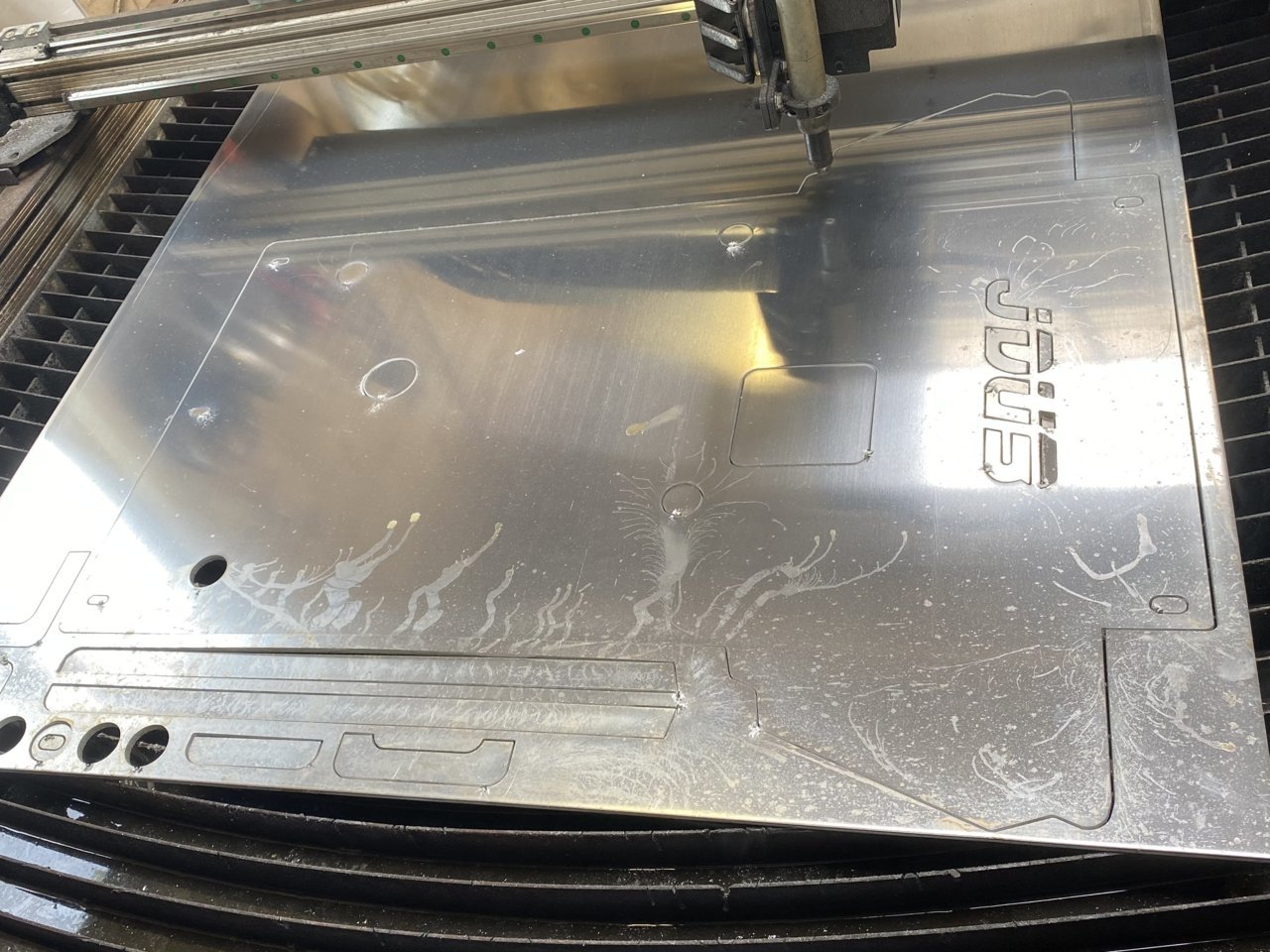

  8. May 3, 2021 at 2:44 PM
    #508
    JDUB-Fabrication
    JDUB-Fabrication Well-Known Member
    Aug 11, 2019
    #301850
    652
    Newburgh NY
    2010 Lexus GX460

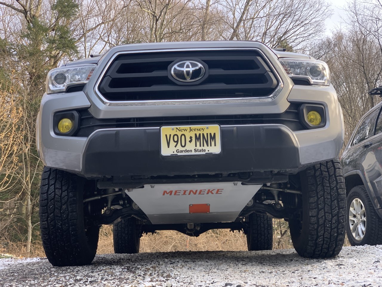

    Decided to try out a .25” aluminum version for my truck. Planning on a little more internal support than the steel.
    Got some 1.5” OD .25” wall tubing scrap for the uprights. A bit thicc but will be strong! Stay tuned for how it handles off-road.

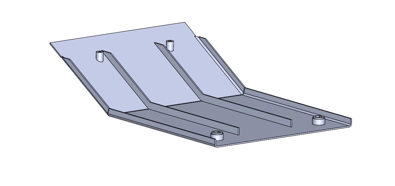

  9. Jul 19, 2021 at 7:56 AM
    #509
    JWags81
    JWags81 Well-Known Member
    May 6, 2020
    #326980
    144
    Iowa
    2017 Tacoma SR DCSB
    I got some CAD from JDUB a while back (thanks JDUB!) and decided I would try and make my own version.
    First off, I don't plan on banging this thing off of rocks and tree stumps.
    It will be more of a lightweight skid that is easy to remove when needing to do maintenance.
    I also want the skid to cover most, if not all of the front cross member. Kind of like the OEM Pro skid plate.
    Anyways, a lot more measuring and designing to do, but here is the start.

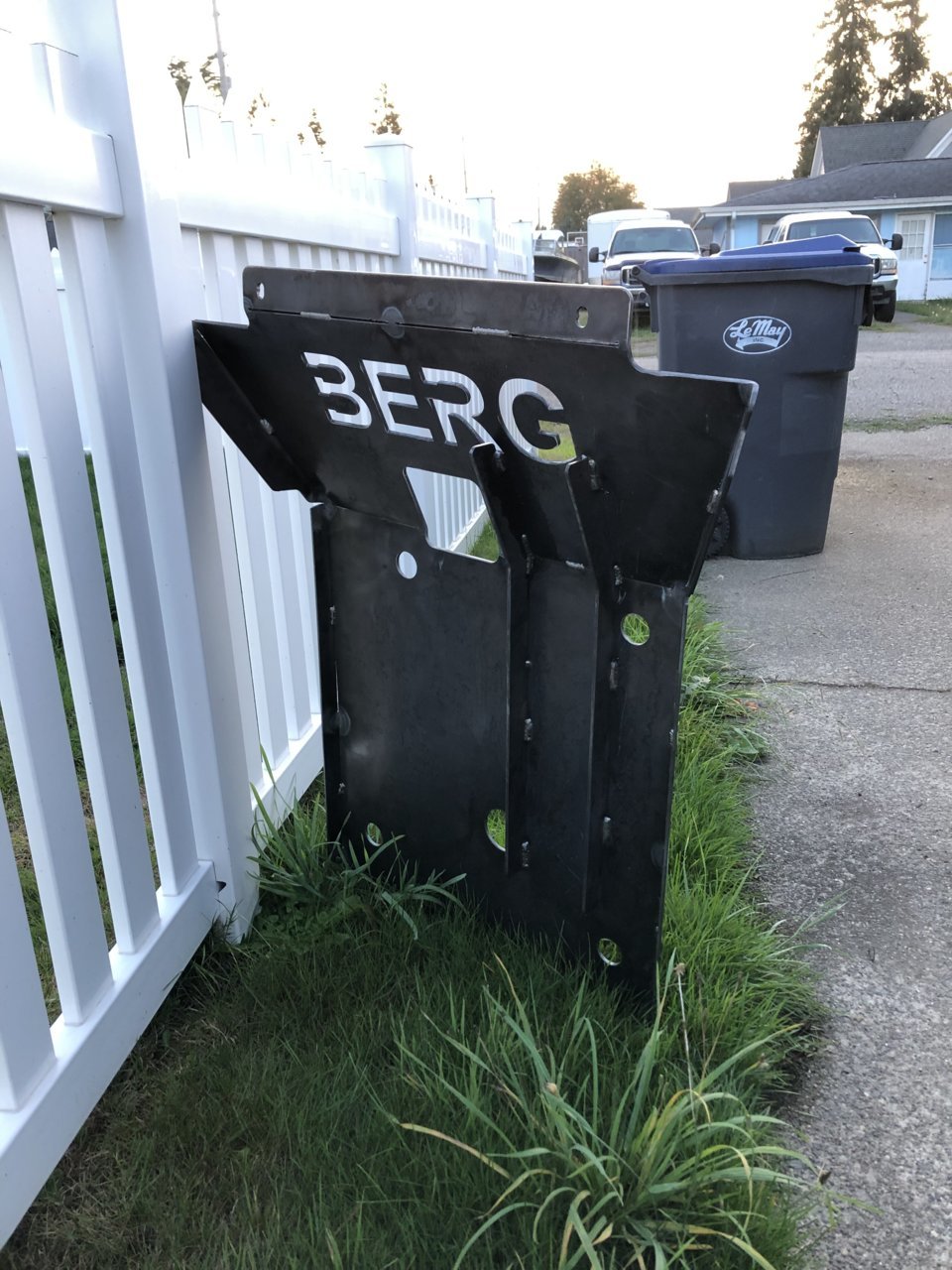

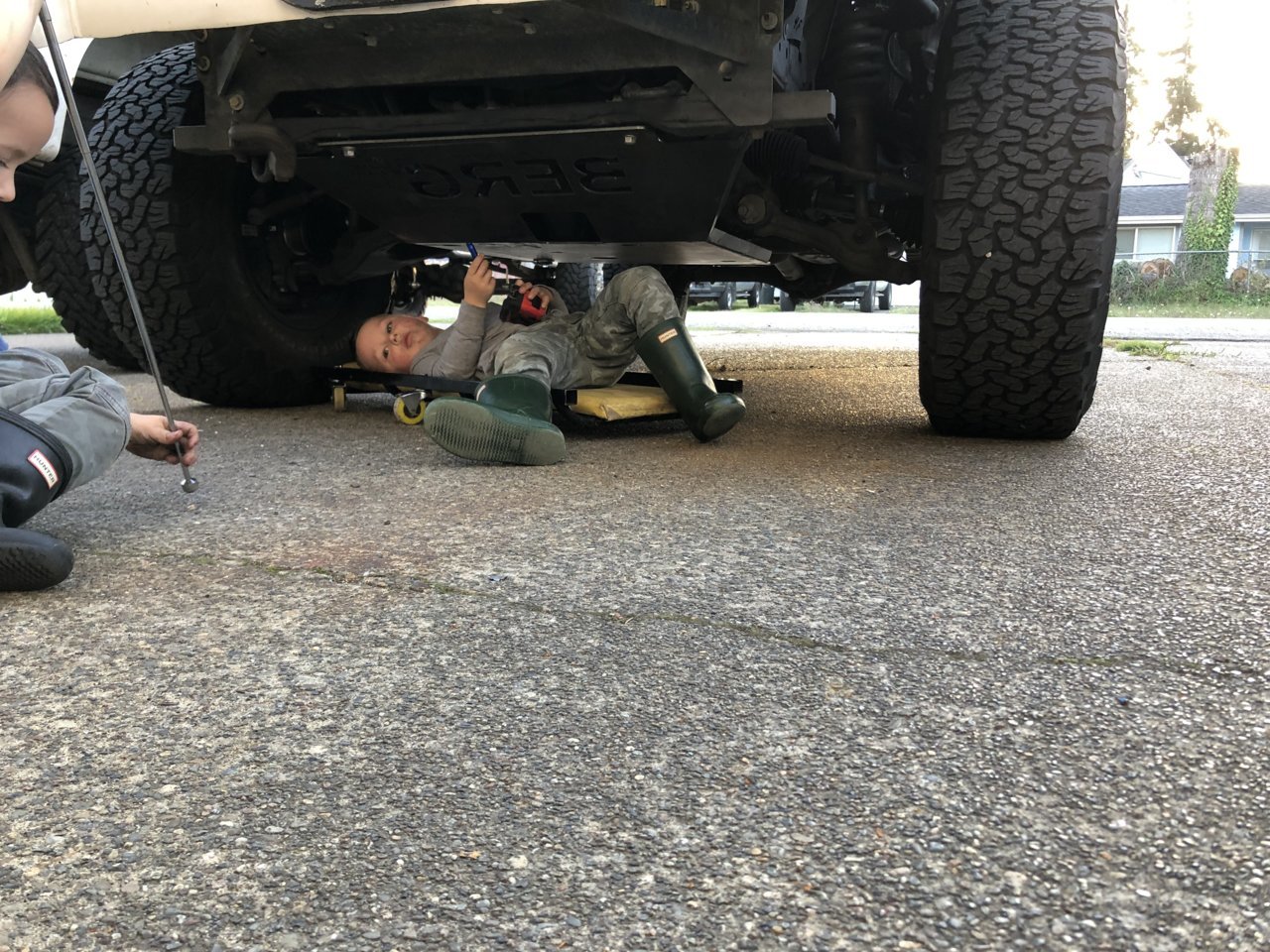

  11. Oct 1, 2021 at 9:43 PM
    #511
    berg1991
    berg1991 New Member
    Jun 29, 2016
    #190907
    Justin
    Washington State
    2010 Toyota Tacoma TRD DCSB
    Absolutely huge thanks to JDUB!
    Just got the file. Turned out awesome, will make some minor changes in the future but this works for now. I have no need for the square cut out up front but went with it anyway. Placed BERG reversed so you can read it like an Ambulance in the rear view mirror.. totally on purpose not cause it’s 200 dollar worth of 3/16 steel.

  13. Mar 24, 2022 at 11:01 AM
    #513
    zCheech
    zCheech Active Member
    Mar 30, 2021
    #361039
    36
    First, thank you for an amazing alteration to the files that were created for the 2nd gen. Your information and iterations are appreciated immensely. In the next week or so I am going to get started on the front skid.
    I just wanted to follow-up on the 1/4" aluminum and how it has held up? This is the option I am going to be going with.
    Thanks again!
  14. Mar 26, 2022 at 8:14 AM
    #514
    JDUB-Fabrication
    Aug 11, 2019
    #301850
    652
    Newburgh NY
    2010 Lexus GX460
    1/4 inch aluminum holds up well, but I find aluminum to be gummy over rocks, doesn’t slide like steel. Definitly lighter though.
