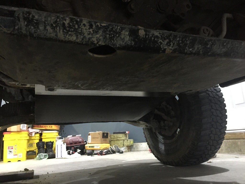

    North Idaho
    2011 DCSB trd sport
    Fox 2.5 extended travel, dakars, rear 5125 255/80/17 cooper maxx ST
    Finished up the IFS skid.

    I built all my skids, IFS 1/4", mid 1/4" and the transfer case skid was 3/16" but I bent it to where I blew a 2 inch hole in the exhaust, so I rebuilt it to 1/4" with braces, and its only kind bent after using it as a kickstand and pivot point a bunch. the guy who said 1/8" is plenty has no idea what he is talking about

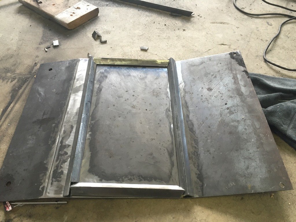

    Ok so I've been thinking about finally designing my tcase skid. What size square tube should I use for the crossmembers? I'm thinking of adding 2 crossmembers, one right before the case and one right after then filling it with 1/8" plate. I'm trying to make this as light as possible since my truck already struggles going over mountain passes above 6000ft. Think 1 1/4"square tube will work?
  15. May 8, 2016 at 10:19 PM
    #115
    SnowroxKT
    SnowroxKT Well-Known Member
    Dec 11, 2011
    #68604
    5,319
    Kyle
    Anchorage Alaska
    2008 TRD OR
    How thick of tube are you talking about? .25 wall would probably work, thinner than that and I'd have my doubts.

    Probably .120
  17. May 9, 2016 at 11:38 AM
    #117
    SnowroxKT
    Dec 11, 2011
    #68604
    5,319
    Kyle
    Anchorage Alaska
    2008 TRD OR
    If you are going to run two crossmembers (in close proximity to each other) then that should be sufficient

    Guess I never posted my finished trans skid here:
    Slashaar and deergetr like this.
  20. Jul 11, 2016 at 8:19 AM
    #120
    MatthewMay1
    MatthewMay1 I'm an amateur professional.
    Nov 21, 2011
    #67486
    11,102
    Matthew
    Lone Star Republic
    Supercharged '01 TRD
    What thickness?
