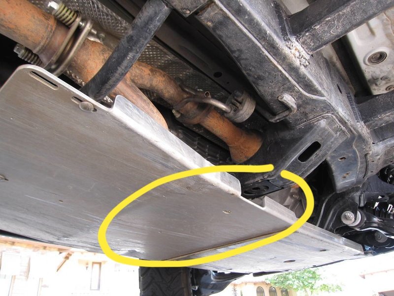

    First gen guys, how are you bolting the skids to the cross member?
    jjsul likes this.

    Ground down the flange and used the inner bolts with a piece of angle.
    20170407_201942 by Ryan Heintzelman - Flickr2BBcode
    jjsul and 2BeersPlease[QUOTED] like this.

    Should've known that was coming. I've seen them bolted from the bottom and from the side. Just wondering if drilling is required or are there factory holes.
  14. Jul 5, 2018 at 3:35 PM
    #174
    2BeersPlease
    2BeersPlease Well-Known Member
    Jan 22, 2017
    #208304
    5,234
    I was looking for a way to take advantage of those bolts when I was down there.

    I might do what @Reh5108 did.
    This is what I was referring to.
    bahndrvr, Reh5108 and jjsul[QUOTED] like this.
