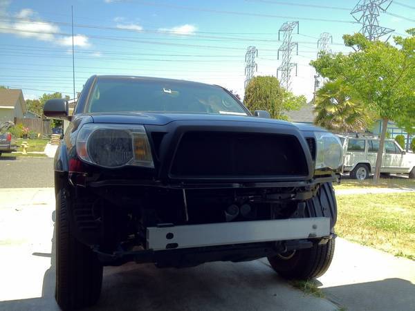

    Update:Finished a while back, but didn't have the time to upload the photos.
    Took apart the front assembly, but left the headlights(IF ANYONE NEEDS HELP JUST LET ME KNOW I DIDN'T SEE ANY HOW TOS ON THE FORUM)
    Taped up and cleaned
    Painted flat black.

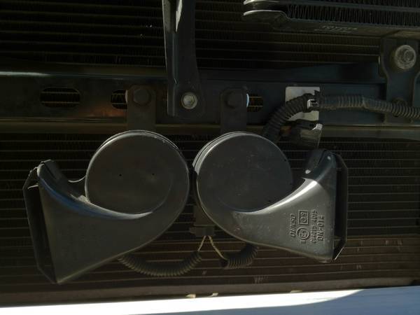

    Reloacted the horns to the center of the lower rad support, for some reason I don't have a heat sensor.
    Was left with this for about a day, looked pretty clean haha.
    Cut apart the bumper and began test fitting and sanding.
    Epoxyed the edges.
    Bondo and sand.
    Sanding and drilling holes for the mesh.
    Tape and sand. Did a wetsand somewhere there haha but the scrtaches are still deep so I will redo in the future but overal very smooth finish.
    Late night photos as usual. Took me less than 2 days to finish all this. Only took longer because I waited for the paint to cure. Very easy setup, faster than the satoshi itself. I'll have updated qulaity and clean photos soon.
