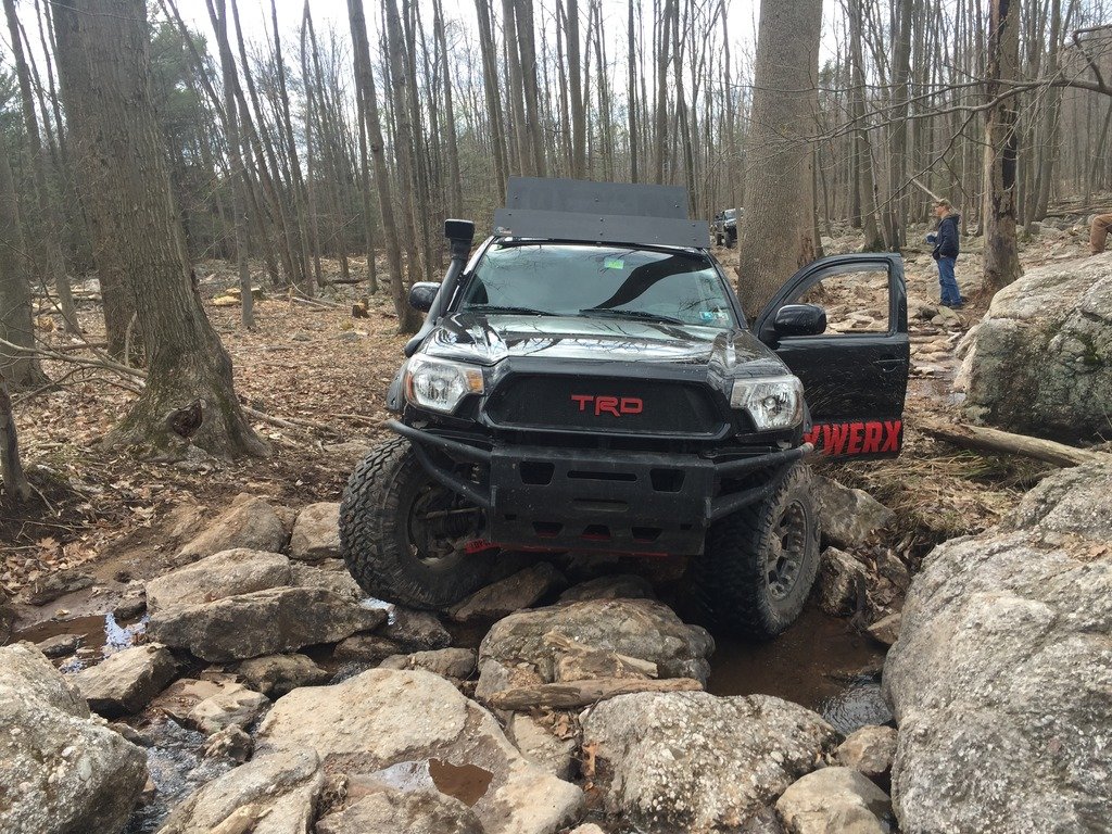

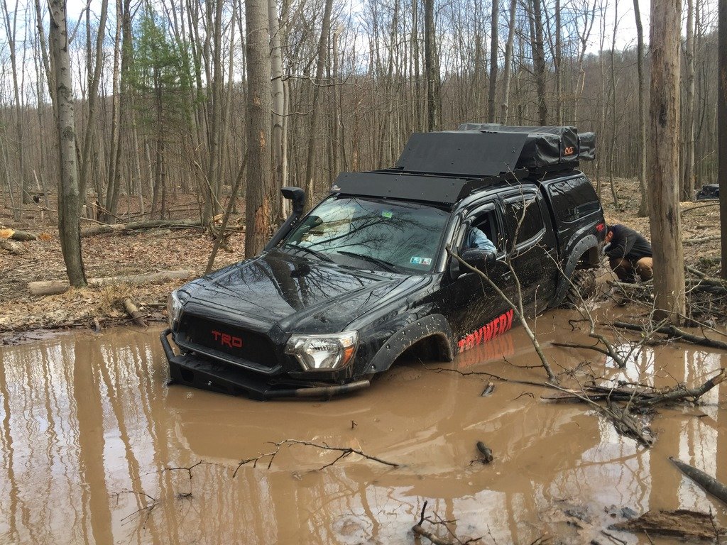

    So the SC trip never happened & I went to Rausch again with some local folks. Ant rearranged Yellowjacket Ridge with a quart or so of gear oil and I somehow messed up my rear diff.
    Things currently broke:
    1. Rear Diff (not sure - could be broken ARB locker)
    2. about 2 gallons of muddy water in drivers side floor pan
    3. LED taillight blown.
    4. Cruise control works only when it wants to which is hardly ever.
    5. No Subwoofer. something wrong with my ancient amp perhaps.
    6. inspection due this month.
    Truck currently sitting in shame on the side lawn. :oops:
