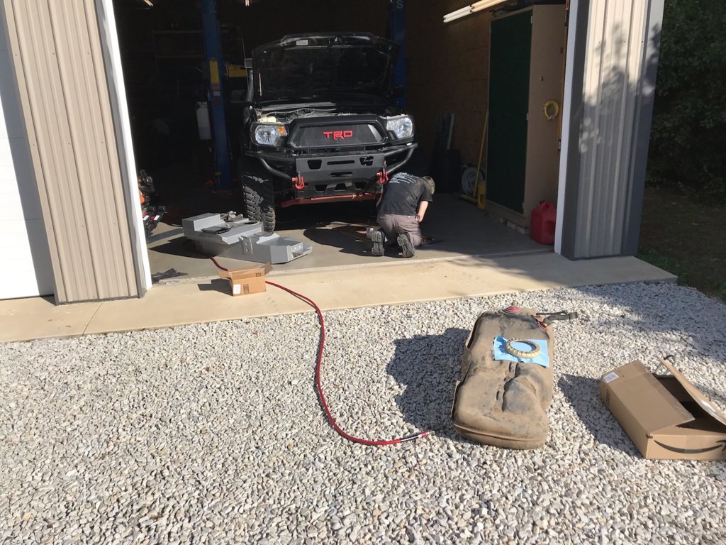

    So yesterday royally kicked my ass... :yawn:
    We got a pretty late start considering it’s an hour drive to Ants house and no one wanted to get up early on Sat.
    The kids kept busy playing with the cats & a new Super NES system I bought for them - they were very well behaved for once. :rolleyes:
    Our first move was to pull the Flippac- easier said than done due to the awkward weight. We just walked it off the truck and put it into Ants F350 bed temporarily.
    Looks smaller this way...

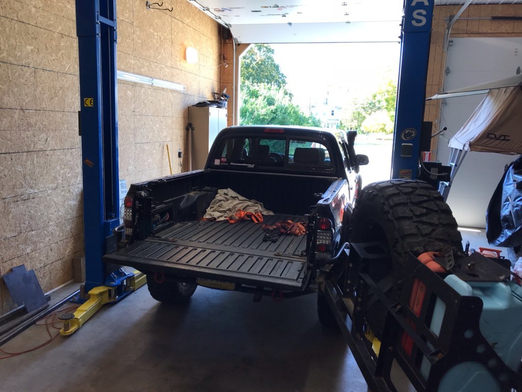

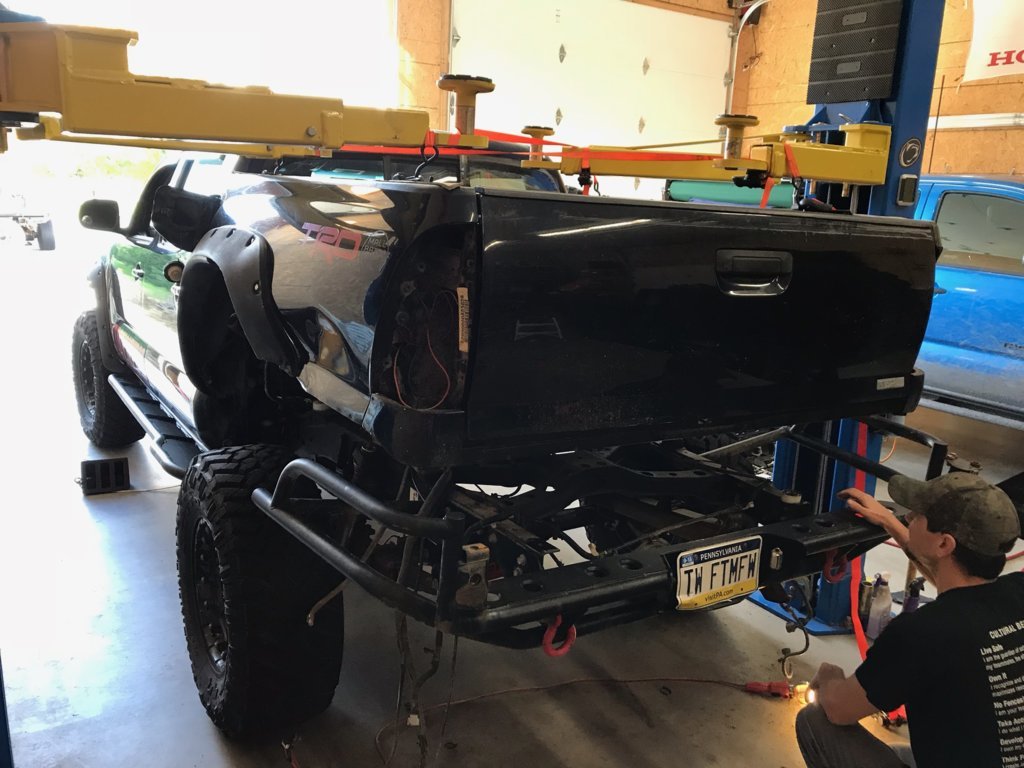

    Decided to back in to the lift and began disconnecting all the stuff for the bed. Unfortunately undoing my recently completed OBA wiring was also required.
    We strapped the bed to the lift with ratchet straps and carefully lifted it straight up.
    Pretty simple operation.

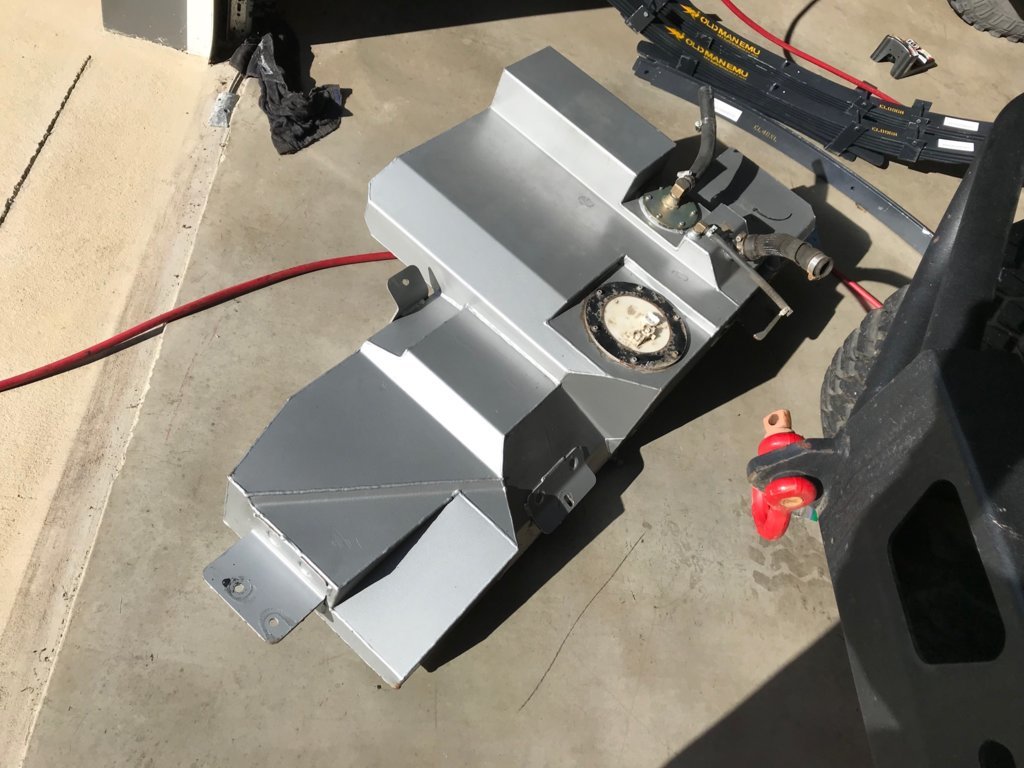

    Next we setup the lines for the new tank.

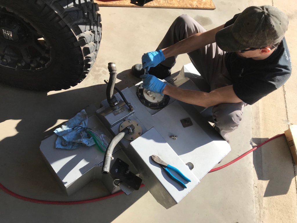

    Ant carefully installed the pump & float in the new tank.
    All set up ready to go.

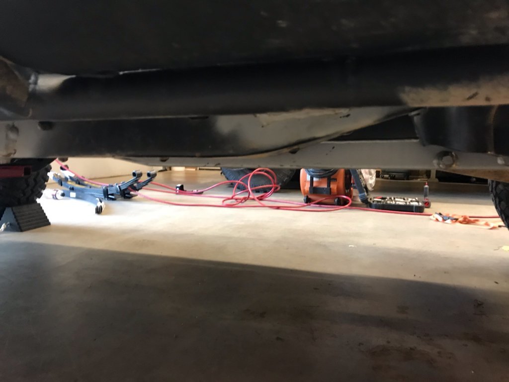

    Removal of the stock tank was pretty straightforward but getting this monstrosity back in the same spot was easier said than done. The LRA tank does not use the mounting straps the stock tank does, it bolts directly to the frame using a variety of brackets and off sized bolts...
    Two stock 14mm bolts for the drivers side, two 5/8” bolts with 11/16” nuts for the front cross member, one 5/8”bolt with a backing plate for the passenger side cross member, and some completely asinine plate & hook mount for under the canister.
    I think the Aussie design team was hitting the Fosters a bit too hard the day they developed it... :rolleyes:
    We figured out that it needed to be lifted on an angle for the frame mounts to clear the leaf pack. Once we did that it was not hard to get it in the correct position.
    One of the 14mm frame bolts was nearly impossible to get started - once we did get it started it would not go more than a 1/4 of the way in. The tank design left zero room for access so after each of us fucking with it for 20 minutes we decided to leave it off.
    I believe I was missing a backing plate for the front crossmember bolts. There was nothing for the two bolts to grab onto but the mount holes lined up with larger holes in the cross member so they had to fasten in that spot.
    We took a scrap leftover from the F350 gas tank skid and made a backing plate with the drill press and angle grinder.
    I swear, no matter what Anthony and I try to work on we end up having to use an angle grinder every time... :facepalm:
    After that side quest the final move was to drill a 1/2” hole for the passenger side cross member mount. At this point I was running out of steam & my elbow was screaming at me. I got the hole done an tightened up the last mount.

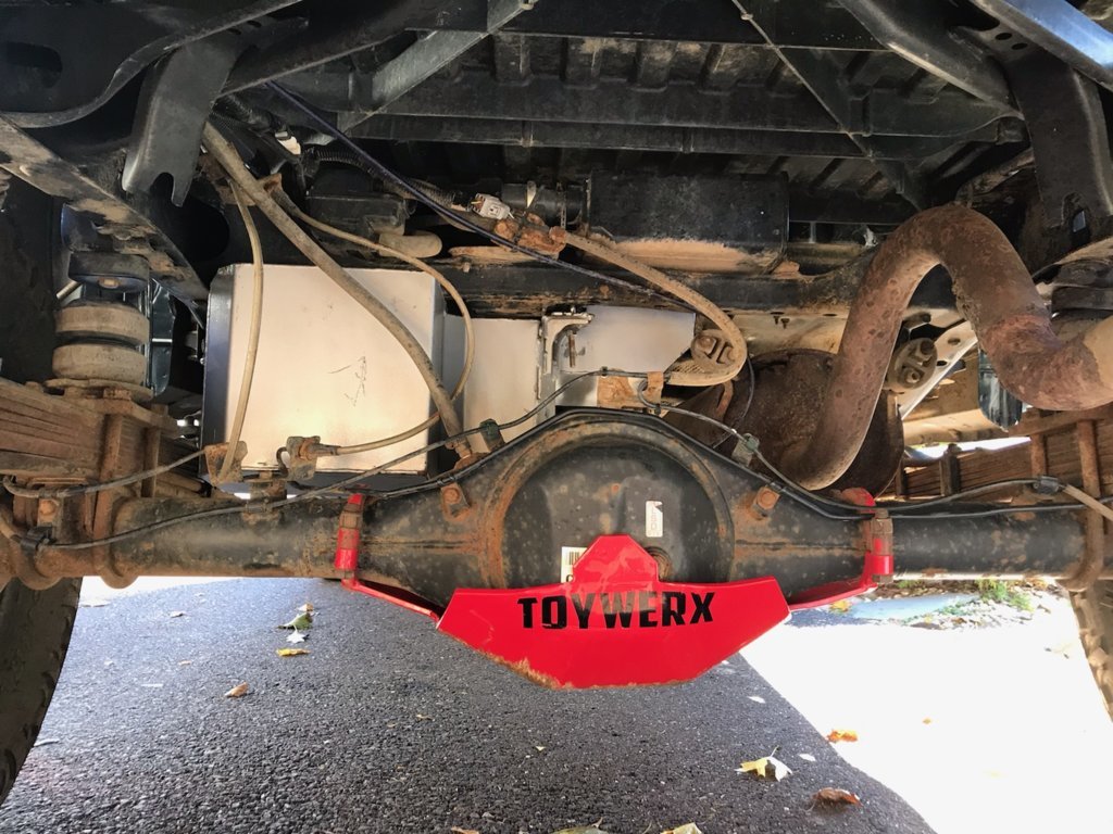

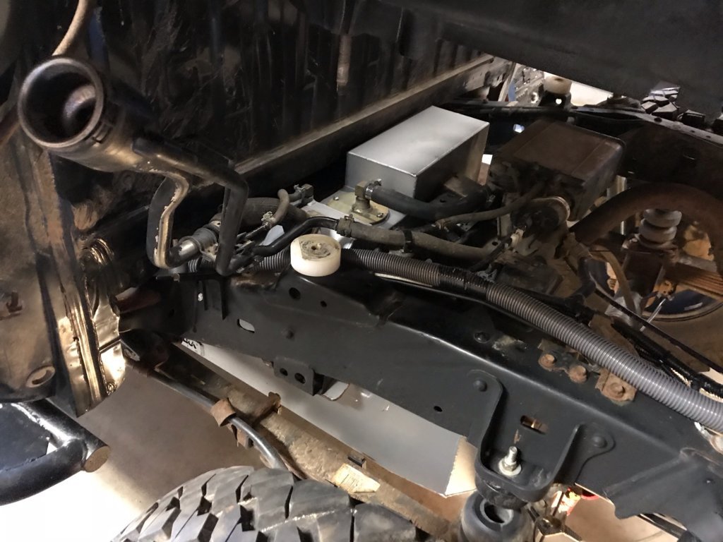

    Tank installed pics:
    Sits about 1/2” or so below the frame rail:

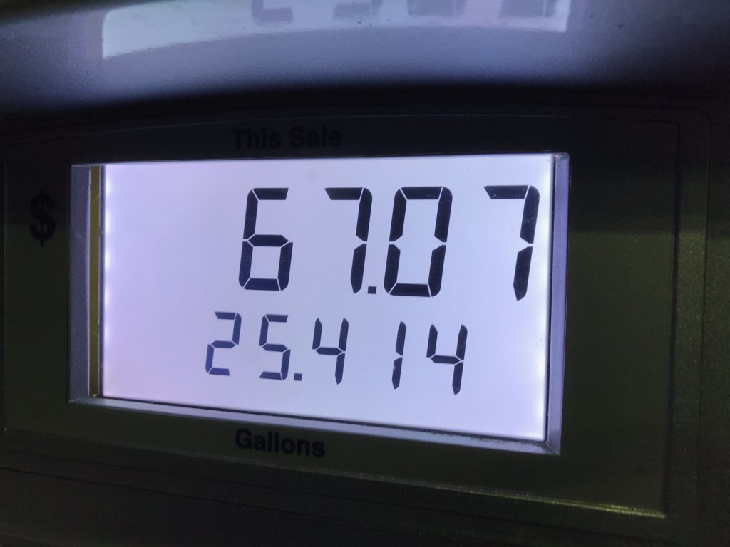

    Filled up on the way home:
    Mission accomplished. :D

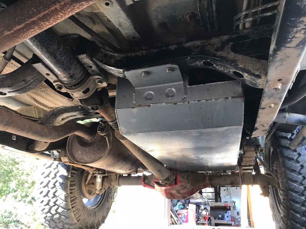

    Better installed pics:
    Only an inch to spare on either side.
