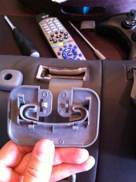

    Hey guys,
    I've posted on another topic asking advice on the front headrest install. I received two options: use a shop vac to suck all the air out or a steamer. I'll try the steamer route first cuz those front headrests are INSANE.
    NOW, next issue. I finished the back seats without much issue and they look pretty sweet. Problem is, the seat belt clip/retainer is being a bitch to go back on. Can someone #1, remind me what direction it goes on and #2, how the HELL does it clip on? The plastic sewn on the under side of the hole is far more flimsy than the stock piece, so I get zero purchase with the clip. ADVICE??
    I have attached pics to visually explain.

    :mad: wont let me post more than one pic at a time

    Inner plastic

    Shit.
    My 07 had a different setup than that for the seat belt retainer.:(
    PM Jhuey. He might be able to help you out.

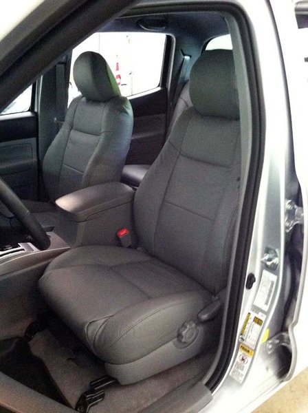

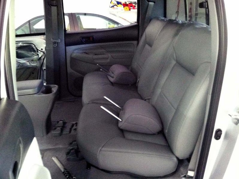

    Just a quick follow-up on the leather/heat seat install on my 2011 Double Cab TRD … Done!
    For those who have also performed this upgrade, I feel your pain … Particularly in the fingers!!
    Without “HomerTaco’s” pictorial guide I don’t believe this is something I would have even attempted …And I’ve done a ton of do-it-yourself projects.
    Kept the budget as low as possible, $400.00 for the kit (shop around, they’re out there), $90.00 for the carbon seat heater kit (EBay, came with direct replacement Toyota switches) and 2-solid days of labor.
    All told, right around $500.00 … saved approx. $500.00 in doing the install myself.
    Went with standard light gray leather, no fancy stitching or2-tone. Kit also came with the leather door insert material (what a tedious pain in the a** job that was)
    Actually worst part of entire project was getting the headrests closure seam strap secured … And having total (5) to do was a real headtrip. You will also need to use the “bag and wet & dry vacuum” trick to even get the covers over the front seat headrests.
    Bottom line for me ….
    1) Get a good pair of bull nose wire cutters to cutthe hog rings off.
    2) Get a good solid desk height work bench to work on the seats; this will save your back.
    3) Get an ample supply of nylon wire ties,invaluable in some areas where the seat kit lacks.
    4) I used the “X” cut method instead of removing the head rest seat posts, front seats nearly impossible to remove inserts.
    5) Take your time, there’s a lot of sharp sheetmetal that’s under the seat foam.
    6) Read this post and others regarding leather and heater install best to know what you’re getting into before ever getting there.
    7) Have lots of beer and good music on tap!!!!
    Good luck to all who take on this project …. It’s certainly worth tackling.
