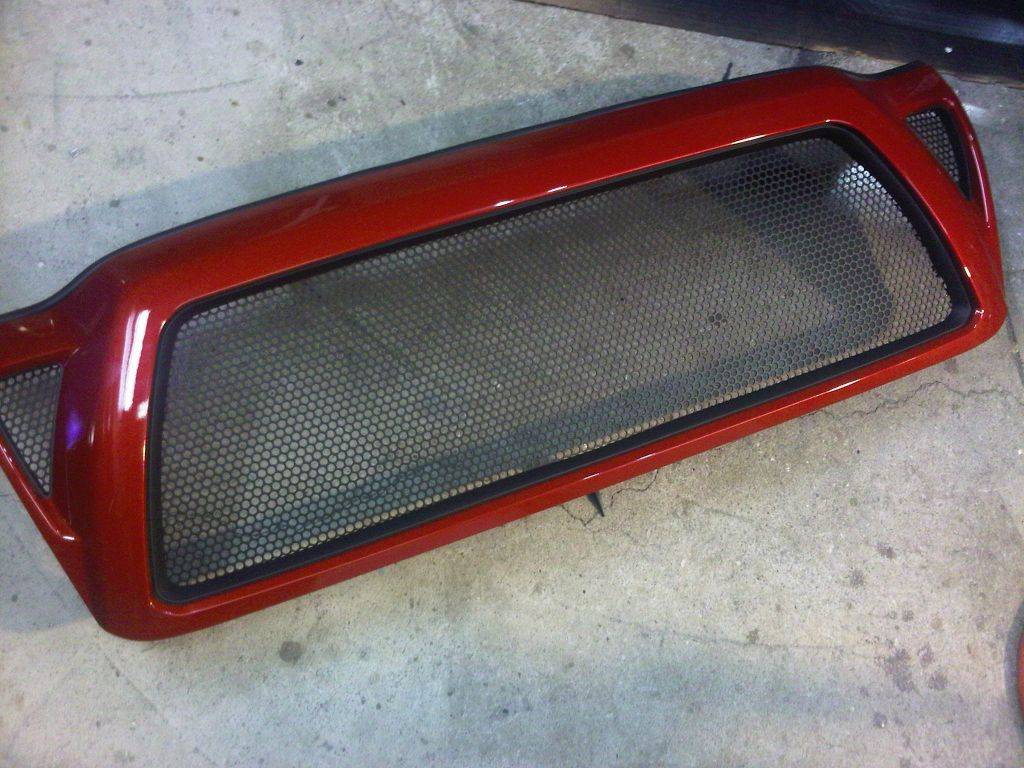

    We on TacomaWorld refer to a satoshi as a custom modified grill that looks like this:

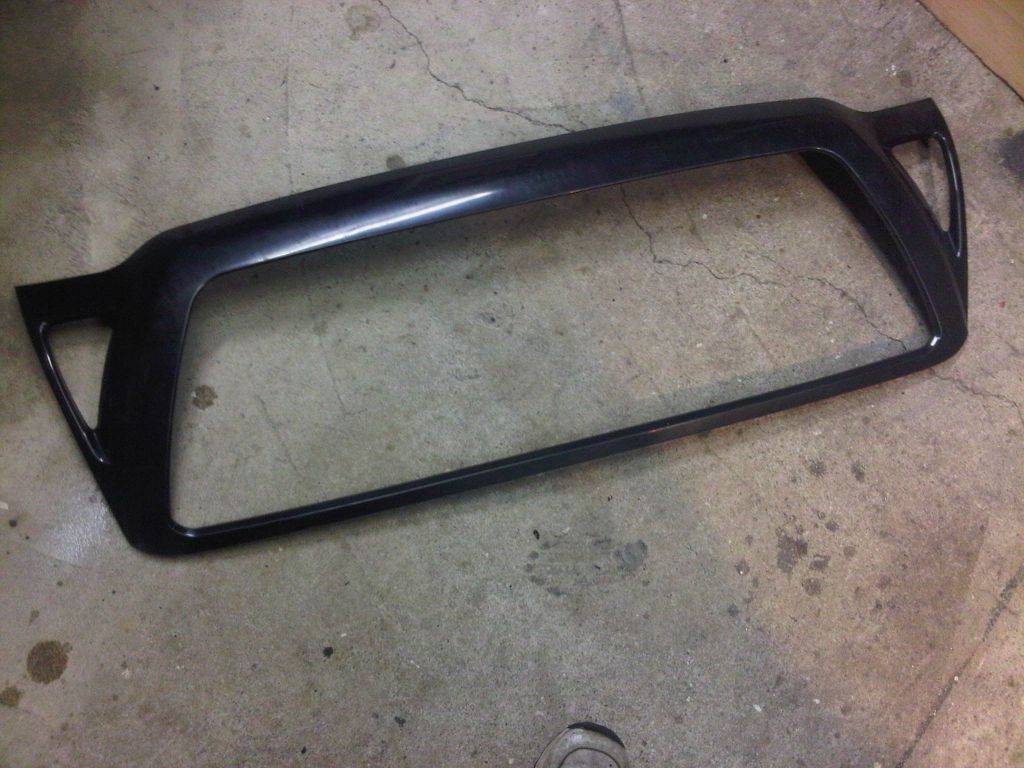

    First lets discuss the actual 2nd Gen Grill.
    There are two parts to all grills from 2005 to 2011. (2012 is a different design)
    The outer surround:
    And the inner surround:
    The examples shown are aftermarket replacement grills. The OEM grill is plastic welded together.
    (It can be separated & re-attached though - see this thread http://www.tacomaworld.com/forum/te...parate-reattach-two-piece-2nd-gen-grille.html )

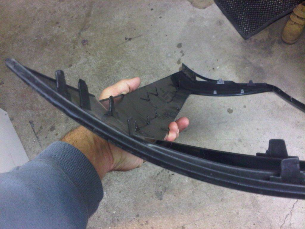

    The back of the outer surround has plastic "tabs" that get plastic welded to the inner surround & hold the two together:

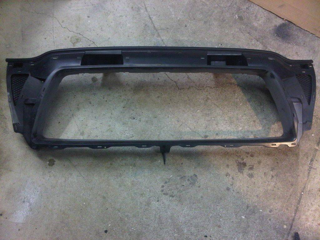

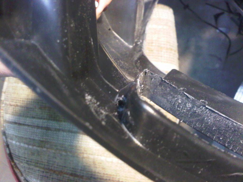

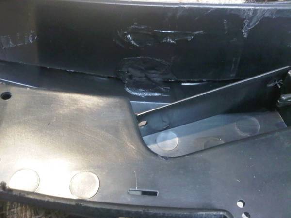

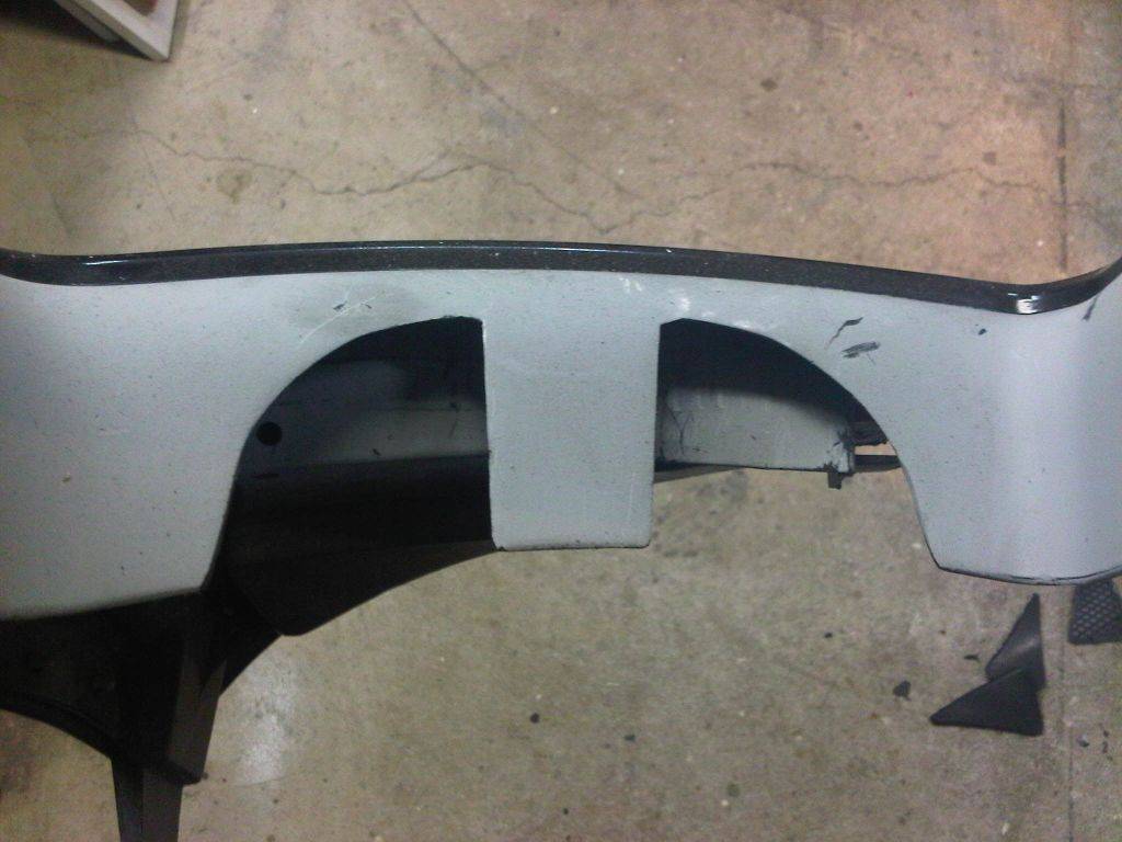

    Now in order to achieve the "satoshi" look, one must remove the center part of the inner surround...
    The result of removing that part leaves you with this:
    The part that make many people bug out of doing this mod is the body work required to fill in these holes that are left after removing the center of the grill.
    There are methods of using Bondo, epoxy, and/or plastic to achieve this.
    The end result being an inner surround that looks like this:

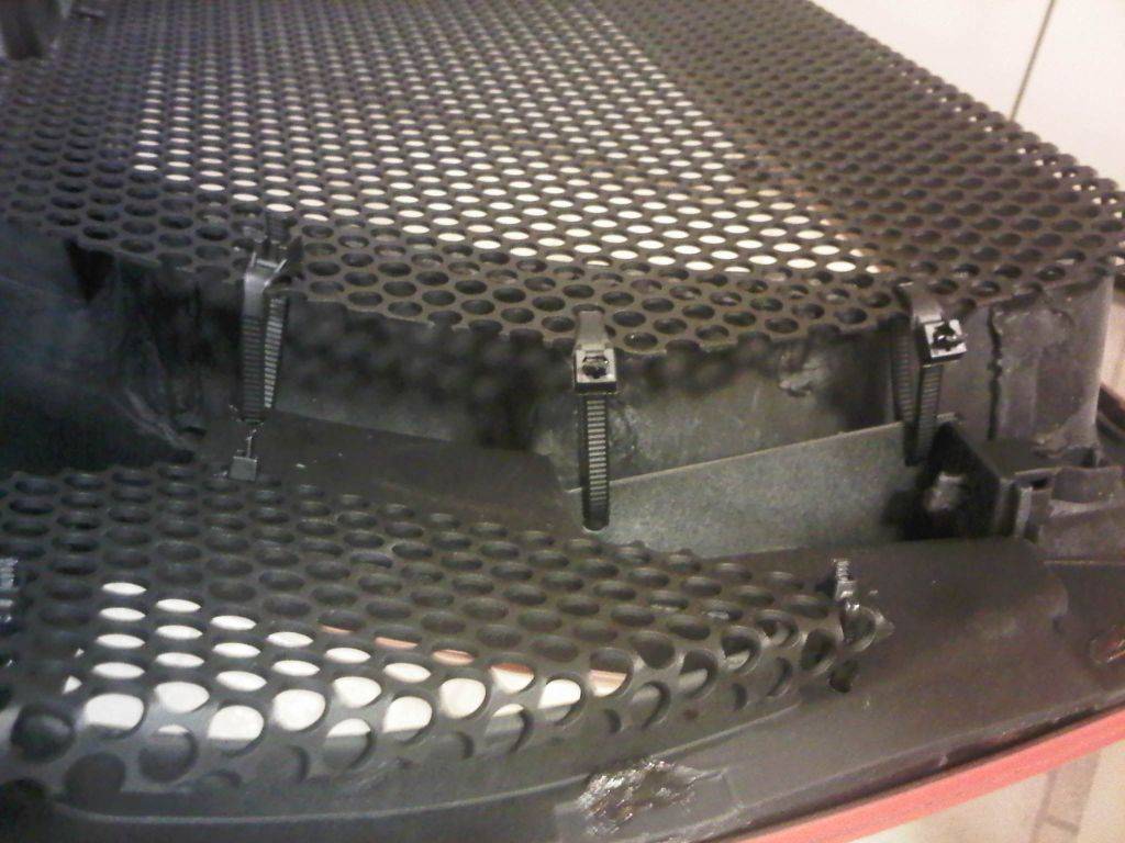

    Once you have completed all of this the next part of the process is to fill in this open space with mesh. (I have several that I sell here but it is also available online from other vendors)
    There are also many methods for securing the mesh to the inner surround. Most of these also involve epoxy in some form or another.
    Here process that I use to secure the mesh. It is simple, quick, and very secure.

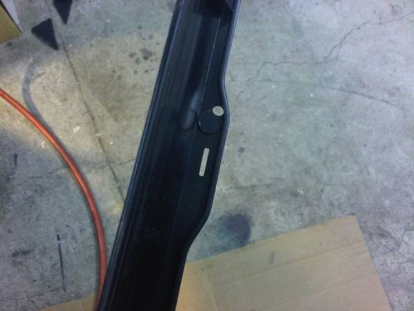

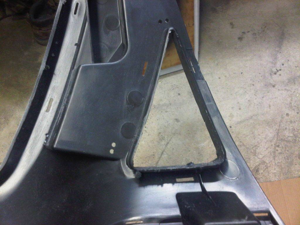

    For those that decide to open the two triangle pieces:
    The holes are drilled with a 1/8 bit
    For the top of the triangle another hole in the little plastic "bridge" support:

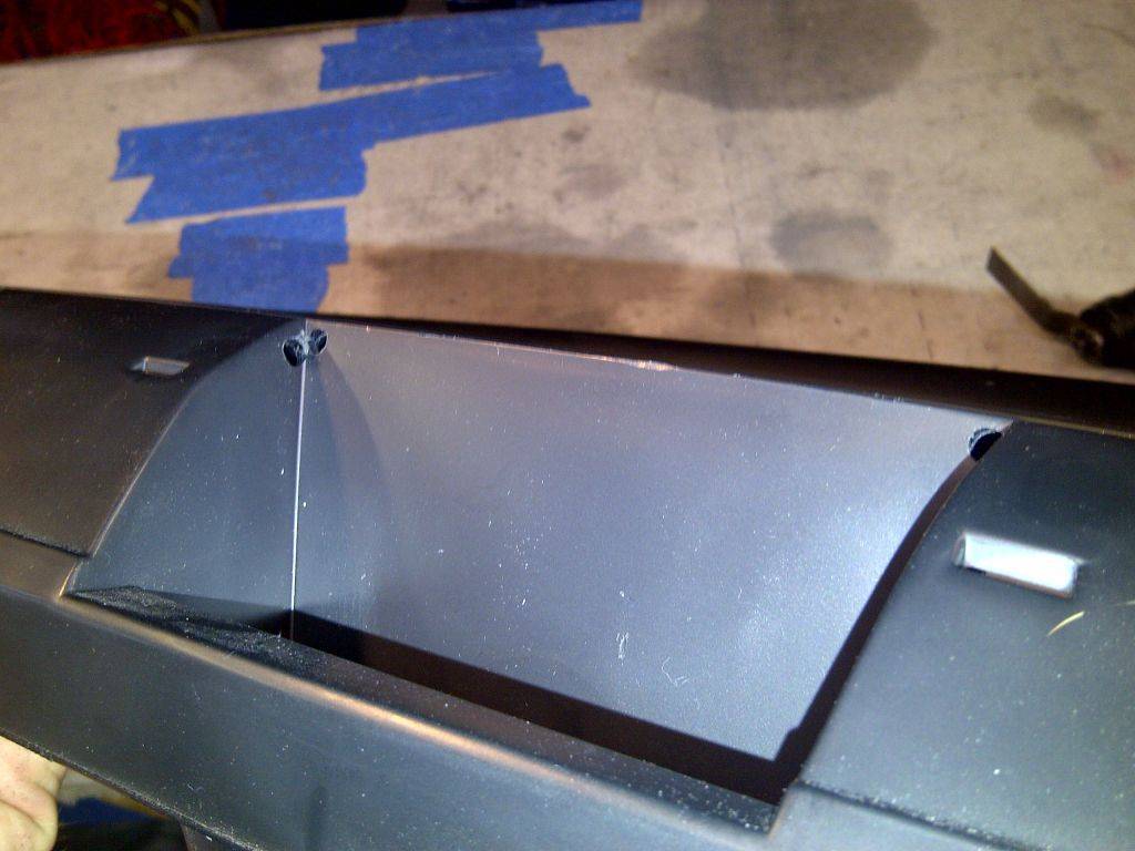

    For the main section of the grill you can drill holes in a few strategic locations that will allow you to securely fasten the mesh:
    These I did with a 1/4" bit.
    The sides:
    The bottom:
    The top:
    This does not require drilling - you can just loop the zip-tie around the factory supports to secure the mesh.

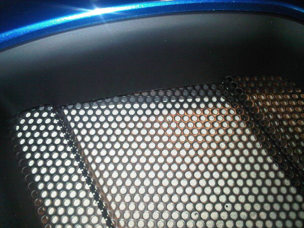

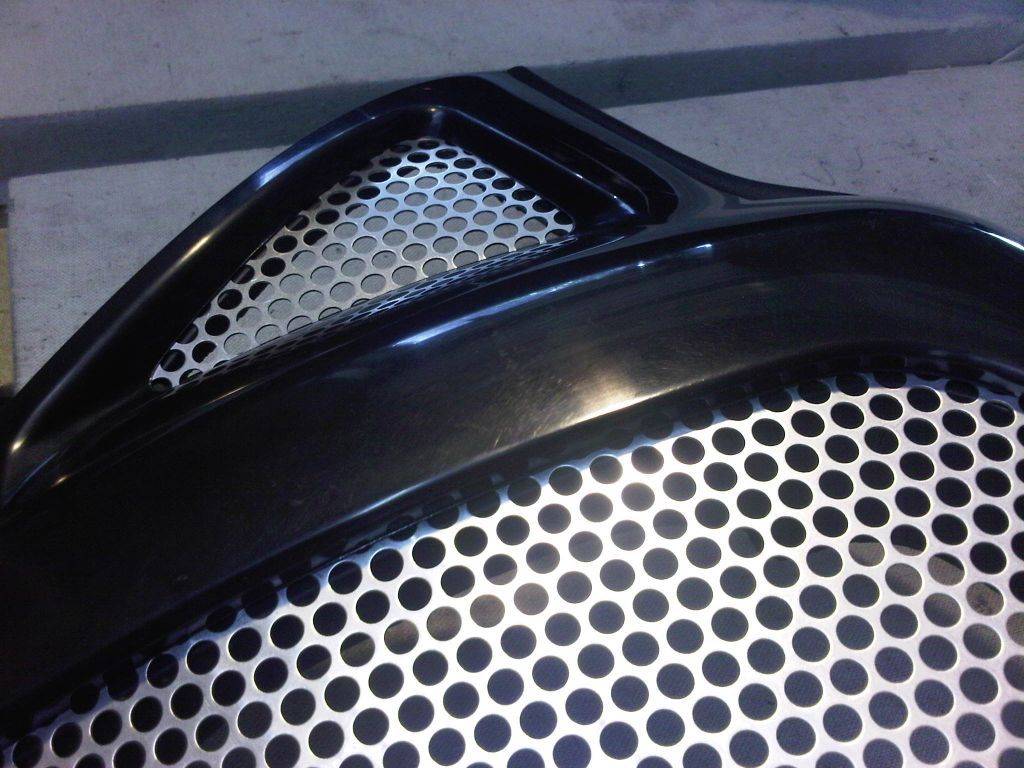

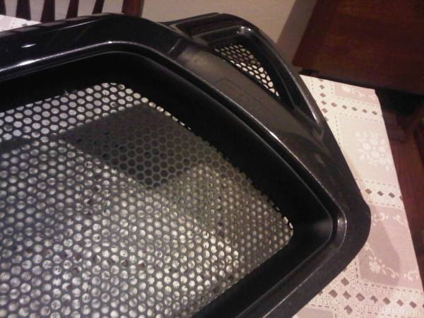

    Here is a picture of some M1 mesh mounted using this method:

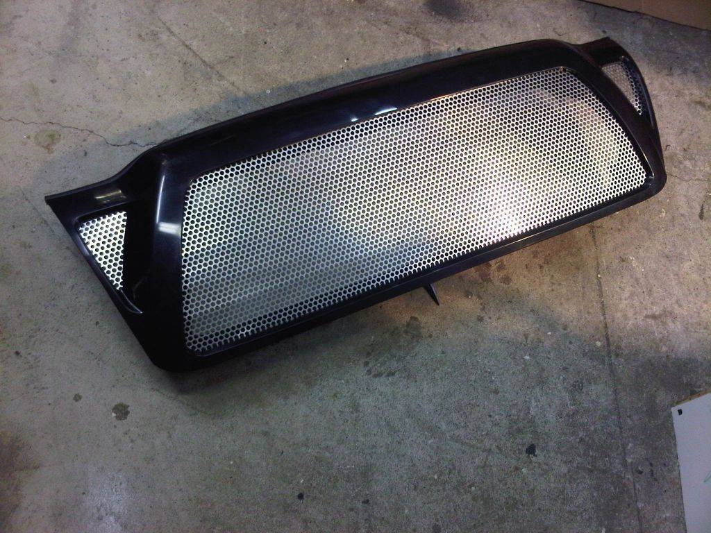

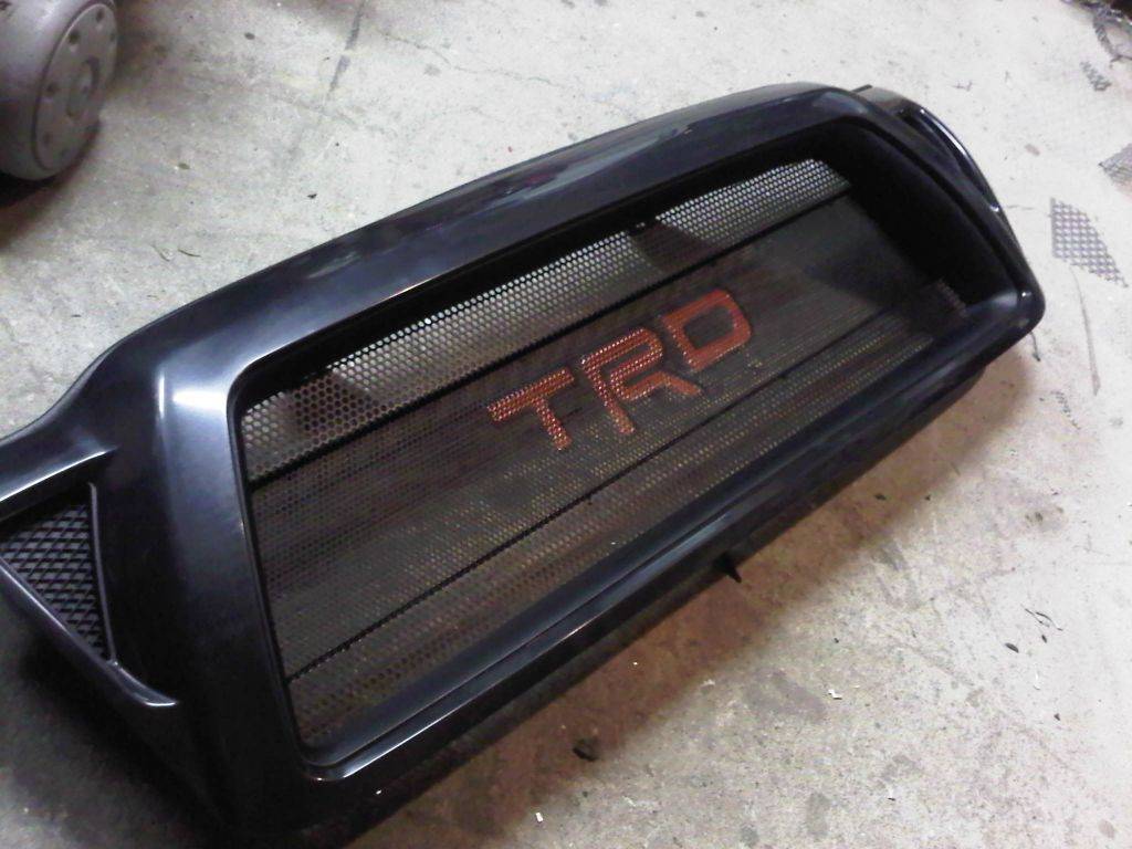

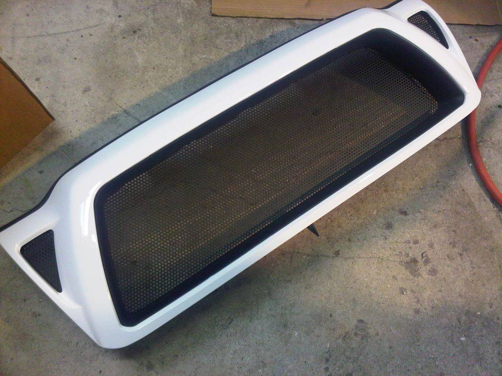

    I have lost count of how many grills I have made, but here are a few more examples of variations on the theme:
    A "thin-lip" satoshi, where instead of the mesh being recessed a full 2 1/2" from the front of the grill, it is set back only 3/4".
    A "reduced-depth" satoshi where the recess is set at 1 1/2" from the front lip:
    (thanks OZ-T)
    A "Homeroshi" Grill where the plastic cut outs on the sides are not filled in, but instead mesh is shaped to the new contour of the inner surround:
    (thanks rcbs204)

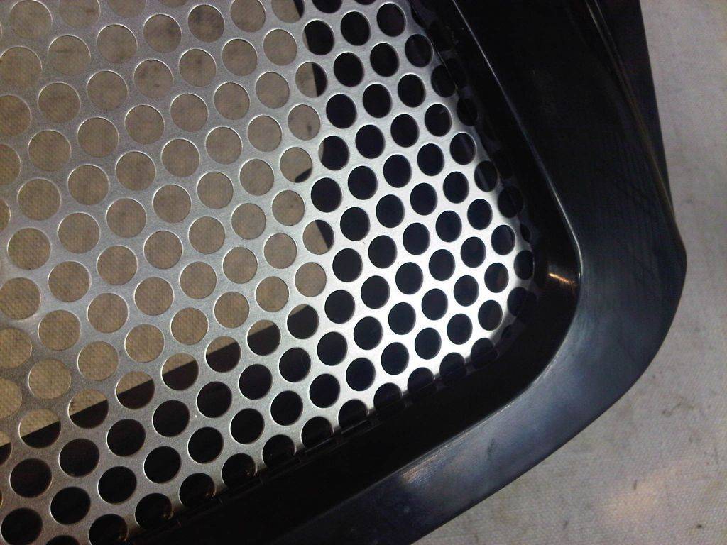

    A flush mount mesh grill where a thinner gauge mesh is "sandwiched" between the inner & outer surrounds creating a look similar to a GrillCraft insert:
    A Custom cut out of the recessed sides to accommodate custom mesh design:
    (My signature "TRD" Grill):eek:
    Thank you for looking! I'll post more info here if there is a need.

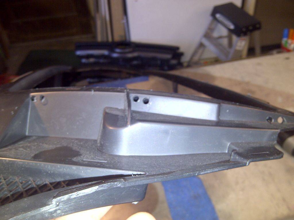

    By request here are the locations I drill holes to attach mesh for the thin lip application:
    This is shown from the front side with the outer surround not attached yet.

    Hey buddy, where are the holes drilled for attachment on the thin lips? Both triangles and mesh? Not a whole lot of room to work with..
  9. Jan 6, 2013 at 9:12 PM
    HomerTaco
    HomerTaco [OP] also HomerTaco Vendor
    Mar 28, 2010
    #34129
    45,760
    HomerTaco
    HomerTaco
    HomerTaco
    Look up at post #6
    Those are the exact locations I use.
