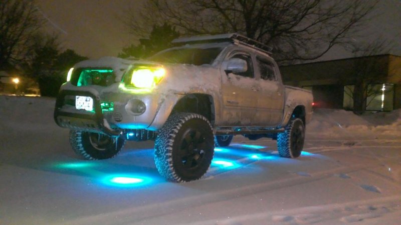

    How much shadow do you think the hood visor would create? Damn things covered with snow in this shot.....

    I honestly cant answer that question for sure. the only thing I can recommend is to set a 4ft level with one end at the base of your hood scoop (same surface as hood height) then hold it out above your visor in the level position and see if the visor is lower than the scoop. I would imagine the if the visor is lower, then it would work just fine with minimal light blockage.

    Dry fit.... Duh! I'll check it out!

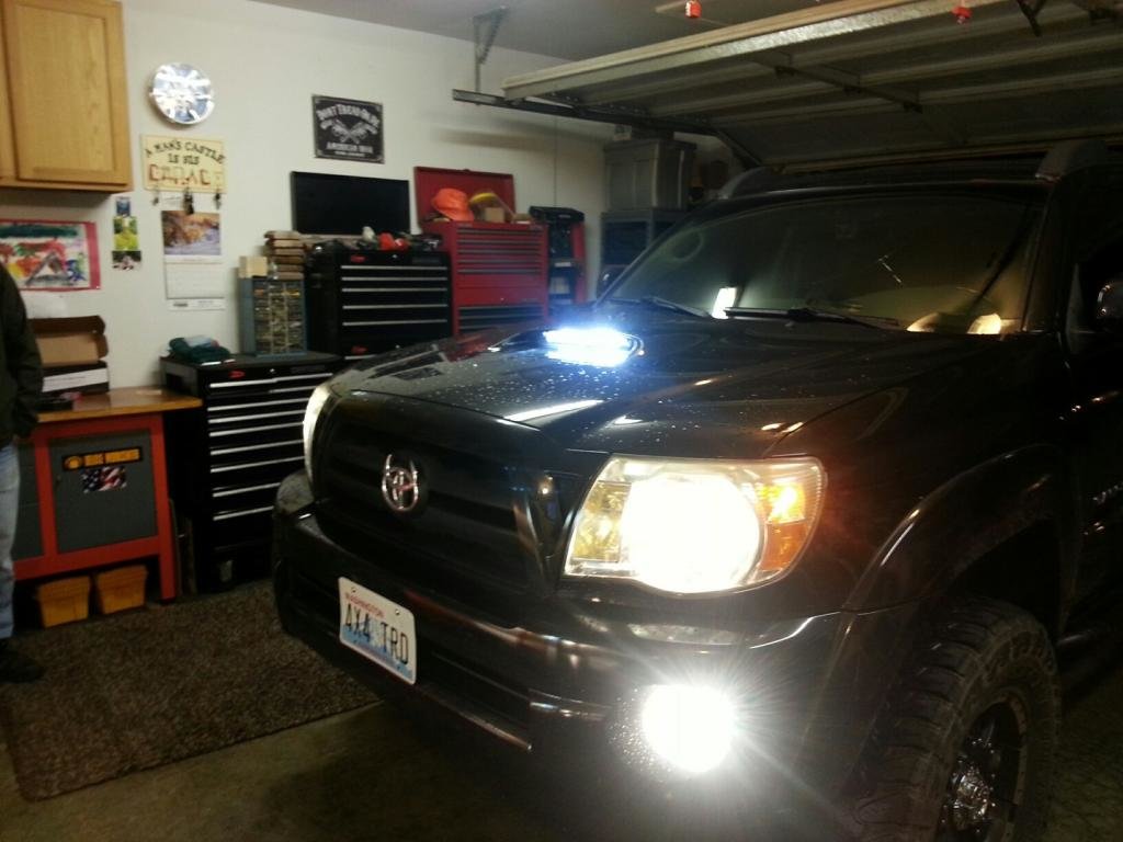

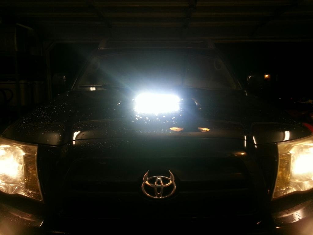

    Output is fantastic! Pictures to follow as I head into the woods...

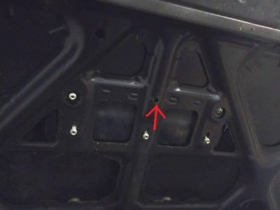

    Caleb you may want to add a note to the scoop removal process based on my install. There was a "hidden" screw that had to be removed on mine located here:

    Thanks for the pics! I will add that note to the install instructions. I appreciate you mentioning that. My 05 did not have that screw.

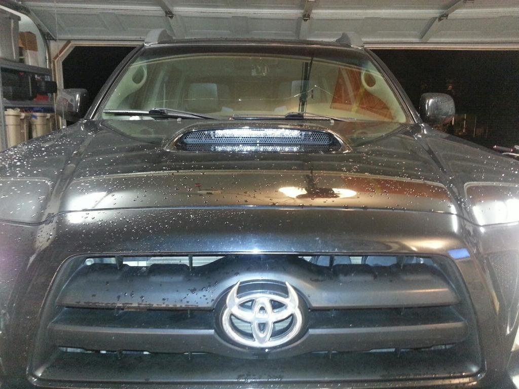

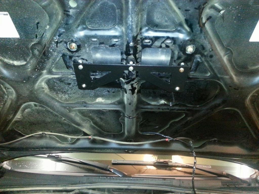

    Installed mine this evening. Had it wired up and installed in about 40 min. New bracket was a snap to install. Will be swapping out the rigid switch with a otrattw switch I ordered and tying it into my high beams.
