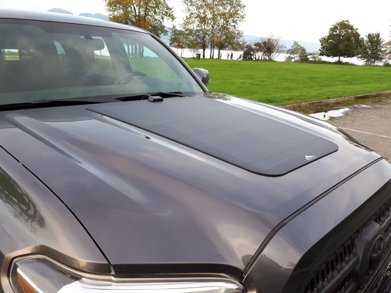

    OP, honestly this is a pretty decent idea. My particular group of friends has discussed the merits and draw backs of hood mounted solar for a while now and I am positive there is a market for this.
    That said I know quite a few people that desire solar specifically to keep a Dometic PLB-40 charged. The PLB has a built in MPPT controller and your 90W panel is very appropriately sized to keep it topped off.
    If I were you I’d look hard into a system for that specific setup (plug and play Anderson plug) and you might have yourself a market. As far as keeping the normal under hood battery full, we seem to have that pretty dialed.

    How much vhb is used to mount it?

    The vhb is around the whole panel.

    I wouldn't mind the panel being a bit larger, and following the contour lines of the hood a bit more. Seems like you could squeeze quite a few more watts out of the thing and make it more aesthetic at the same time.

    The 3M VHB actually is no problem to remove. We have installed and removed these panels about 100 times during our R&D process with no issues what so ever.
    The VHB is not in contact with the vehicle paint in our production model. We are including a custom cut clear hood vinyl which mounts underneath the panel to act as a barrier between the paint and panel. :)

    If it makes you feel any better we have been conducting R&D on this system for almost 2 years now. All issues that came up during the process have been sorted out and we are 100% confident that we are offering the best complete solar systems for vehicles. I would not risk ruining my business's reputation by selling a sub-par product. Nice things aren't cheap! :thumbsup:
    Feel free to let me know if you have any more questions about the panels. Or shoot an email to sales@cascadia4x4.com. :cheers:

    Incorrect. We have been testing this for over 2 years and have installed and removed 100's of panels with no ill effects to the paint. The VHB comes off no problem with a little bit of elbow grease:muscleflexing:
    Also note that the VHB is not actually in contact with the vehicle paint. We supply a clear vehicle vinyl which acts as a barrier between the panel and the paint.
