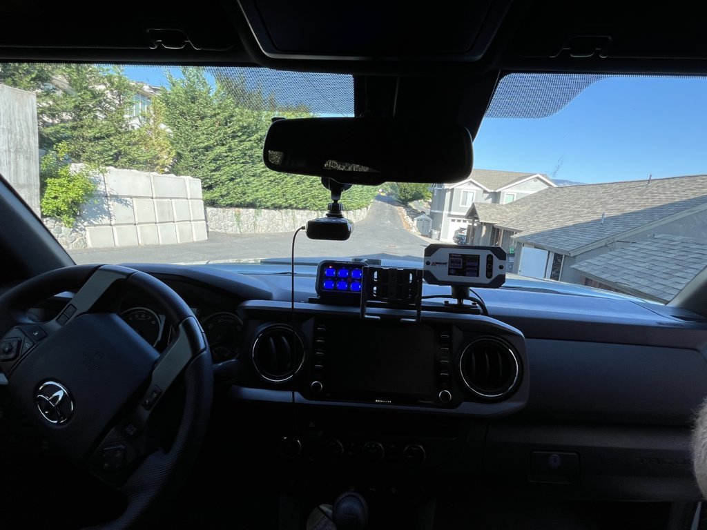

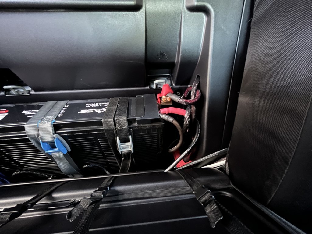

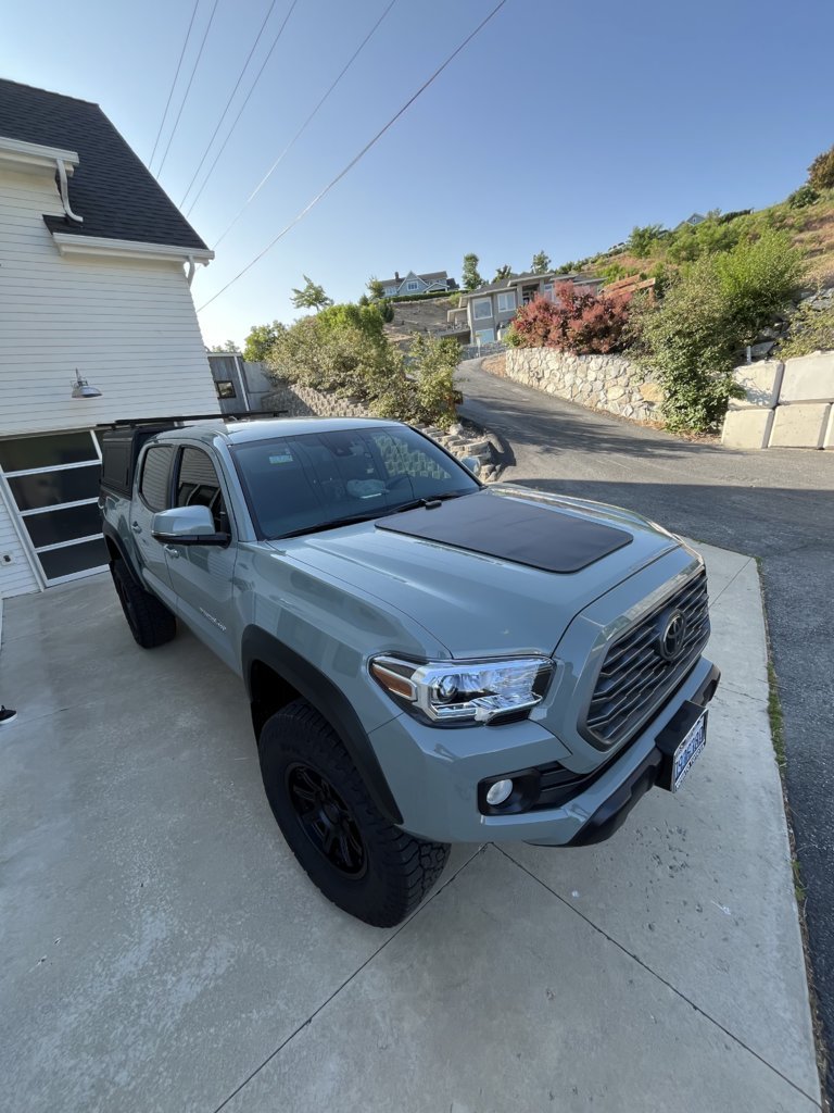

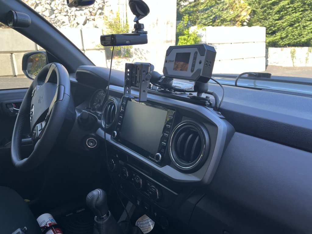

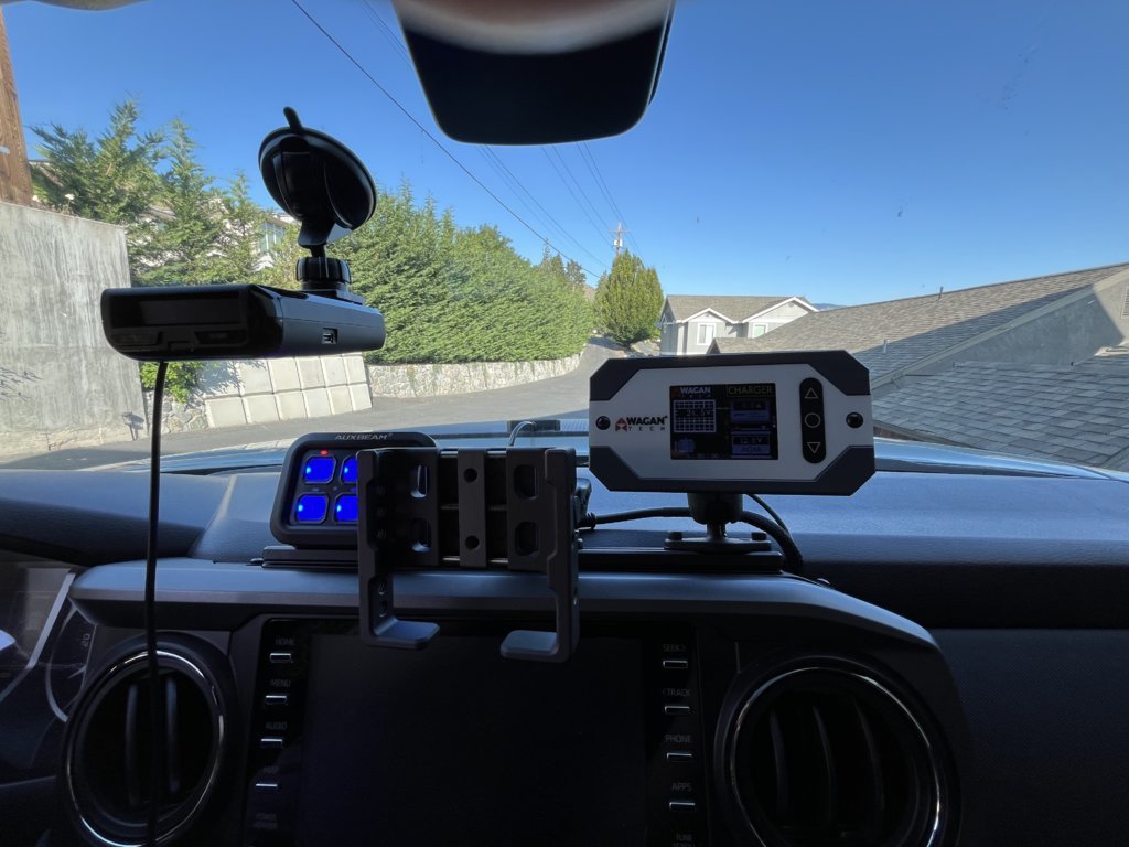

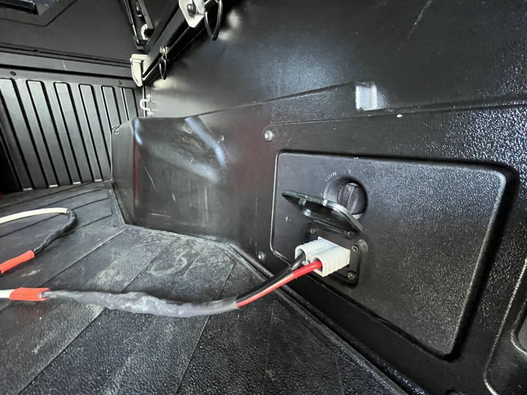

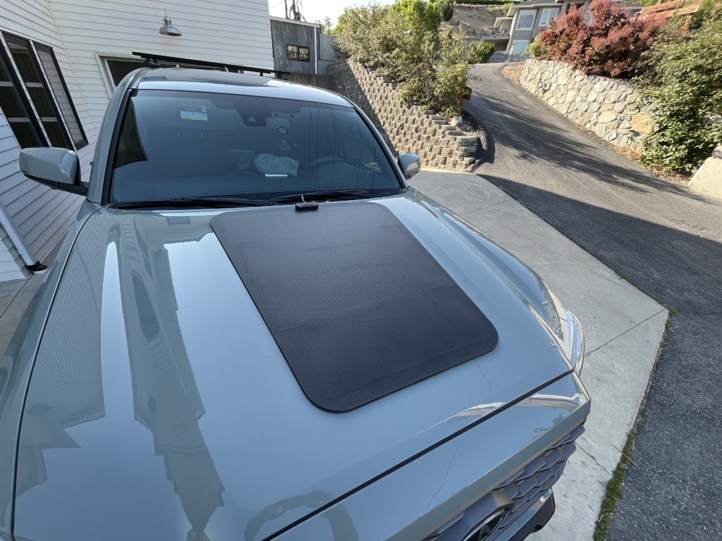

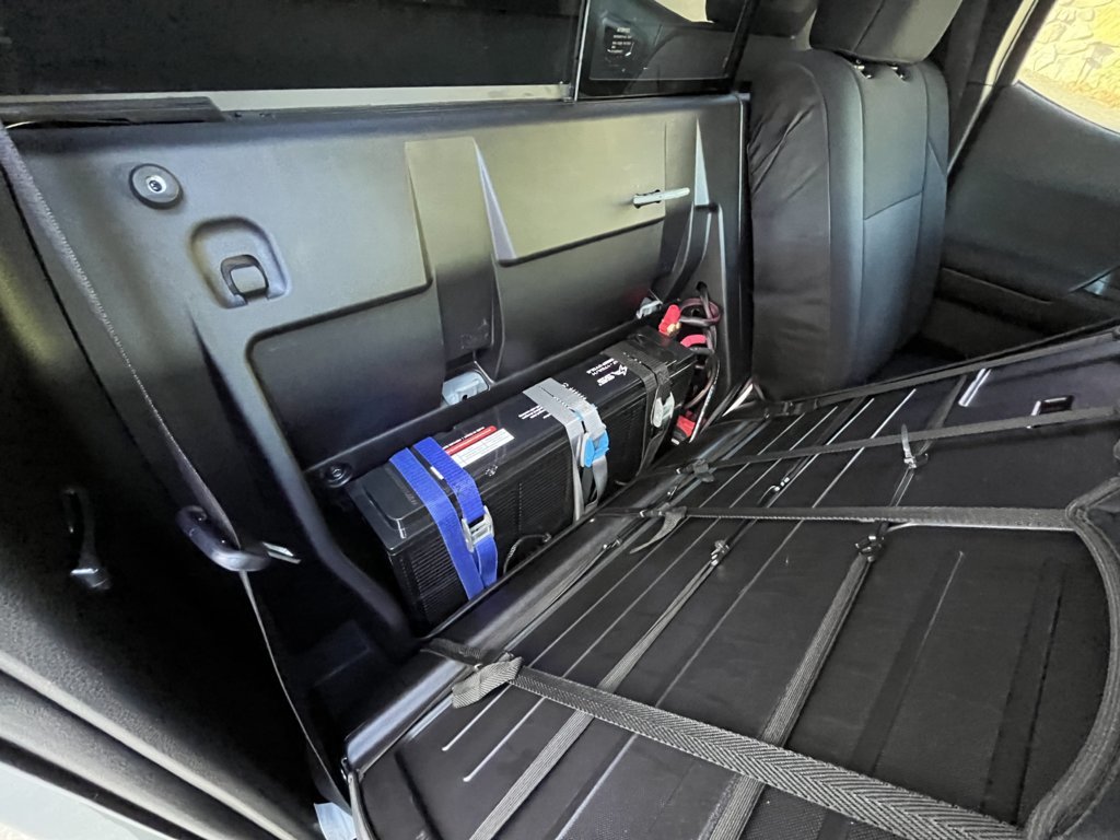

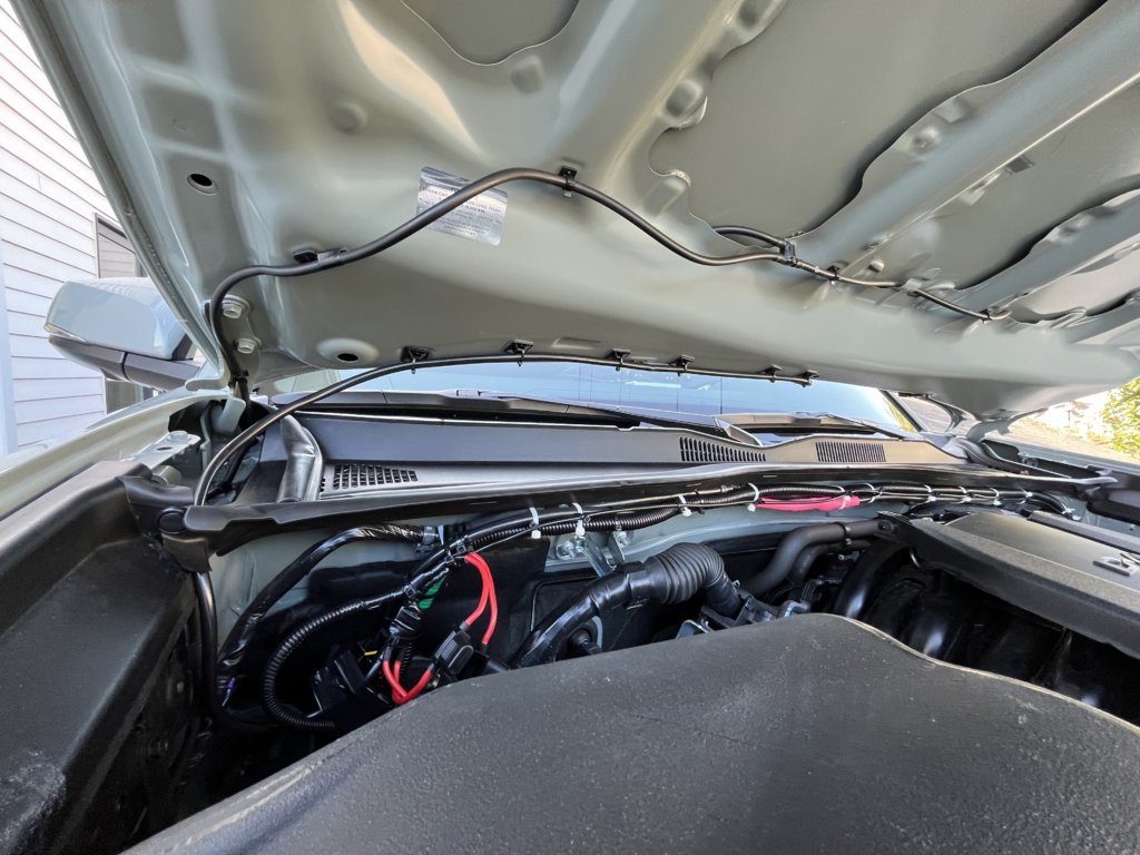

    After a long wait received delivery of Cascadia 4x4 Hood Solar VSS 2.0.
    Really well built and simple to install with a great install kit and instructions.

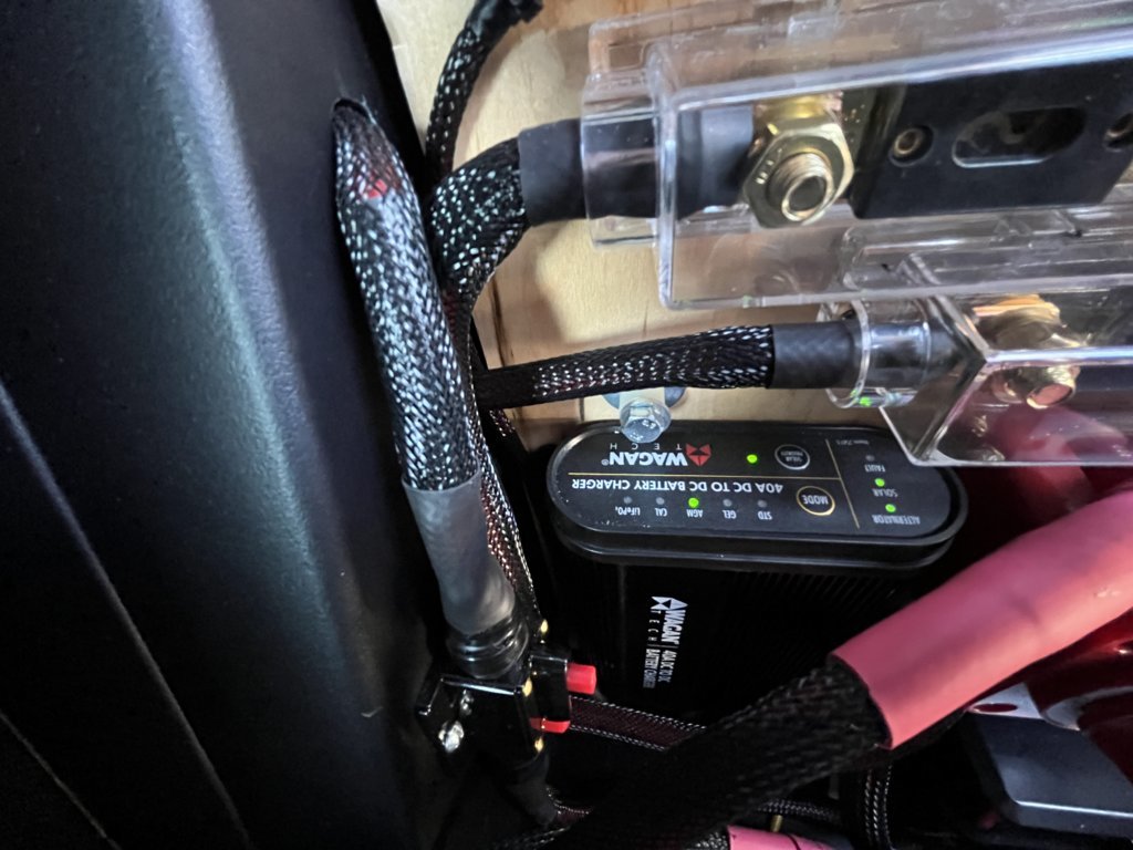

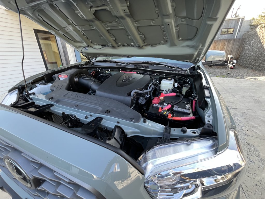

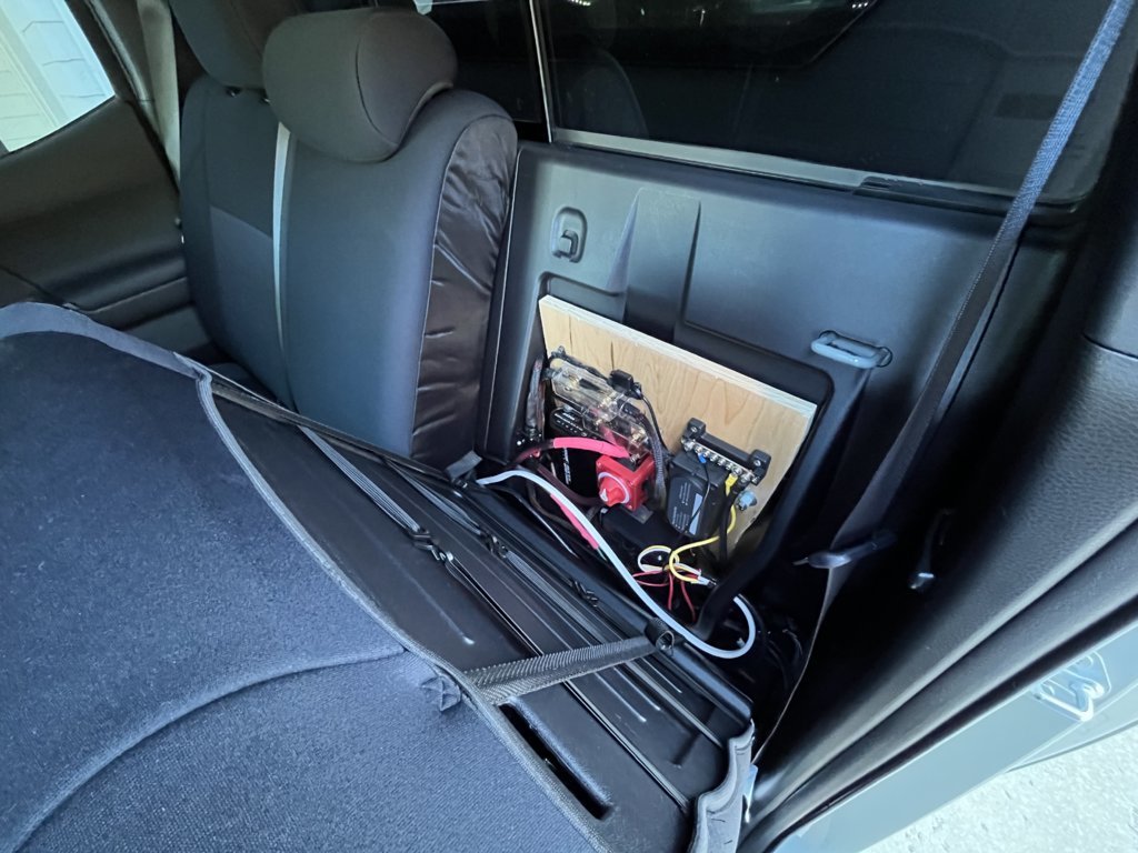

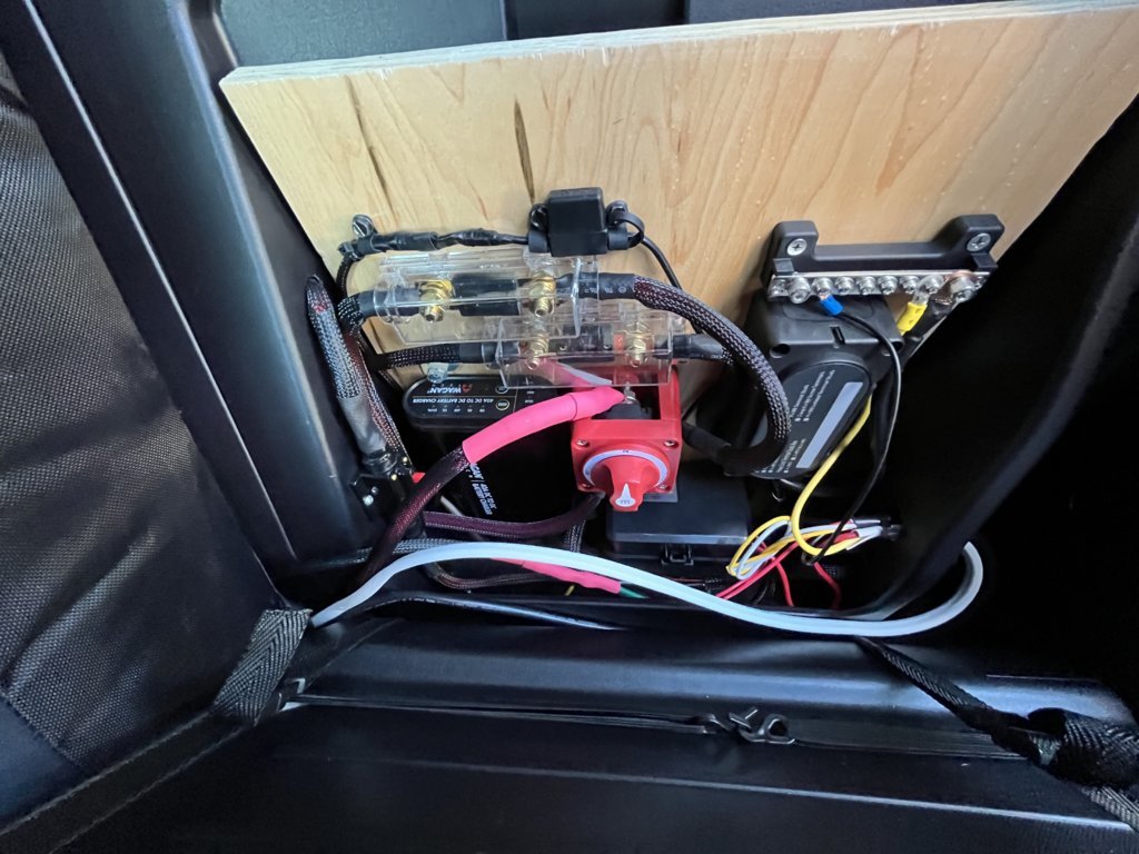

    I am using this to supplement my AGM battery. My DC-DC system has a solar input and I had designed the system to accommodate this panel addition.
    The only hiccup I encountered was that the panel produces a higher voltage than what my DC-DC charger allows so I had to source a Buck converter to regulate voltage down to within the tolerance of the DC-DC unit.

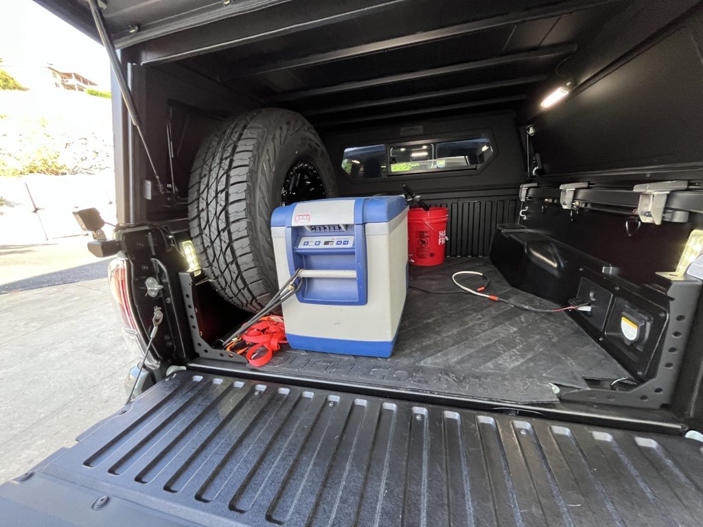

    Full sun the panel is producing about 2.5 Amps at 24 volts after conversion by the Buck converter as measured by the DC-DC unit. This is almost exactly what the old ARB fridge pulls to maintain 28 degrees (old blue fridge) so essentially allows me to maintain battery during the daytime but it will eventually bring down battery over several days but the battery is 170AH so should hold up for a bit. This just slows the drain during the hottest part of the day. Still working on a semi-permanent mount for the fridge.
