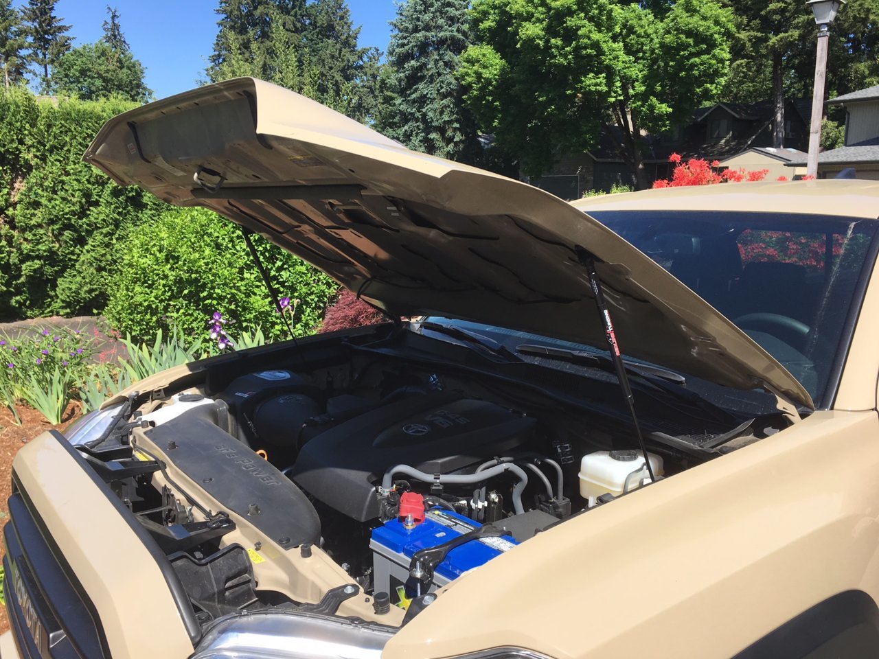

  20. Feb 18, 2019 at 10:29 AM
    #20
    Captqc
    Captqc Well-Known Member
    Mar 5, 2017
    #212458
    4,956
    Tigard, OR
    2017 Tacoma 4x4 TRD AC Off Road
    Totally unnecessary, but oh so nice!
