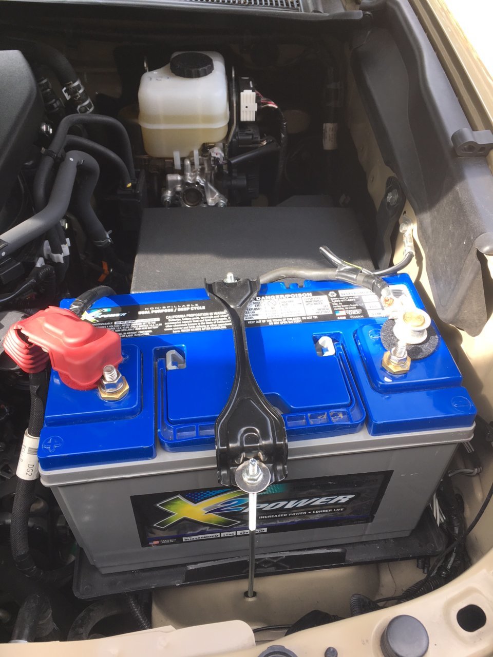

    2016 BR SR5 DCSB V6 4WD. TRD Pro 17's, BFG KO2's
    Off topic, but what battery do you have installed??
    Thanks
    G.

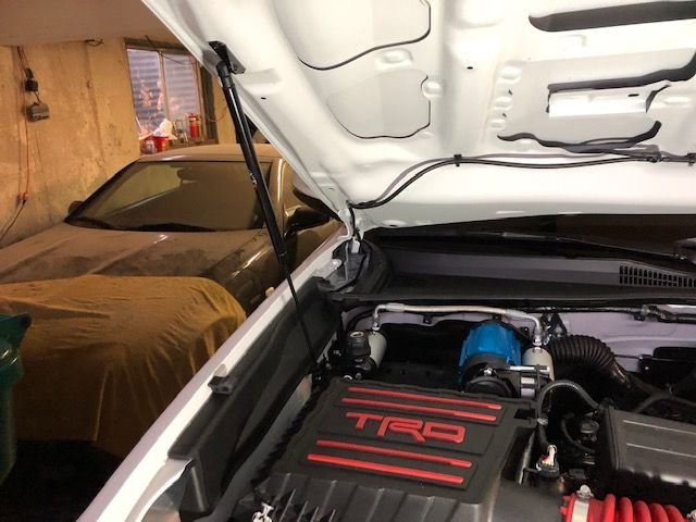

    Nice. That's another issue I had, my accessories mount in the usual location, right behind the battery, seems like that prop would get in the way.

    Well, to be fair, I'll be installing a compressor soon on the passenger side behind the airbox, so that may be my first issue with those. I'll keep you posted.

    Stock battery tray and hold downs?

    Nope, I modified the holder and bought a replacement tray from the auto parts store.

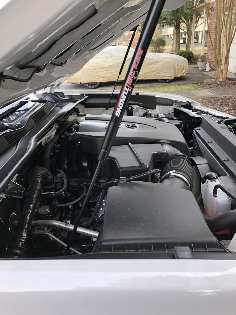

    Redline struts and then I put on a cooling panel to hold my tools...
    Super awesome product...
