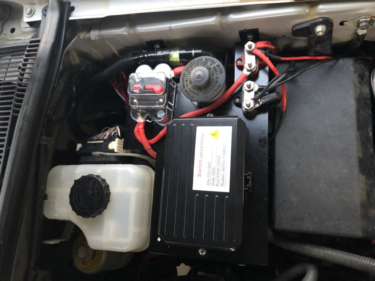

    How long are these stuts?
    I'm also worried it will interfere with my power tray...

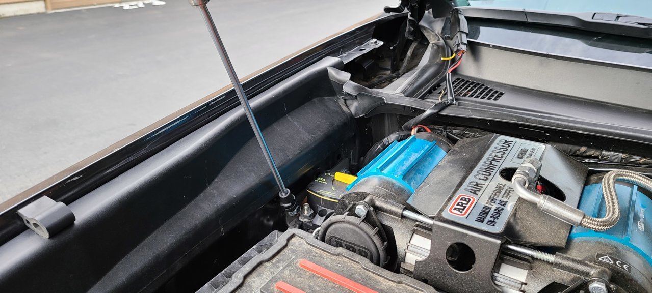

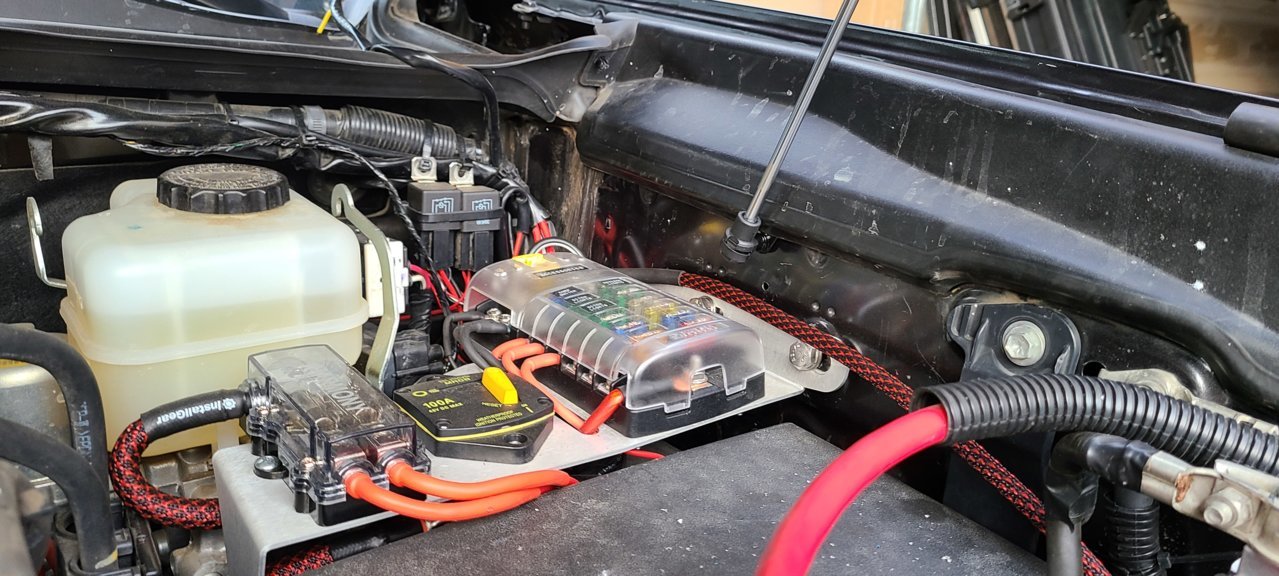

    My @RedlineTuning work with my power tray... and my ARB compressor.

    Unfortunately I'm deployed right now but reach out to Leon at Spiker and he will answer all your questions. My spacers are just threaded pieces of stainless hex that you can get at the big box store. Well worth the upgrade.

    I don't see an issue with the powertray components in your setup. The struts typically do have a slight interference with the fender mounted clutch cylinder like yours, requiring 1/2" spacers. In your setup, since the reservoir is closely surrounded by the powertray, you'd have to space the powertray as well with 1/2" spacers. Totally doable :thumbsup:

    I realized later that this is a 3rd gen thread. My taco is a 2010, so would it still need the spacers?

    With the photo you posted, I don't think you'll have an interference issue.
