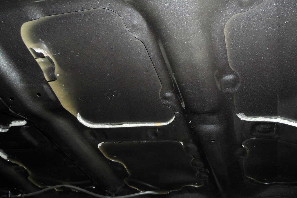

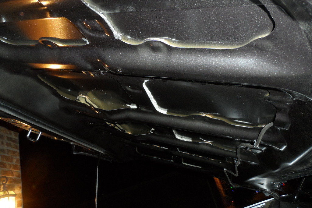

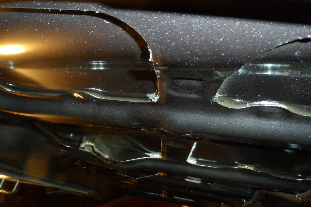

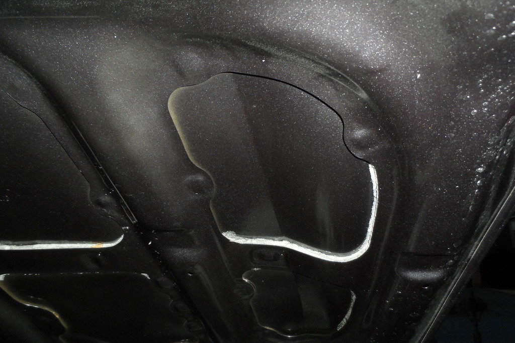

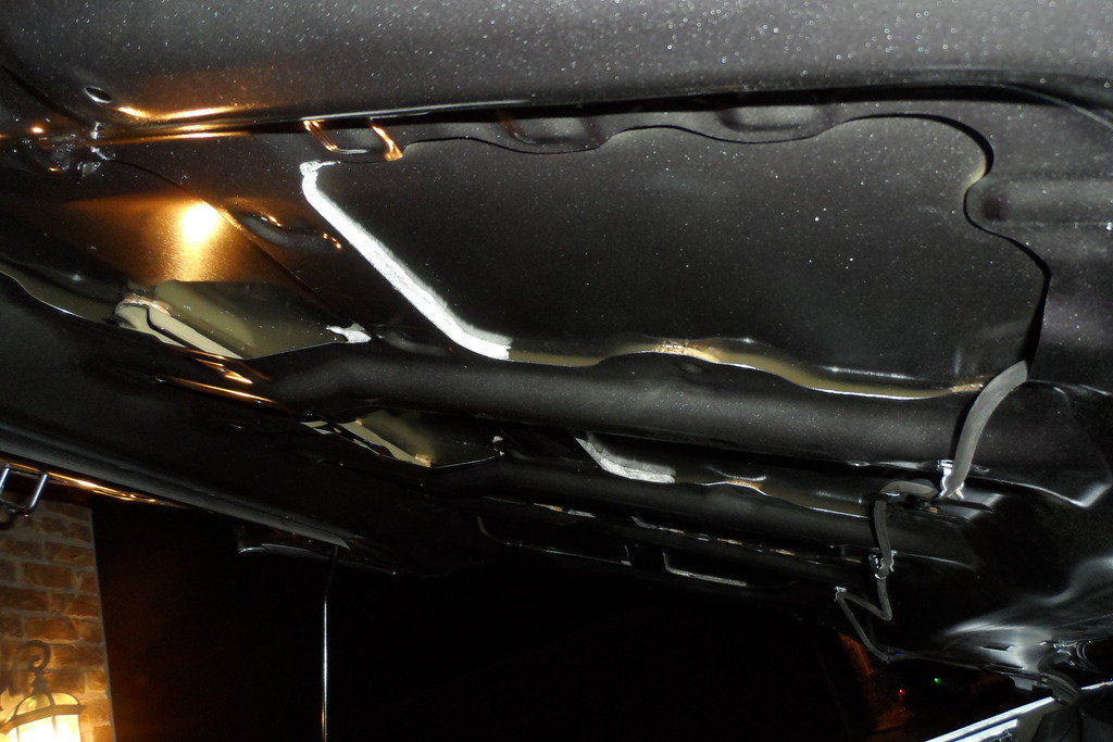

    Got mine back just now.
    Took them about two hours.
    They spec 3M-08463 flexible foam.
    I really didn't want them trying to repair the old stuff and was skeptical they could do so without 'damage'. The body shop agreed.
    So, this is what was decided in my case; between the body shop, Toyota rep, and myself.
    Solid as a rock now.

    Do you notice any changes in the smoothness of the outer skin? When you get a chance maybe spray it with water and see if there's any low spots.
    Did they seal completely around the circles or just what we can see?
    Lastly, if yours did, is the visible vibrations while driving gone?
    I talked to my dealerships maintenance today and they were clueless and don't even want tool ok at it until my next service. They don't have a body shop so I may research other somewhat local dealers for repair.
    Thank for posting the pictures.

    No change at all. I voiced my concern to the body shop guy beforehand; even related the story from this thread about a dented hood, cure times, etc.
    My body shop guy was cool. He even called me on my way home.
    He even thought to test the foam before jumping in. It expands a lot and is way more rigid.
    I still think the 3M-04274 NVH dampening product I posted earlier in this thread is the more appropriate material.

    It's hard to tell, did they go all the way around the seam (circle)? If so, what's the difference between the whiter part to the part that's more of a yellow color.
  16. Dec 7, 2015 at 6:29 PM
    #236
    splitbolt
    splitbolt Voodoo Witch Doctor
    Mar 7, 2010
    #32761
    7,858
    NW Arkansas
    2016 TRD OFFROAD DCSB MGM
    The white part is the foam; the yellow is lack of paint from the brace being in the way.
    The 'plan' was to go down the main braces some too.
    My body shop guy called me at this point because he thought it was gtg. I agreed.
