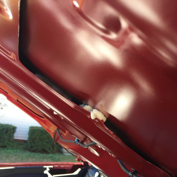

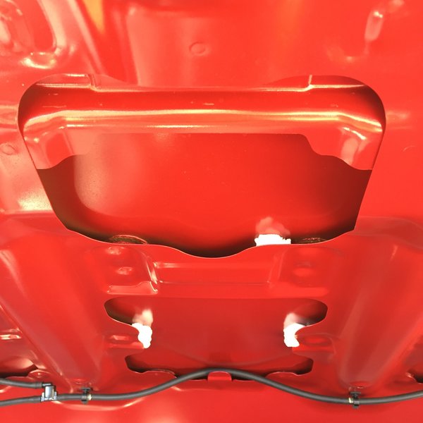

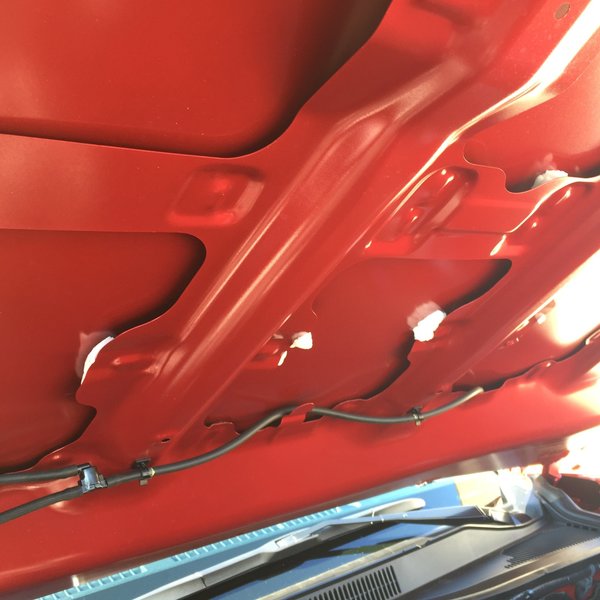

  10. Dec 9, 2015 at 9:52 AM
    #270
    mjones1970
    mjones1970 [OP] Well-Known Member
    Nov 20, 2015
    #170192
    92
    Today I was looking at my hood more closely. I got a Magic Eraser foam pad and ripped it into about 1" squares and placed them between the metal ribs and the hoods outter skin. It was a snug fit but didn't cause the outer skin to bulge out.
    I took the truck for a drive at high speed and over rough terrain and it eliminated the vibrating and looked solid.
    This will not be my fix but for me proved that with the right adhesive it will eliminate my hoods vibrating issues.
    I also looked more closely at my hood and every single adhesive contact point has failed.
    My opinion is the dealership needs to get the correct adhesive from Toyota and reapply it. If it adheres and does not separate then we're good to go. If it doesn't then Toyota needs to provide an alternate adhesive. It should NOT be up to the dealership to come up with a solution.
    My $0.02.
    Oh, and I'd not leave any temp solutions (foam, etc) in your hood when taking it to get it fixed. They may cry foul.
    Added: This may not be said very well, but here goes. The gap between the ribs and butter skin is already there, with out the applied foam. The gap in those areas is about a one inch gap and it's not easy pushing the rib up to the ouster skin to close the gap (i.e. closing the gap between the two areas of adhesive that have separated. This makes me wonder if there's a size defect in either the ouster skin or the ribbed layer. Maybe a metal shrinkage problem in the processing of the parts. Who knows, I'm not educated in the process, just wondering why there's such a wide gap. For all I know the adhesive was fine but didn't have the load bearing properties to hold the two together if there was an error in the metal parts.
    0uTkAsT and Shelf Life like this.
