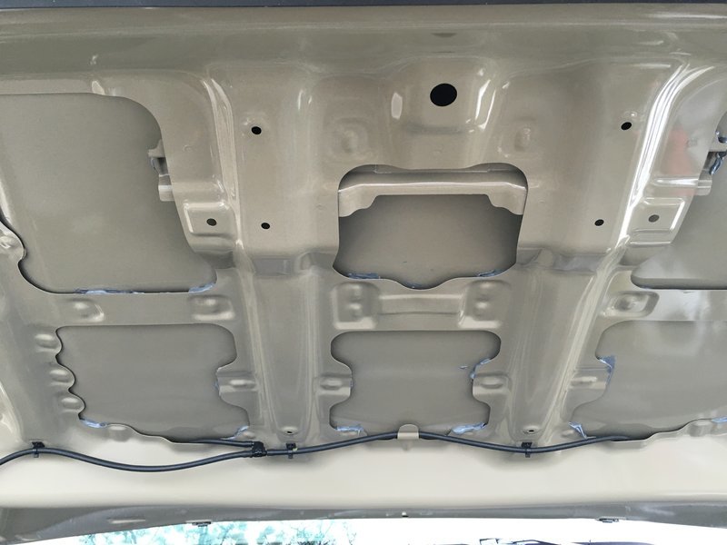

    Went out and checked mine this morning after reading this thread. It was well secured and doesn't have any deflection whatsoever at highway speeds. Mine was a February build out of San Antonio...looks pretty well done, and the gap looked smaller to me than what I was seeing in the pictures here. I suppose it could be camera angle.

    image.jpg image.jpg Dealer had me take it to a well known auto body shop at dealer's expense and at first they only put glue in a few spots but after I inspected it and said I was hoping for more and pointed out where they had missed areas the guy went and did it proper. It had rained a bit so I was watching the rain drops on the hood and no vibration at all.
    Funny thing is I'll be swapping hoods tomorrow with @easbaysav. Just wanted to do right by a fellow TW member and get him a solid professionally fixed hood.

    Could you take a close up of your adhesive points and post? Just to compare to others that have posted.

    I'll take some pics in the morning.

    your hood looks good...definitely better than some ive seen on here and mine which is september build in TX with adhesive failing but i havnt noticed much vibration...hopefully they got enough complaints to address this at manufacturing and come out with a TSB...if i dont hear anything fairly soon ill be doing my own fix

    I'll be keeping an eye on it too...I wouldn't hesitate to add some dampening material myself if I start to notice the hood vibrating. Thanks to all who have shared the knowledge here.
