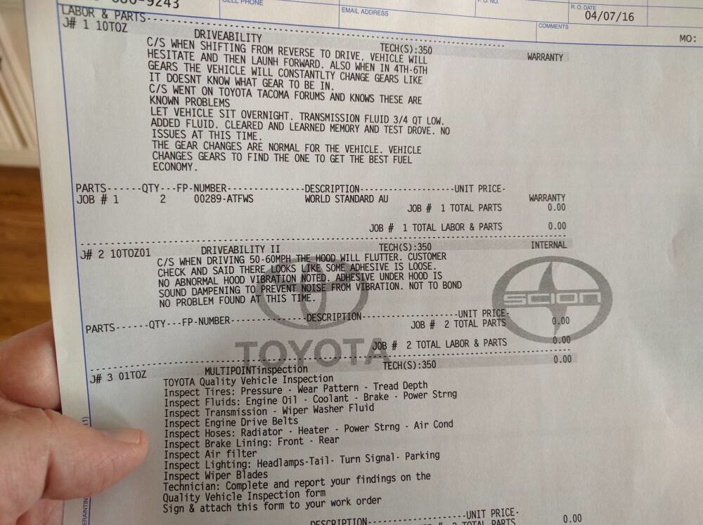

    they called this morning. they told me that the hood vibrating is normal. i'll likely just fix this myself or wait until a TSB comes out about it.

    Contact another dealership, more than likely you'll get sent to an Auto Body shop but at least it'll be covered by Toyota. Buying the stuff to DIY will run about $100 - $200.
    There's a bunch of quirks with this truck and yet to see any TSB's.

    Once you realize how easy it is to fix the vibration on your own, you'll kick yourself in the ass for not doing it sooner rather than playing "hood tag" with the stealership.

    i had it in for the low ATF. i'd likely have not made the trip over there for just the hood fluttering.

    I traded hoods with @mesojdm last week and his dealership fix his hood. The body shop that did the repair applied 3M NVH in all the sections where the dampening material separated and the hood has been fine so far. Haven't noticed any vibration even in the triple digits. He even got the remaining tube of NVH from the shop in case I needed/wanted to apply more. Kudos to @mesojdm for that.

    I will post pictures later but I got mine back from the dealership yesterday for fixing the hood and low tranny fluid. They sent it to a body shop and they went ape shit bananas with the epoxy Toyota sent over. They repainted the underside of my hood to hide where they put it all.

    They put new glue/epoxy around every rib in the frame. Did a decent job except in one area and it looks like shit! At least they painted over the goo so it was all orange.
