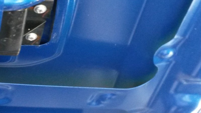

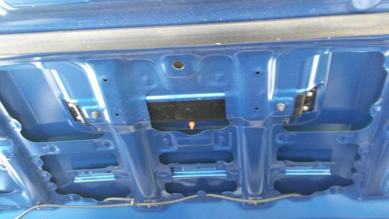

    Not seeing any of these epoxy points under my sport hood.

    Take a pic and post it.

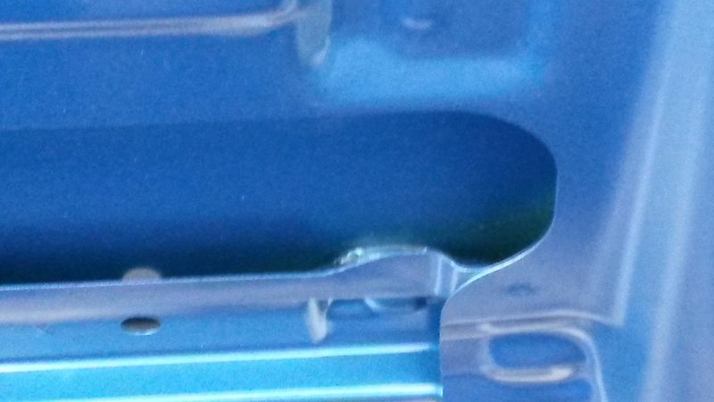

    Looks like maybe 1 in the 3rd picture

    Just lightly grab the points where the adhesive is, like in the third pic, and see if they pull away.. you'll notice if it's separated.

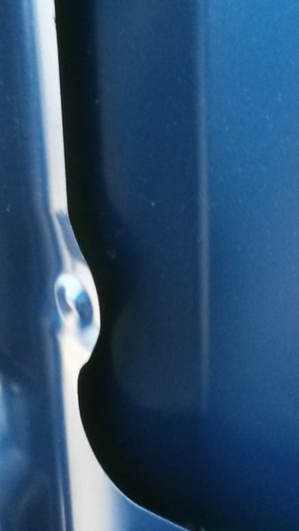

    No separation but the ends shown in pic 4 are flimsy like an empty Michelob can. Extremely thin and cheap for "braces" if they qualify as such. Now I know where to watch.

    You'd be surprised even with thin metal, the way it's bent adds a lot of rigidity to it, some places might not have had adhesive to begin with, but I'm sure if it's a concern you could add some.

    Probably buy a tube of blue RTV just in case. At least its the right color. Rigged Toyota Vehicle
