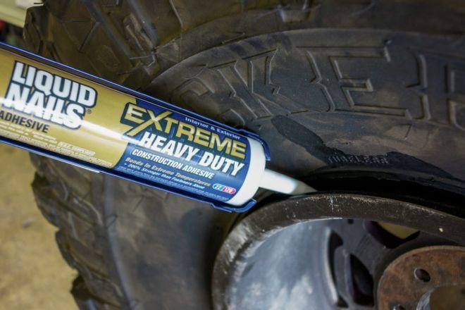

    This person used Liquid Nails all over his hood. He stated in a later post that it is holding.

    I am the guy that used it . It has been over 2 weeks now and it was per to the label , fully cured at 7 days. I painted it and it looks ok. I worried it would expand and deform the hood and it did not . I have NO more vibrating of the hood and am very happy. The test will be over winter and colder temps to see if it deforms at all .
    The label says it remains flexible so we will see. At least I do not see the damn hood flopping any more.I no longer have it ticking me off and can keep my eyes on the road instead of the hood dance.
