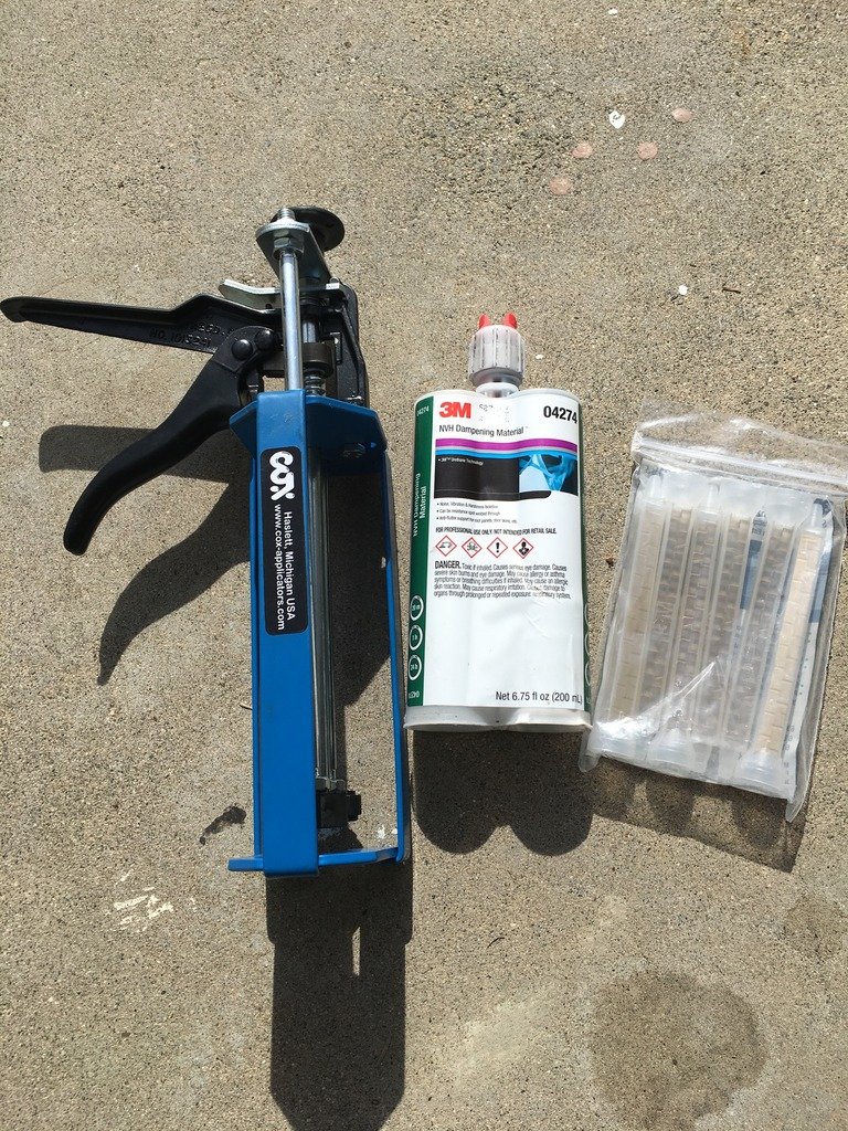

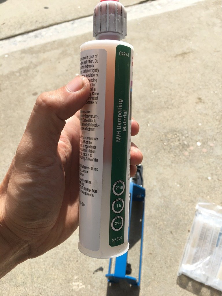

    I fixed my vibrations with dampening material posted earlier in this thread. If anyone is interested I am selling the dampening material with more than 60% left with the cartridge applicator and extra mixing nozzles.
    It should be more than enough to fix your hood (I went over all over my hood twice just to be safe)
    Total paid was around $90 from Amazon I will sell for $45 shipped. PM me if interested
