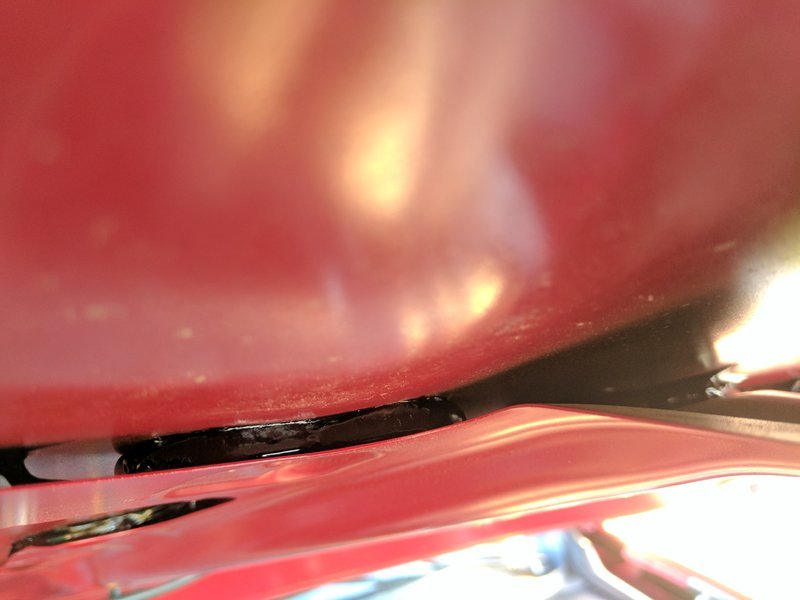

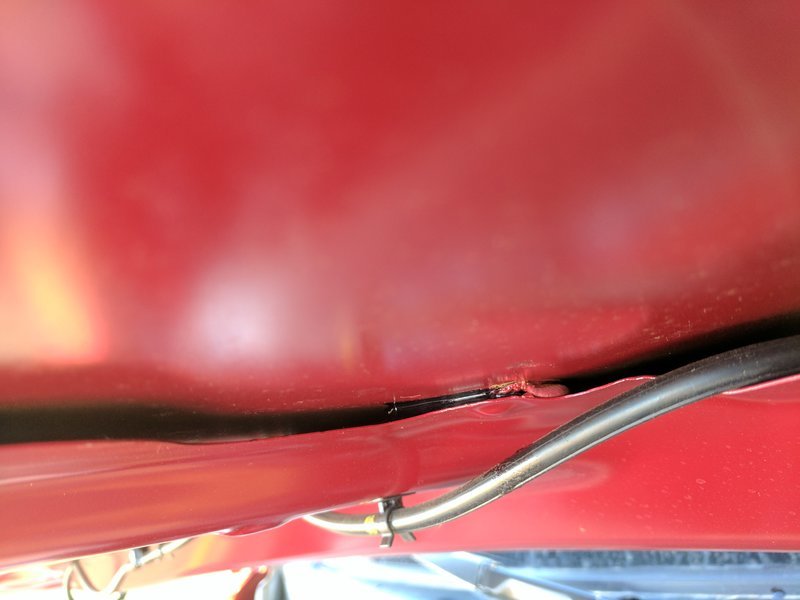

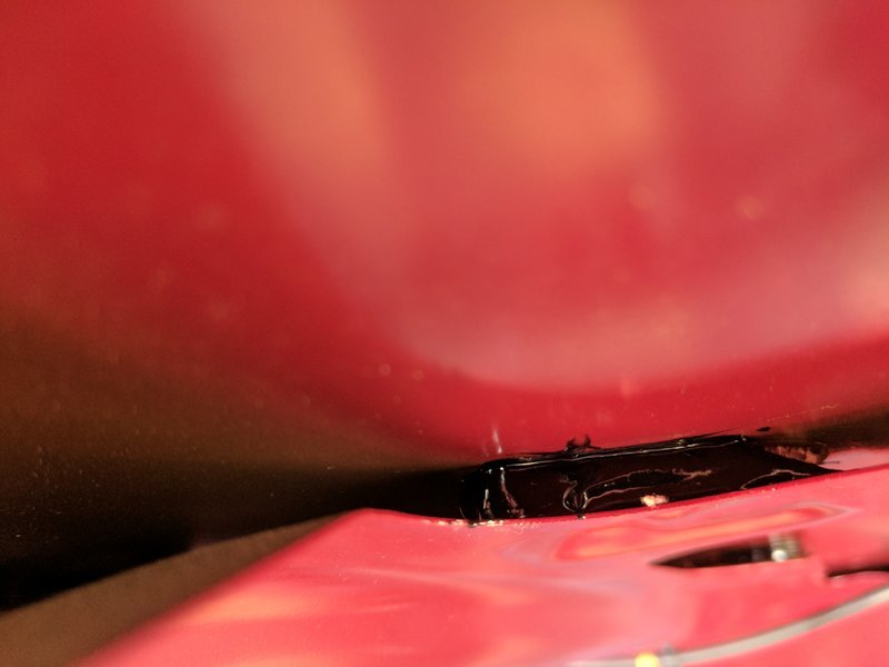

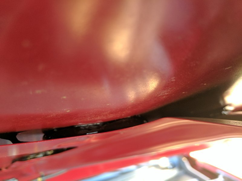

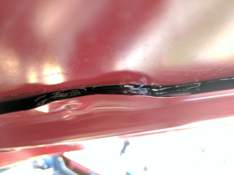

    The dealer fixed mine on my latest trip. I only had to tell them 4 times in a row. They used a black adhesive instead of the crappy white stuff.

    On my hood they actually removed the skeleton and used the upgraded bonding material and repainted the underside took 4 days. I would not be happy with that drwx had done on his hood. The hood should look like as good or better than when it came from factory.

    I'm just happy they didn't use more of the same crappy white adhesive that looks like chewed gum. It doesn't look perfect, but it's the under side of the hood and is good enough for me.

    This is rubbish. Firstly, I don't think it is even possible to separate the sheet metal from the skeleton as the edges are rolled, so the dealer may have misled you on what they did. Second, who cares what the underside of the hood looks like? I am anal about my cars but seriously, you have to accept some imperfections in a vehicle. I bet the finish on the underside of your hood is now glossier than original

    Well, you are correct matts11, sorry I, failed to describe it correctly. I don't believe they would have separated the entire skeleton, but from what I could see and the information given to me from the body shop foreman, the bonding material they they use from factory was removed. When the repair was completed, paint looked exactly like factory (no clear on paint). They don't have to go to the extent they did with my hood, but all I know is they did a excellent job, and I was extremely happy with the work. Imperfection are expected with any vehicle, my 2017 has lots of paint missing in the box area where I relocated the cargo mount system to add my box cover. I can accept the missing paint, as I am the one who relocated the tracks. My thought is when it is poor workmanship on the manufactures part and the vehicle is new, it should be fixed like it never happened. :)

    I highly doubt anyone would even look at the adhesive if they weren't a member of this forum. I'm fine with how the black stuff looks.
