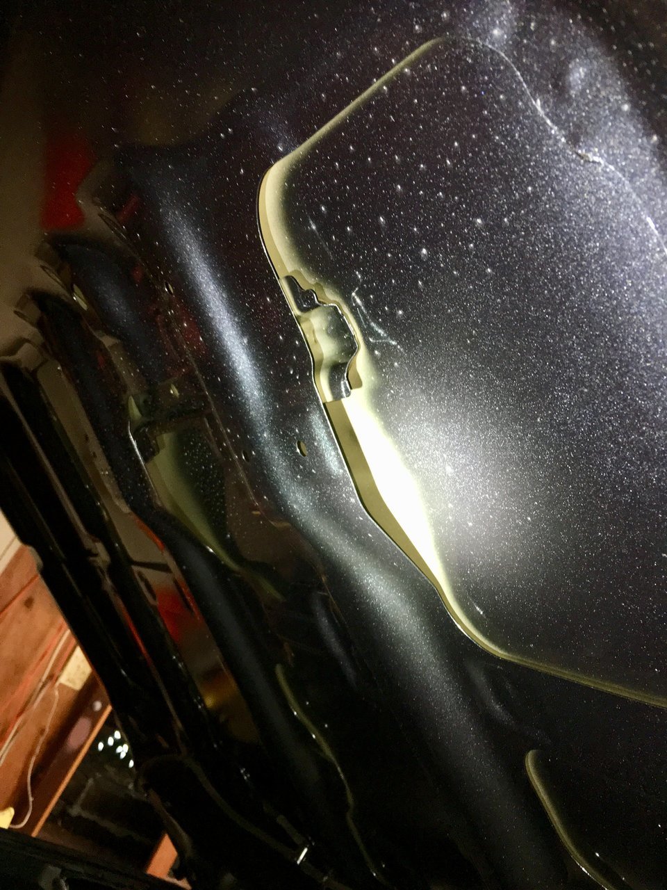

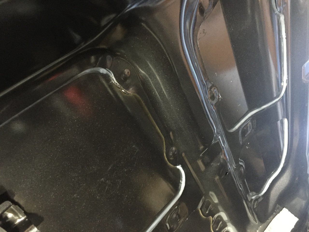

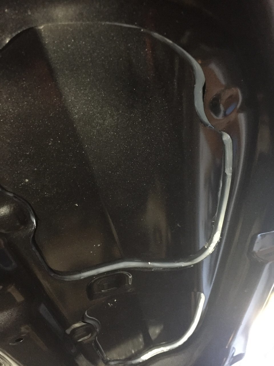

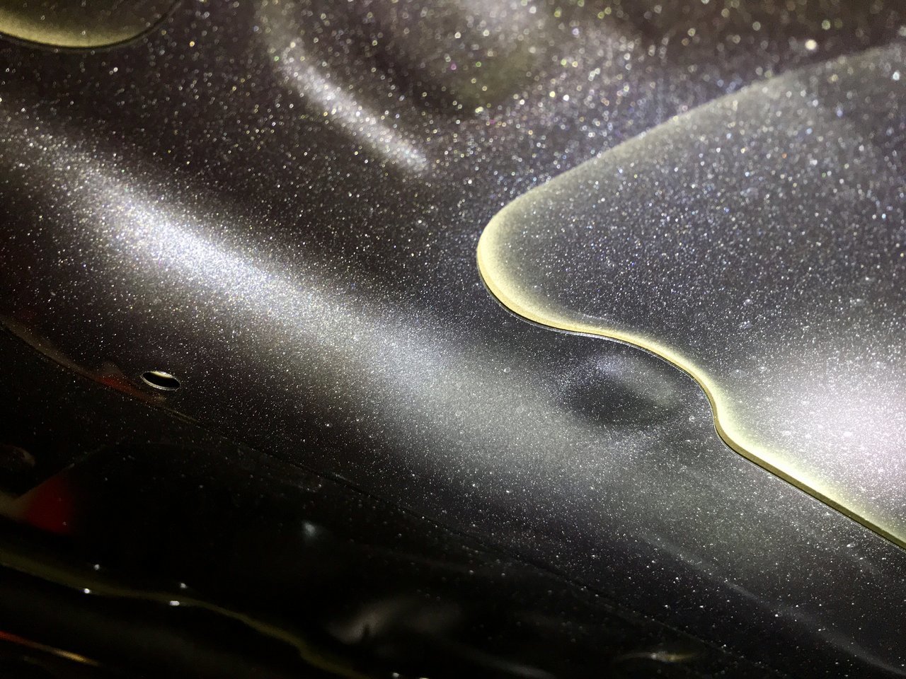

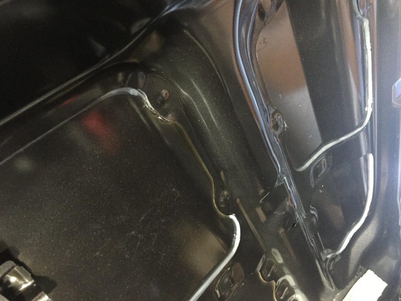

    2D432173-C165-41D2-BEE2-EB74D5421348.jpg Save yourself some time.
    This is partially done in the pictures. Instead of multiple trips to dealer and spending time waiting for a fix, new hood or repaint, I decided to fix it myself with some clear silicone I had in my garage and applied it around all bracing with a caulking gun. Went over it a couple of times to fill all of the gaps. It’s good for over 400 degrees of heat.
    Other Taco owners have done this.
    It dries clear. About $5.00 for a Tube at HD or Lowe’s.
    Keep your original paint and no worries about bulging your hood by using foam.
    No more flutter and easy to do yourself.

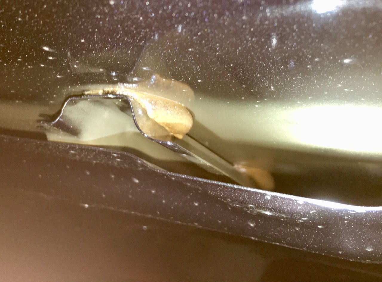

    I used Sonneborn np1 polyurethane adhesive and reinforced the factory glued spots after I saw the hood vibrate at a touch less car wash during the dry cycle.
    We use the stuff at work and it stays flexible even after 10 years. It didn't cause any sheet metal deformation during minus 10 degrees winter temps or summer heat due to different thermal expansion coefficients.
    It's paintable so I painted it with touch up paint so it blends in. I had white on hand but you can get it in multiple colors. They even have an orange that might not of needed painting with my inferno orange color.
    It's sticky so I masked before I applied. Cleans with solvent base wax and grease removers. Supposedo to wait several days before painting, I just waited a week.

    Would appreciate an update as to how well this fix (silicone) has help up over time. Did it completely fix the vibration issue?
  16. Mar 28, 2018 at 7:53 AM
    #956
    OregontoBajaCA
    OregontoBajaCA 2025 DC OR High Bread
    Dec 6, 2017
    #237812
    850
    2025 OR DC iF Max
    Yes, it completely fixed the vibration/fluttering of the outer skin of the hood.
    The silicone is still holding tight.
    Pictures were taken before job of filling seams with silicone was finished. I went back over it and made sure to fill the gaps I had left.
    Of course it dries to clear. 03D53168-D2BC-4B1B-8B20-57F932ED1910.jpg 59E99762-1A81-44DD-9C11-94CFB1E2D50F.jpg
