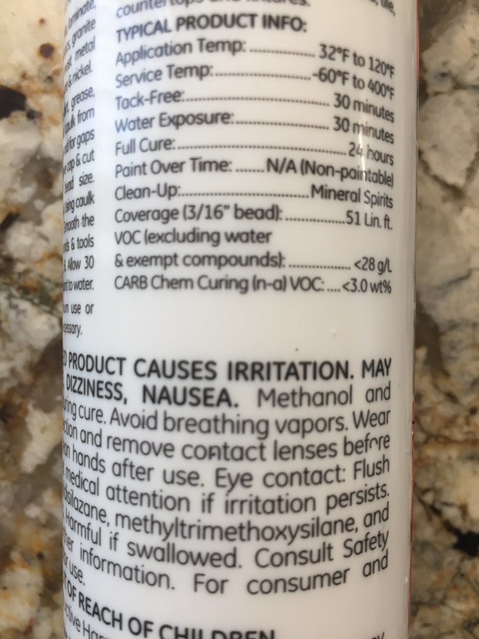

    Anyone else use a clear silicone like OregontoBajaCA? If so how did it turn out? Any issues in very cold environments (below zero) or very hot environments?
    Considering this fix.

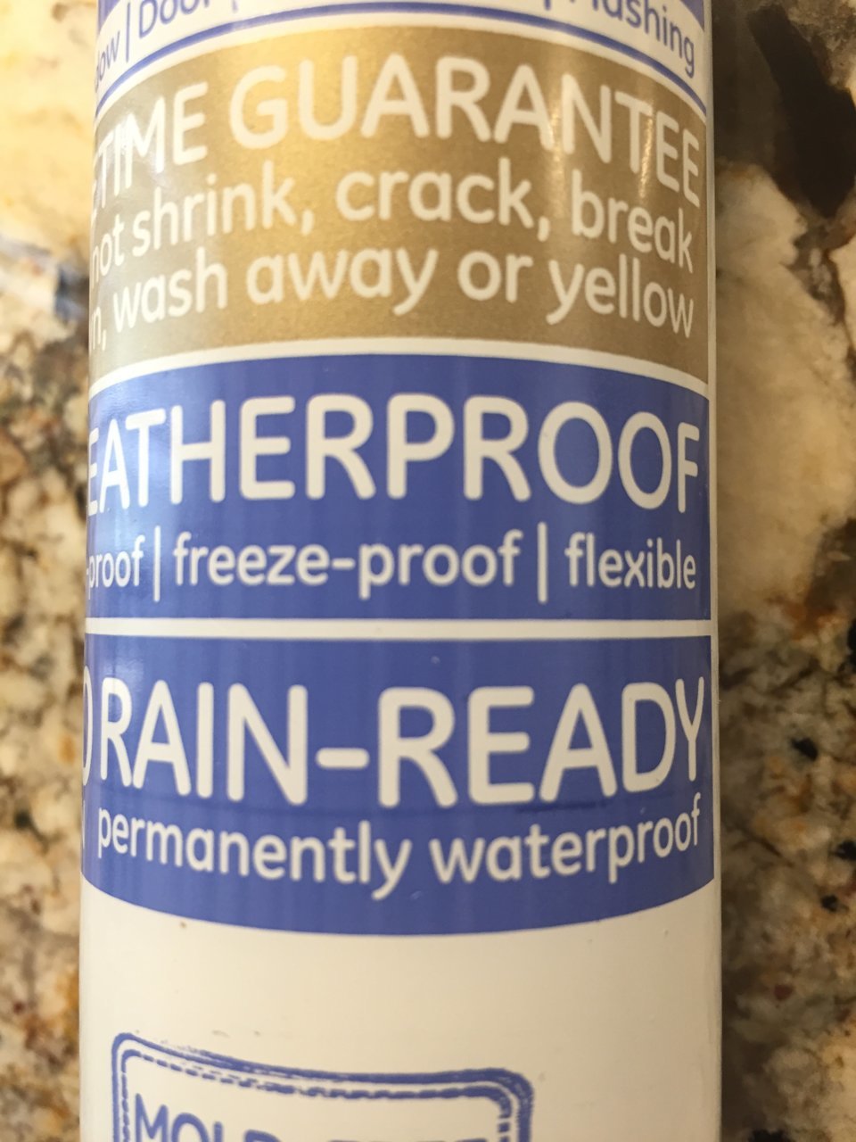

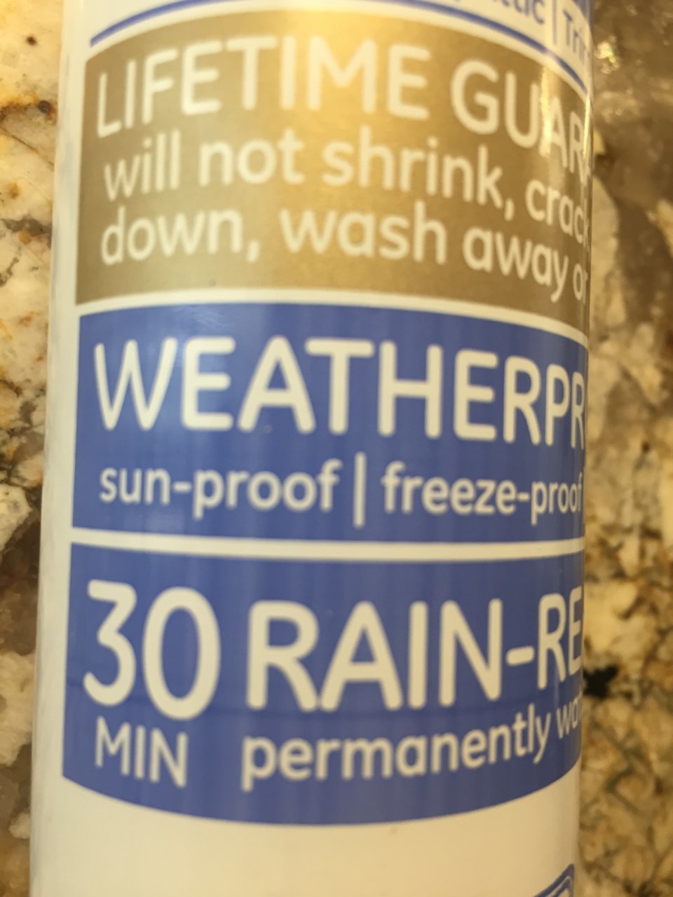

    OregontoBajaCA
    OregontoBajaCA 2025 DC OR High Bread
    Dec 6, 2017
    #237812
    850
    2025 OR DC iF Max
    It’s cost effective, easy to work with and sticks well to smooth surfaces. 4A99B216-97D7-404B-83A5-2E89D4F0ABB1.jpg 8EEA45A1-0BF1-48C1-A0D0-1A99F511C4D0.jpg 8C51EC4E-0810-4AA7-A1B0-79E679454276.jpg

    Nice I'll give that a shot! I assume any 100% silicone caulk/sealant will work? My worst fear is dimpling or creating dents, especially during the cold wisconsin winters.
