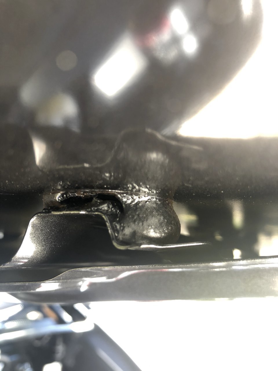

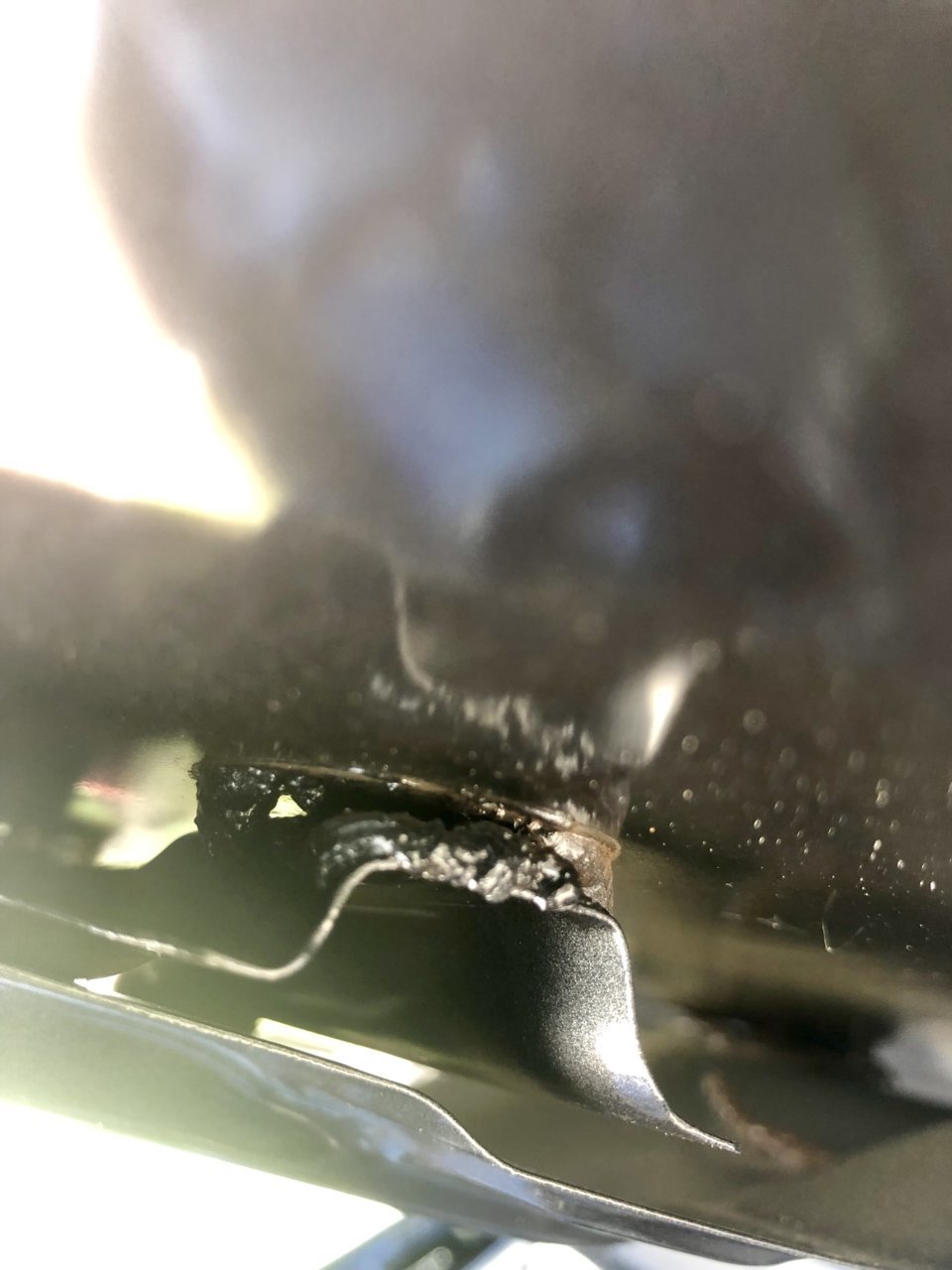

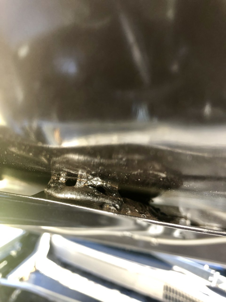

    I am sorry, but that looks like crap. Ask them to remove all that foam and clean it up. Go to your nearest auto or home improvement store and pick up a tube of "Amazing Goop" https://www.lowes.com/pd/amazing-go...Bs9JgCLnnpmmp5OyDMC9sNo_1u5FYfeBoC9qcQAvD_BwE and do it yourself. I did mine and it looks and works great!
    Ps. I wouldn't want to have anything resprayed or replaced. They will not be able to match OE exact color and depth of the paint. So anyone with the paint meter will be able to tell that the hood was repainted or replaced, IMO.

    I have to thank Tacoma World and this thread.....because if I hadn't known about this possible issue I wouldn't have known what to look for when I noticed the hood of my brand new 2019 TRD OR fluttering on the very first drive home from the dealership.
    I called my sales rep the second I got home and told him what I saw....and I also confirmed that I would say 50% of my glue spots had released between the hood skin and support struts. Sales rep told me to bring it in the next morning to service and I did. Service confirmed the problem, then they sent my truck over to the Toyota Body shop for a second opinion. They agreed that the hood was not manufactured correctly.
    The body shop offered to get me a replacement hood right away. Of course they said they would have to paint it to match my quicksand color, and also repaint the front clip of the truck to blend it in properly. I said NO WAY was I gonna agree to open up OEM factory paint on a truck that was one day old off the lot brand new! Body shop manager said they could do an awesome job, but he agreed nothing is like factory paint. So he walked me over to voice my concern to the Dealership manager. Management agreed with me and said they would do what ever it takes to make me happy. They asked if they could find me another new truck, same color and options of the one I just bought, and have it brought in.....would I be willing to do some paper work to switch them out? I told them absolutely that would be a satisfactory solution (assuming the hood of the new replacement vehicle was manufactured correctly and I was going to inspect the heck out of it).
    It took about a week for them to find the exact configuration and color I wanted, but they did and had it delivered. They even let me keep driving the new truck with the bum hood till the new one came in. I offered to take a rental but they were more than happy to let me keep driving the truck till my new replacement was there.
    In the end they delivered as promised. The new replacement truck had a hood manufactured correctly and we did the paper work to switch them out in under 20 minutes (they had it all ready to go when I came in). The replacement truck even had a few dealer added options on (that my original new truck didn't come with) that they weren't going to charge me to cover the inconvenience of the whole thing (the replacement truck came with the emblem black out kit and TRD Performance exhaust).
    I feel for everyone having to fight and go through all that hassle with the dealers to get their problem fixed. I was lucky my dealer really delivered and took care of me. Hope all works out for those still going through the process.

    Update: got truck back on 03/01. They cleaned up the goop, applied the 3M adhesive in many of the "cracks" and repainted the underside of the hood. Vibrations gone, and it looks good underneath. However, I noticed yesterday after a long drive that "depression spots" have formed in many of spots where they applied the adhesive on the underside. Taking it back on Monday. I'm so over this. Had the dealer fucking done what I initially asked (replaced it with a Sport hood), we wouldn't be in this mess. They may bitch and and moan about replacing an OR hood with a Sport hood, but I feel like at this point I'm owed something for the inconvenience. Any tips for people who have successfully resolved this issue?

    I added about 3 tubes of black rtv silicone to the under hood bracing and it no longer wiggles.
