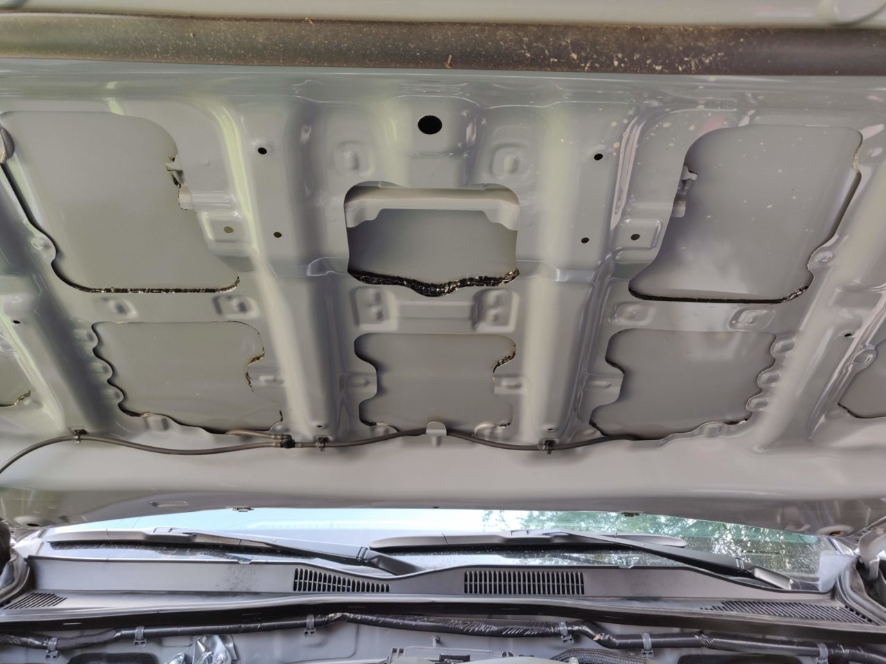

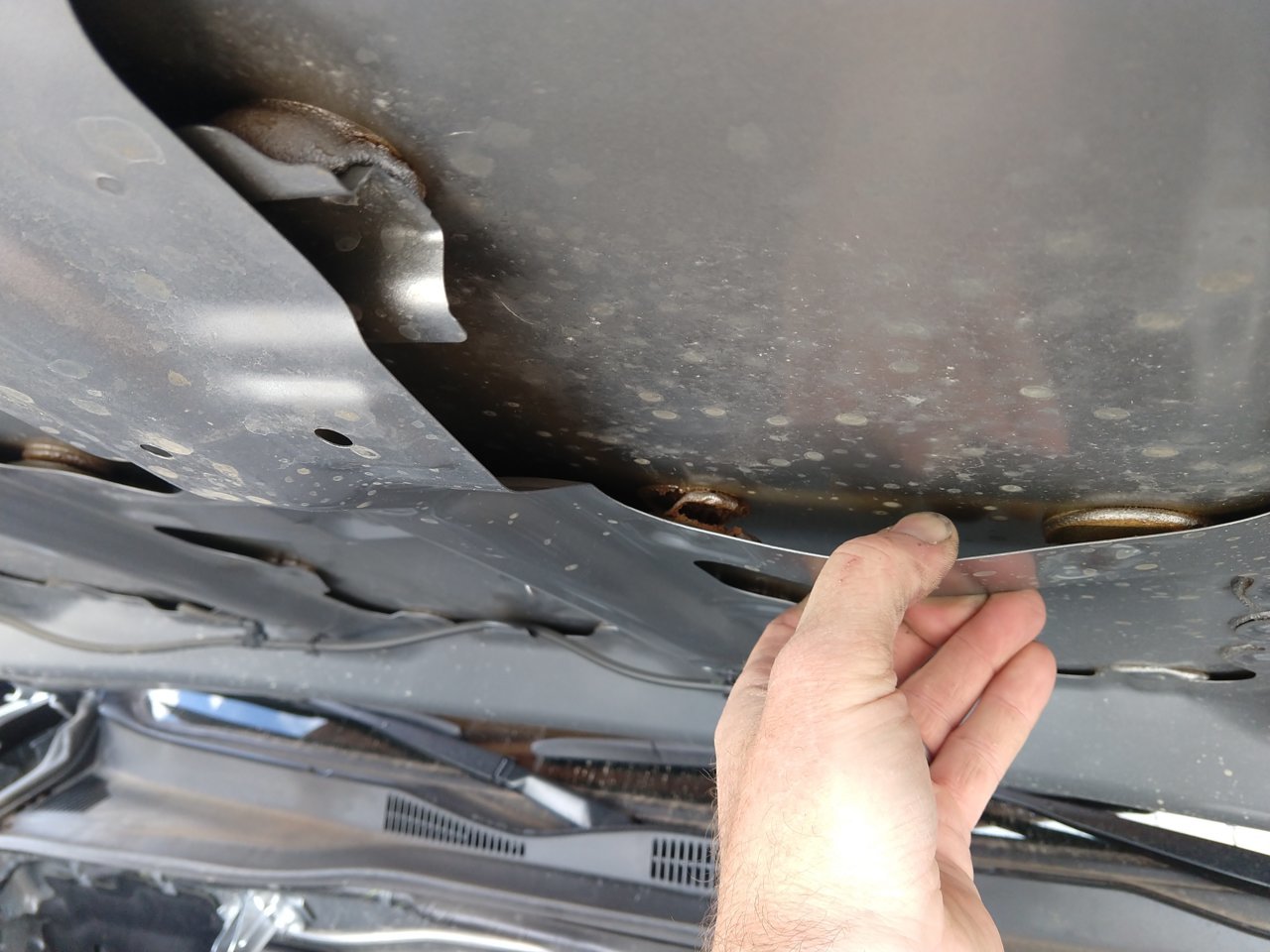

    Noticed more hood flutter over the last month. Top pic is last week, bottom is end of AprilIMG_20190514_143257548.jpg IMG_20190414_112813996.jpg

    :annoyed: 19’ OR and I’ve noticed this!! :angrygirl:
    I’ll check the adhesive under the hood tomorrow :anonymous:

    If you DIY don't use anything stiffer than NVH. It gives so that the metal doesn't crease when it flexes.

    Think I notice my 19 doing it. Maybe take some black rtv and hit up some spots

    Took mine to the dealer and explained everything, and the fix. They just called me and said all their trucks do this and there is nothing they can do haha

    350 miles, same issue here. Took it to the dealer and they said to bring it in and they would re-glue. Going to do it and see if what they use is worth it. Really don't want a new hood, where they have to blend in the colors from it to the fenders.

    I decided to do it myself (had the issue in the first month) and NVH'd the living hell out of mine;)
    Interestingly enough, it still vibrates ever so slightly when a lot of buffeting is going on (behind a semi for example), but the joints are very secure and I'm not worried about the hood coming apart any longer...

    Its designed to have some give. Like how a skyscraper moves in the wind a few inches. Bend so it doesn't break.

    Well yes...the material is reasonable flexible itself of course...but nothing much moves when pressing on the hood. Shows you the forces in play..

    Hell no! They replaced it with a new OR hood, but it looks like it has the beginnings of the separation issues already.

    Welp, it's going to the body shop on the 7th for a silicone job!

    I'll see how long this repair lasts, they added sealant in between the failed stuff.
