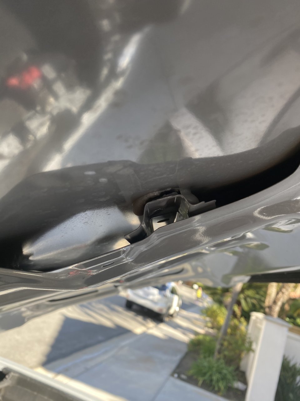

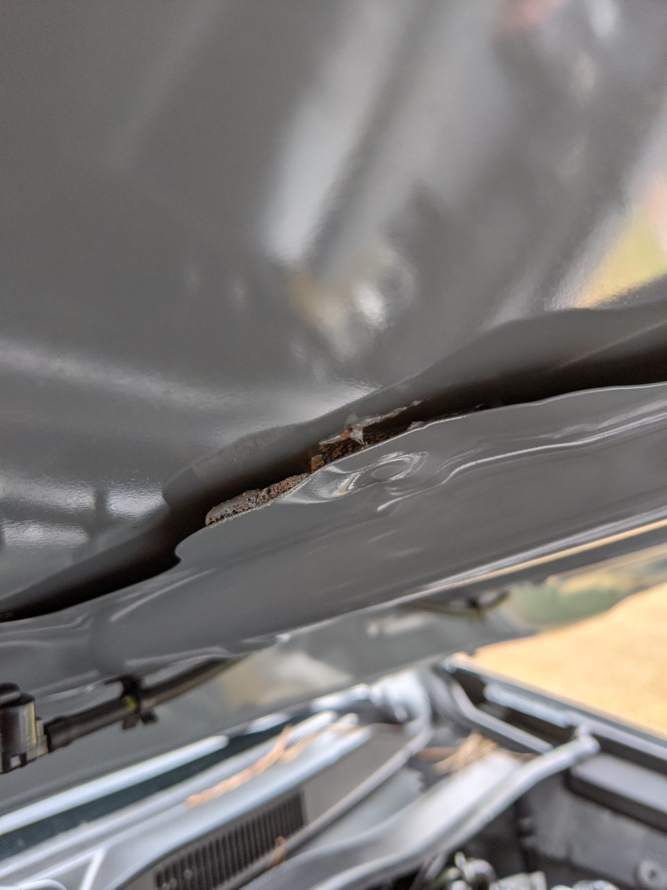

    18 tacoma limited here. Noticed several sections of the glue seperating on my hood at 5K miles now..Called dealer and got the "First I've heard of this" answer

    Took it up today to have them check it out..More glue had let loose than I had realized. They are contacting Corporate for instructions. I really hope I'm not without a truck for a couple days for this

    I just got my truck back from it’s 10k service and I had them look at this exact “problem”.
    They didn’t give me any run around excuse at all, they have seen it before and said they filed a claim with Toyota and are waiting for an approved fix.
    My technician said he would love to just add some glue or foam in the gap but they are not approved by Toyota to preform such a fix. He recommend finding a DIY fix on the internet while we wait for a response.

    Got a call from dealer. Toyota approved the fix so my 2018 Limited is headed to a body shop to be fixed once they get a loaner back in for me. I have to wonder if this is caused by them not having a hood liner anymore and the heat breaking down the flutter foam? Anyone with a hood liner have similar problems?

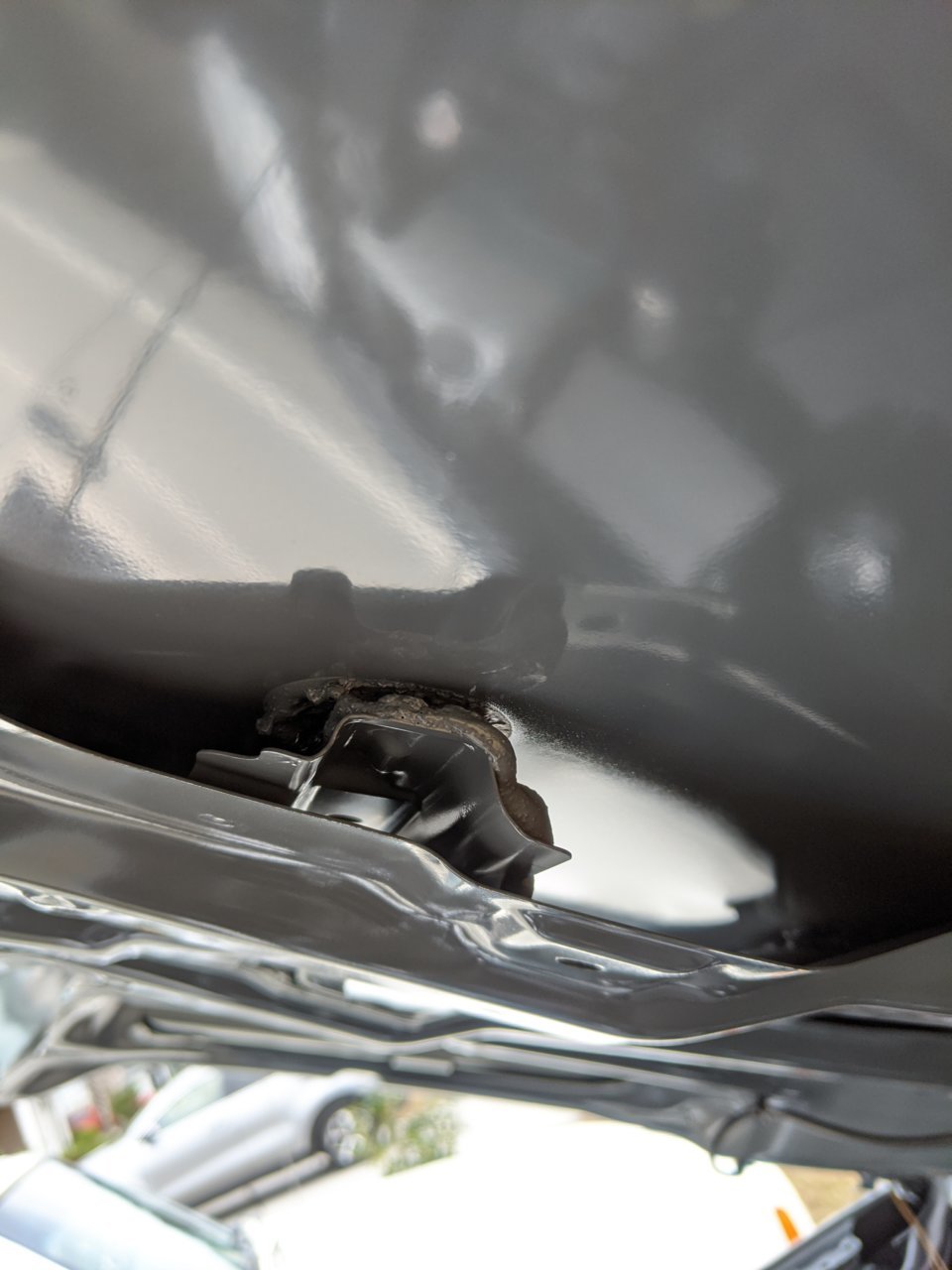

    I just bought my 2020 OR in November. 1,500 miles now and have noticed the hood vibrating on the highway since the day I drove it off the lot. Guess I'll be checking under the hood in the morning...
    Blew a tire at 300 miles, cracked my windshield at 1,400 miles, and now I find this thread :rofl:
    Bleep100 likes this.
  20. Jan 9, 2020 at 11:10 PM
    #1060
    SDRider858
    SDRider858 Well-Known Member
    Oct 4, 2014
    #139663
    134
    San D Aygo
    2019 DCSB OR 4x4 cement
    Same here, I’m happy but sad that I found this thread. I have a 19 OR with less then 2k miles. I looked under the hood and saw this shit.
    I’m in San Diego, anyone local have a dealer that has dealt with this successfully?
    This is my primary gripe with the taco right now. 40k truck shouldn’t have this issue.
