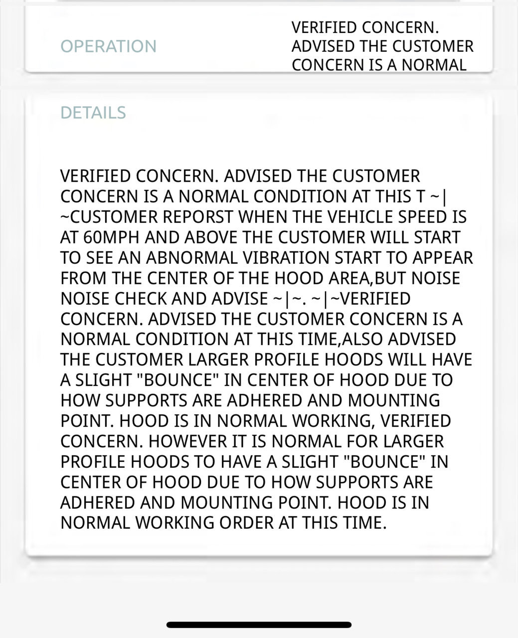

    3DF8E080-DFB4-4B67-9BC5-81508D732C36.jpg Welp, I just checked what they wrote down on my invoice and here is my dealerships notes..
    it makes me wonder if they even submitted a complaint to Toyota but I will file my own report with them to be on the safe side!
    I agree, if we pay 40k for a truck... if like my hood to at least be attached a bit better.

    My dealer contacted Toyota and got the approval to fix it by sending to outside body shop...it's NOT normal its failed flutter foam
