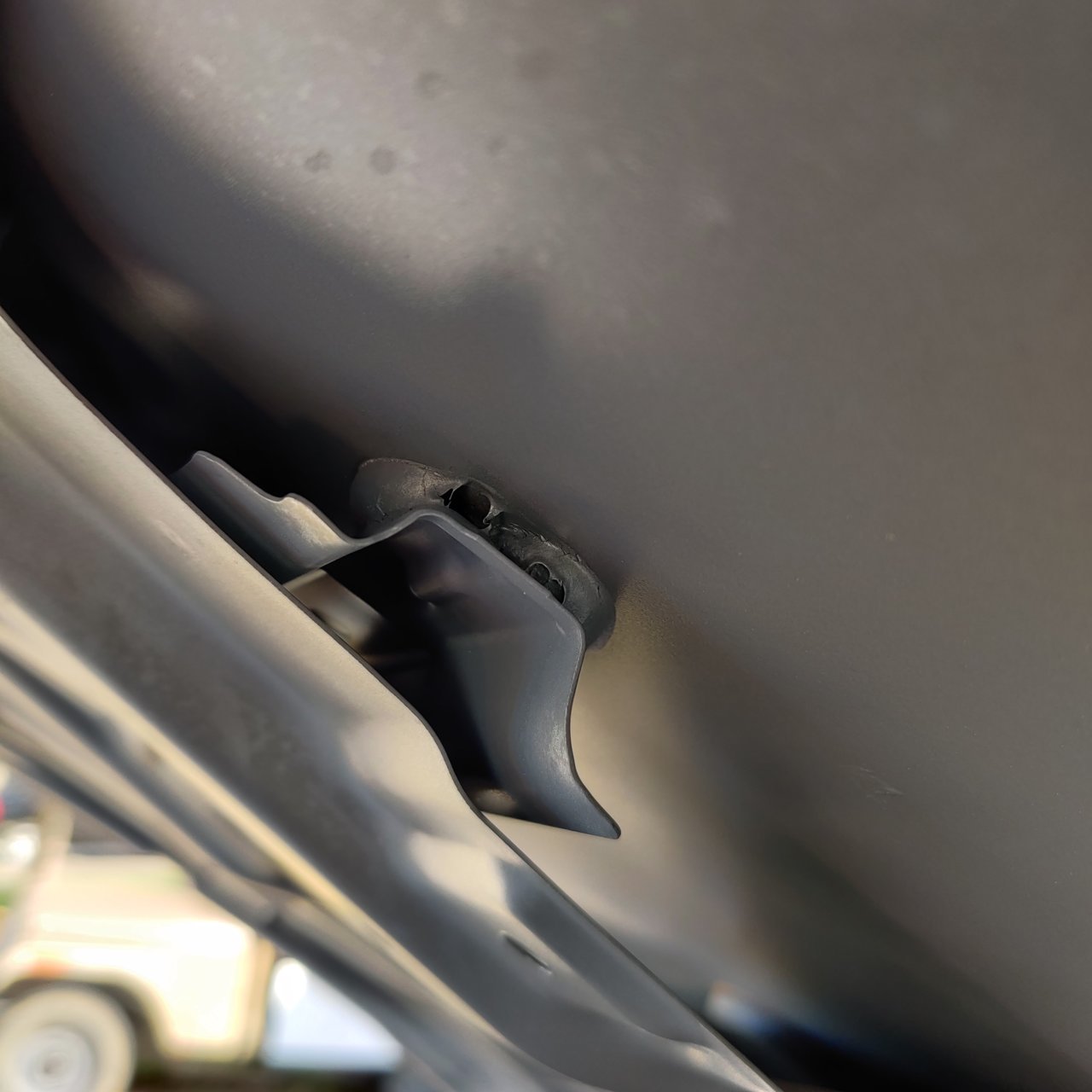

    Curious how well this one's going to work..

    You should be ok, the scooped hoods are stronger and dont flex as much as the non-scooped ones.

    I don't have a scoop.
    5nahalf[QUOTED] likes this.

    Your right! I saw the metal part in there and thought that was a scoop part.... guess your screwed like the rest of us :(

    Make sure you use something that doesn't shrink when it dries and is sturdy but remains flexible. (You don't want dents where you bonded the hood and brace together) The 3M 4274 NVH is what most of us have used.

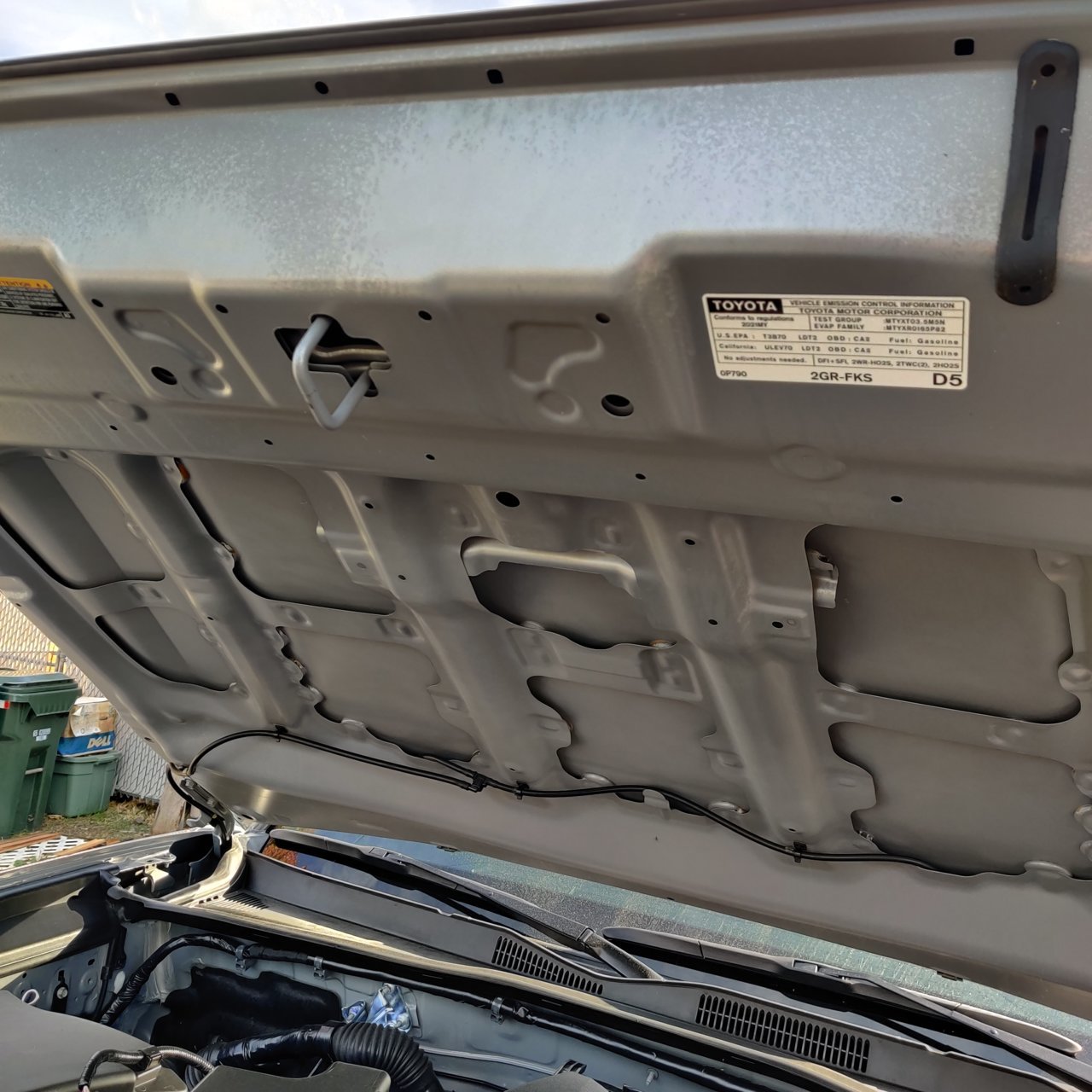

    Wait this is a thing? I’ve been on this forum for a long time and never heard of this. The hoods on both my 2016 and and 2020 had a slight flutter in the hood at hiway speeds from day one. I’ve never noticed such a thing in any other automobile, but I still figured it was just a idiosyncrasy not worth worrying much about.
    Do I assume correctly that a slight flutter is normal and that the people getting their hoods replaced had a great deal more flutter?

    Yep, toyotas plan to use 2 layers of tinfoil for the hood instead of actual sheet metal make them flutter super bad. Going through car washes with blowers that blow down on the hood speeds up the glue failure.

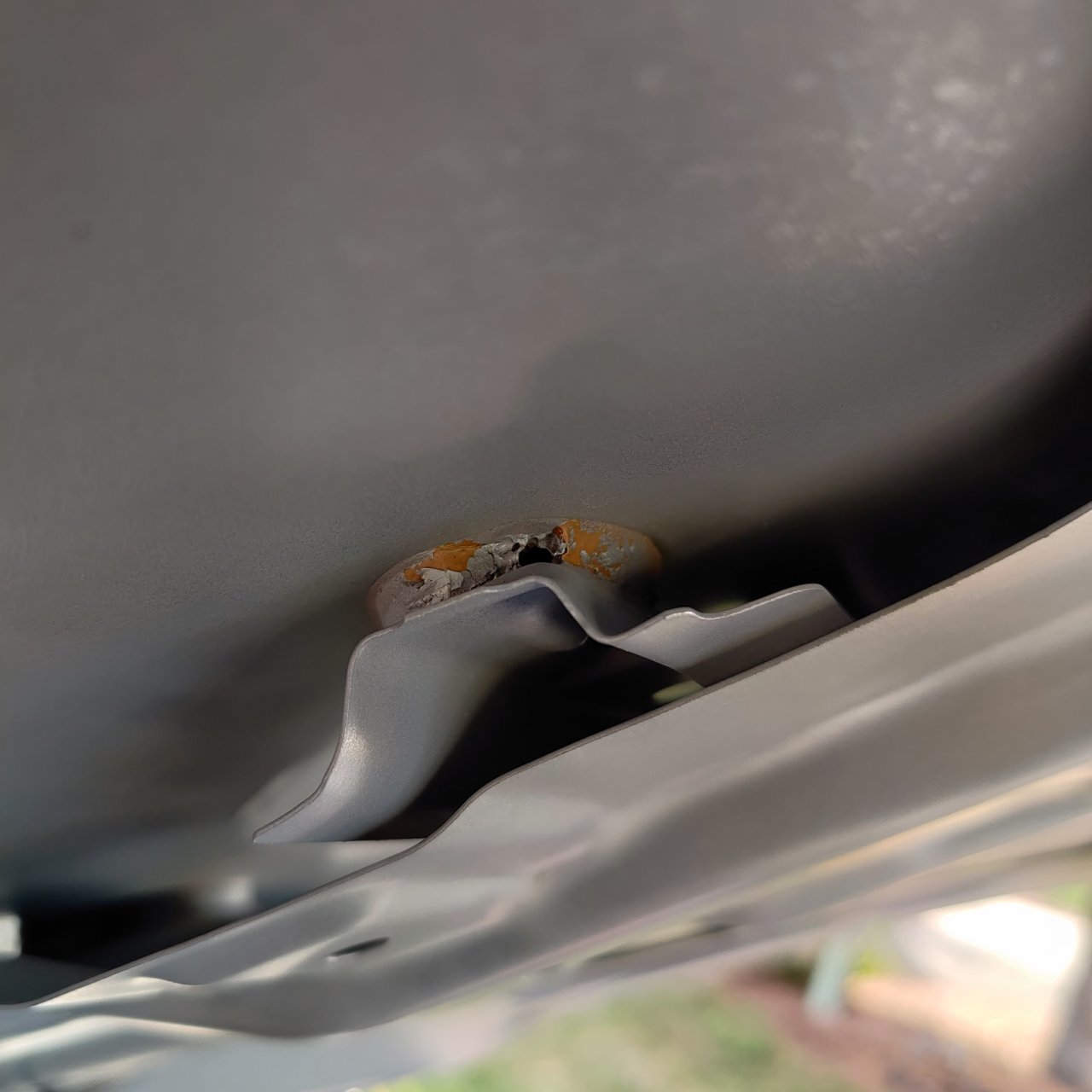

    I got curious and inspected my hood. There are few places where I would expect there to be adhesive where there is none. I don't know if it fell off or was never there. I suspect never since the hood has fluttered since day 1. The net result is that there is a gap between the brace and the top of the hood. I don't think it bothers me enough to spend time fixing it. I've got more exciting projects planned. Maybe if it gets worse I will reprioritize it.

    When you do, pull the tailgate skin and hit the spots there. The same foam adhesive is used with the same failure rate.

    if you add more sealant make sure to use the right stuff (3M NVH) or it can cause dents in your hood. you want a flexible material that can move.
