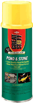

    The spray foam idea is looking better and better to me. Just a few extra dabs here and there.
    I'd rather do that them have my hood damaged and repainted honestly.

    not a chance in hell I'd put that there.....the distance between the brace and the sheet metal is like 5mm at most, that would most certainly expand and cause bumps in the hood.
    honestly it's under warranty, they are obligated to make it good as new, as irritating as it is, and I'm the one who they tried to give my truck back with a dent in it, they'll cut the adhesive off re-do it, let it cure properly and it will be better than when it was new. That area on the driver's side is not the only side that was missing adhesive, there were several spots on my hood...just my 2 cents
