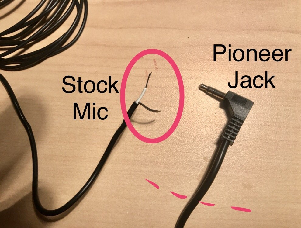

    Rjm... do you have a diagram or pics of what you did for the factory mic retention?
    Thanks

    Its super easy just cut and strip the stock mic wire and then do the same for the jack side of the new mic. Once stripped solder the 2 ends and cover with black electrical tape or heat shrink. See pic below.
