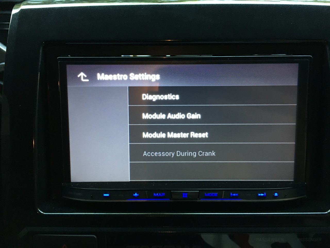

    Does anyone know about the Maestro RR setting "Accessory during crank"? This option is grey on my menu, but I would like to enable it. Also, how did you integrate factory Aux cable using TO1 harness? There's an RCA Aux option and a 3.5mm aux that comes from the RR module.

    I didn’t notice the accessory during crank setting. Where are you seeing that? That may be for vehicles that do not have an accessory wire at the stock radio harness.
    Why do you want accessory lead to be powered during crank? It’s generally not preferred, because the starter needs all the resources to start the engine.

    The "Accessory during Crank" is in the "Oem Settings" on my pioneer menu. You have to navigate to the Maestro RR settings and under those options somewhere you'll find the "Accessory during crank". I don't think the issue with powering accessory during crank is to help the starter; it's likely b/c the starter drops the voltage quite a lot and the accessory circuits aren't designed to be fully tolerant to this brown out.
    I would like to see if anyone with a Tacoma can actually change the "Accessory during crank" option because I can't access this option in my module/firmware; I don't like how the radio reboots when I start the truck.

    It has nothing to do with accessory tolerance to low voltage. The function of an automobile is transportation. In order to transport, the engine has to run. For the engine to run, it has to be started. There are also control units that must be powered, like the ECU that runs the engine. Starting and running is primary, accessories are secondary.
    If you absolutely must have the radio on while cranking, just run the red wire of the TO1 harness to the red wire w/black stripe off the ignition switch.

    I know how to wire it off a 12v source that persists through the crank. I’m asking if anyone else see’s the maestro “Accessory during crank” feature. It is a feature that comes with the module.

    I opened this thread asking about "Accessory During Crank", but I still haven't gotten a response. http://www.12voltdata.com/forum/viewtopic.php?f=405&t=18471
    I ended up calling Maestro and they claim the "Accessory during crank" feature is disabled for the Tacoma because it's not possible to do. I think it's more likely that it wasn't convenient to do, but at least we know what the deal is.
