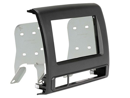

    You will need a dash kit. The kit I used is a matte black, but the main reason I went for it is that it is the only kit I found that has real metal brackets. Every other kit MFR I found had brackets made of flimsy plastic.
    https://www.scosche.com/2012-toyota-tacoma-double-din-and-din-with-pocket-in-dash-install-kit

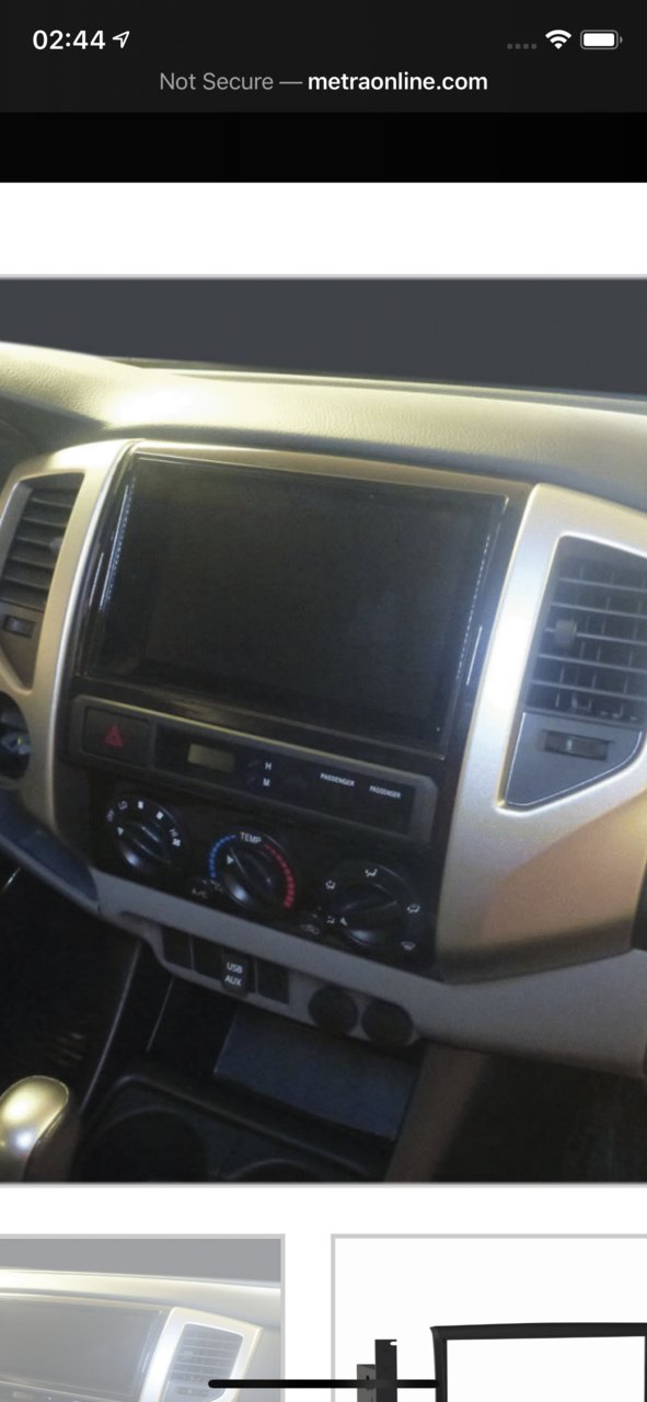

    Is this the one you used to fit that head unit?
    http://www.metraonline.com/files/products/99-8235_PRODUCT_SHEET.pdf
    also curious about how Apple CarPlay works on this unit. it says wired in the listed features does this mean you have to actually plug the phone in for CarPlay to work?

    I found what I was looking for and finally found the head unit that meets my wants thanks man! Pic is the DMH-C5500NEX installed (not my truck)
