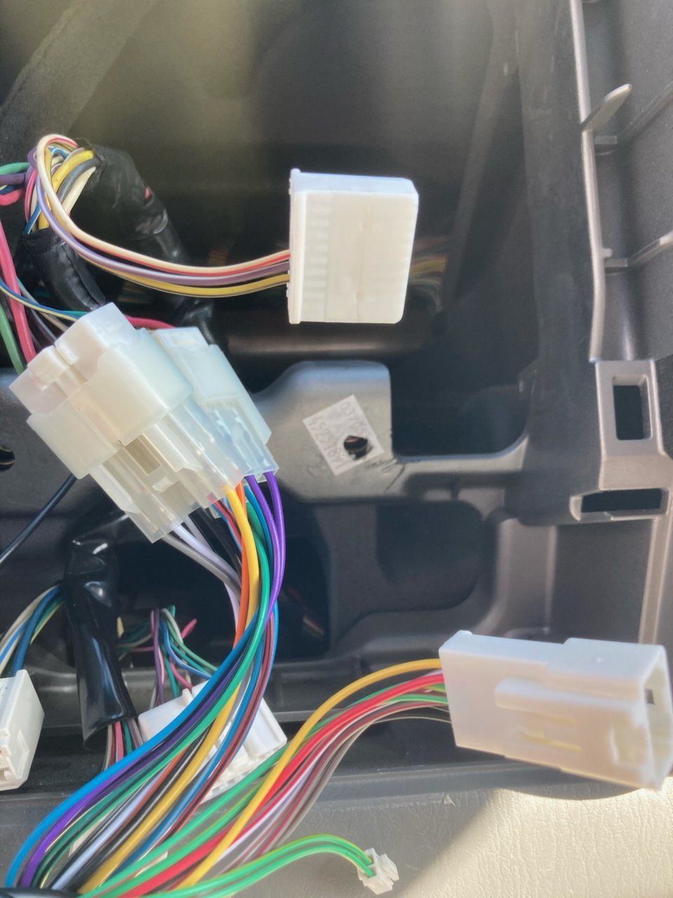

    I've arrived here. In the second pic you can see the connections to the truck, but what I take to be the SWC harness is not connected to anything. I don't think I need to use the 20 pin, but what do I tie the three OEM wires into?
    The stereo works, reverse trigger works, SWCs do not.

    Did your RR not come with two plug options? I believe it should have a 20-pin and a 28-pin plug, and only one of them fits, and you toss the other one

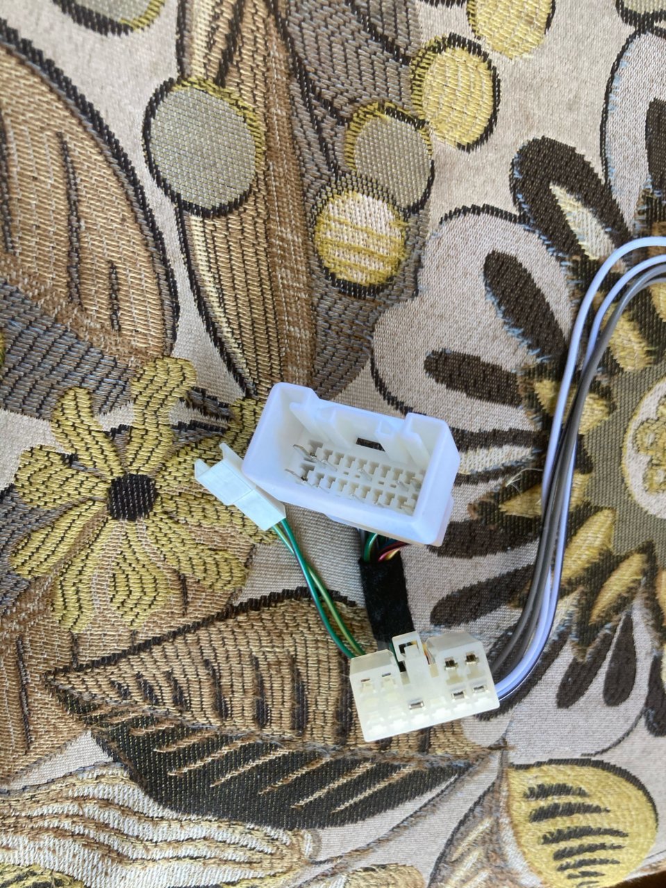

    This is the other I have, but it won't connect to the truck. The second pic is the leftover wiring.
    Do I need to pull wires from the T01 harness and solder em in?

    Pretty sure you need this connected

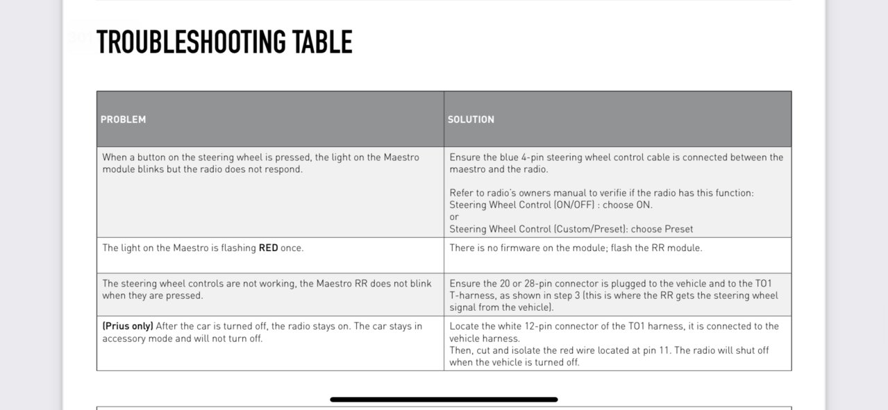

    Make sure when you flashed the module, you selected the option for wired input and not serial data.
    And check these tips

  15. Apr 18, 2021 at 5:39 PM
    #155
    Taco 422
    Taco 422 Well-Known Member
    Feb 24, 2020
    #320258
    957
    USA
    Gen 2 AC v6 TRD SR5 Prerunner

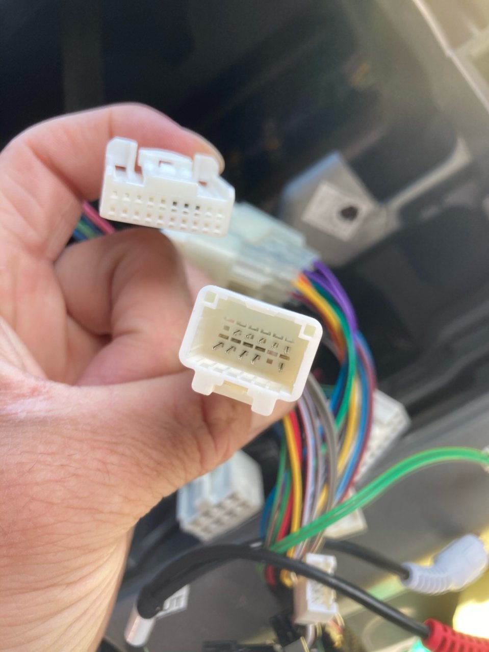

    I've got reverse sense (obd connector routed) but still no steering wheel input. I think this 20 pin harness is to blame.

    There should have been a connector that lines up with that

  18. Apr 18, 2021 at 5:48 PM
    #158
    Taco 422
    Feb 24, 2020
    #320258
    957
    USA
    I looked on the chair I randomly use as a shelf and found it. I owe you a beer.
