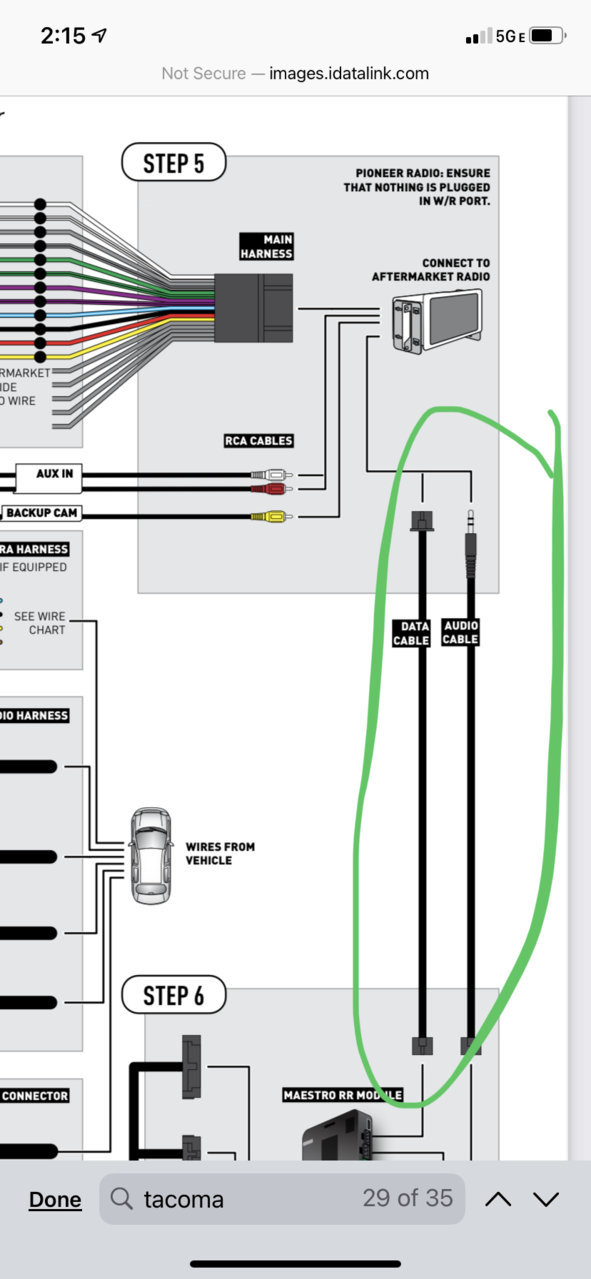

    Went through the exact same thing yesterday. Kept getting the 2 red flashes and it was the data cable that was missing. After that, everything worked fine. Was able to mirror the camera from the Rear View mirror to the radio by running and RCA from the deck to the plug near the fuse panel in my 2010. I'll be doing a write up on that and the complete build once i get some more free time to type it up good.

    Between the number of cables that just were not used and the kinda poor instruction as to where that data cable went this was a fairly frustrating install. Looking forward to adding amps soon.

    I mean it shows the data cable being utilized

    Yep, i had mine sitting on the workbench and didnt grab it while connecting everything until i was getting the 2 flashes.

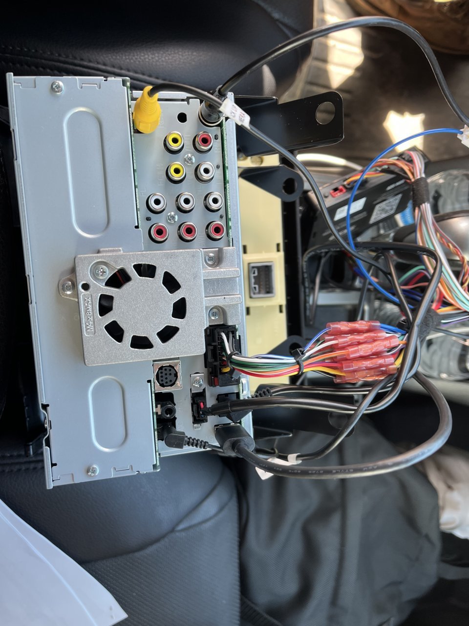

    On the back of the Kenwood unit the markings are....poor. I had the cable plugged in on the other end to the Maestro but reading the proper port is best left to someone with younger eyes than me! LOL!!!!

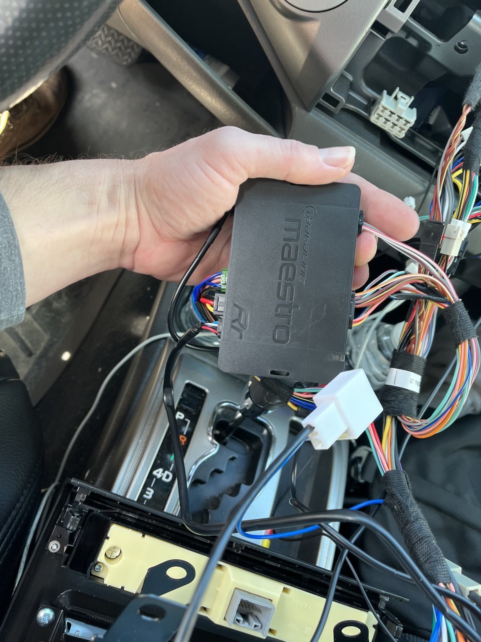

    Got some stuff in the other day for the stereo. THis is why I hate vehicle electronics lol. I opened the datalink, vehicle specific harness and radio. I've never seen so many wires. I think I'm going to just have someone do this install. Way too complicated imo. I'll stick do mechanical installations hah.

    Looks kinda intimidating. You won’t use all that wiring. Lay it all out before you install. Do all your flashes etc. Makes it easier to get your head around. Plan for lots of time. You’ll be fine. :)

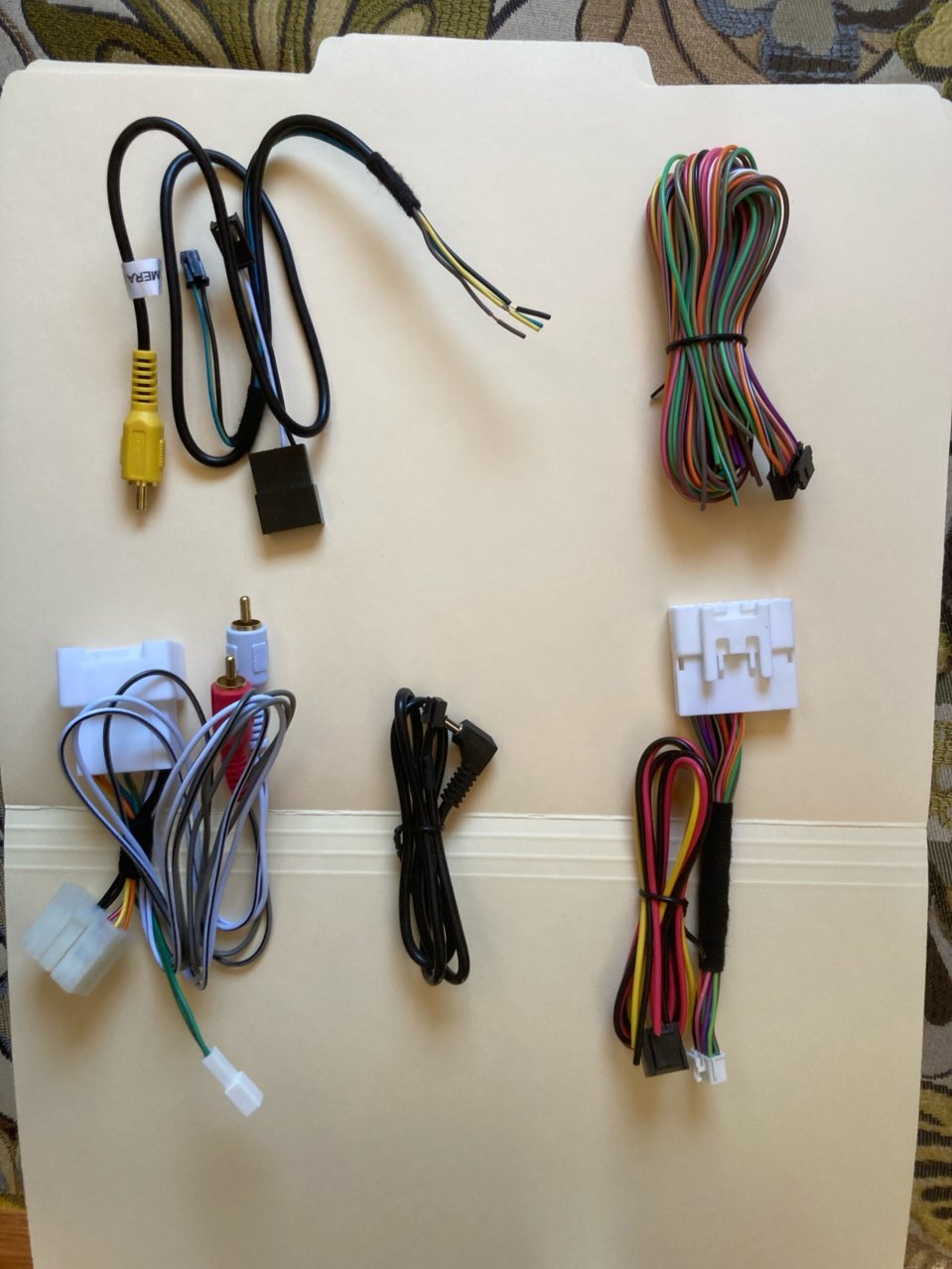

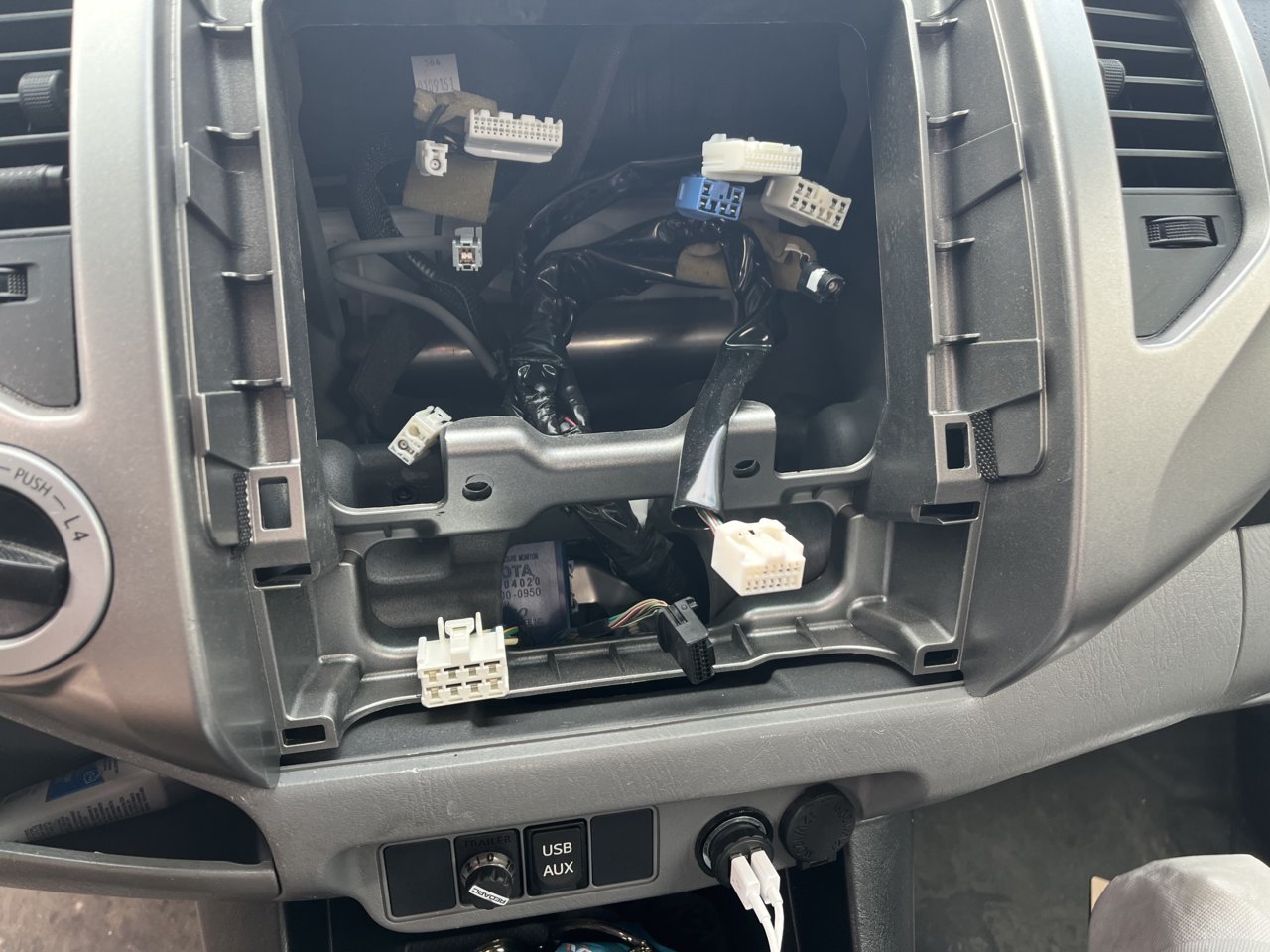

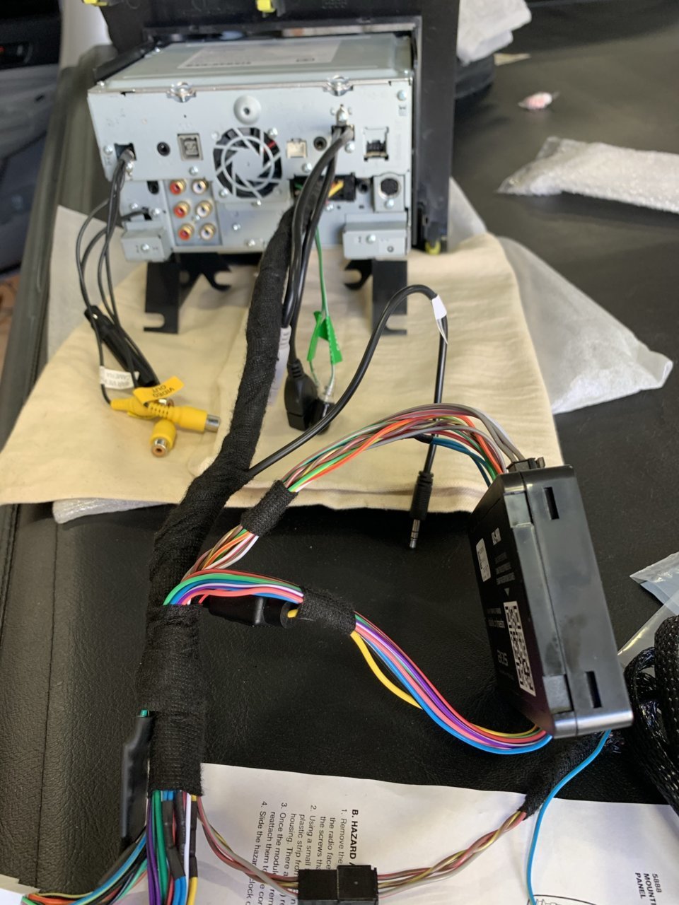

    Installed the Pioneer DMH-2660NEX with the Maestro RR on my 2015 non-JBL application. I also purchased the wiring harness, all the appropriate adapters, to include the HRN-RR-TO1, USB and antenna, and the Metra 95-8235 Dash Kit. Skip the Metra 95-8235 Dash Kit, it’s junk and go with the Scosche TA2111B, Crutchfield has awesome customer service and refunded the cost associated with the Metra kit. I also opted for the Crutchfield ReadyHarness Service for $25 where they crimp all connections that need to be connected, totally worth it, I’ve wired and crimped stereos in the past and it’s a tedious process in IMHO and the Crutchfield crimps were quality.
    Everything works, camera, OBDII features and steering wheel controls. Follow the Maestro RR wiring diagram specific to your vehicle and head unit and you’ll be fine. Make sure you flash the Meastro prior to install. I included some pics.
    After removing the factory unit.
    All the ports used on the Pioneer.
