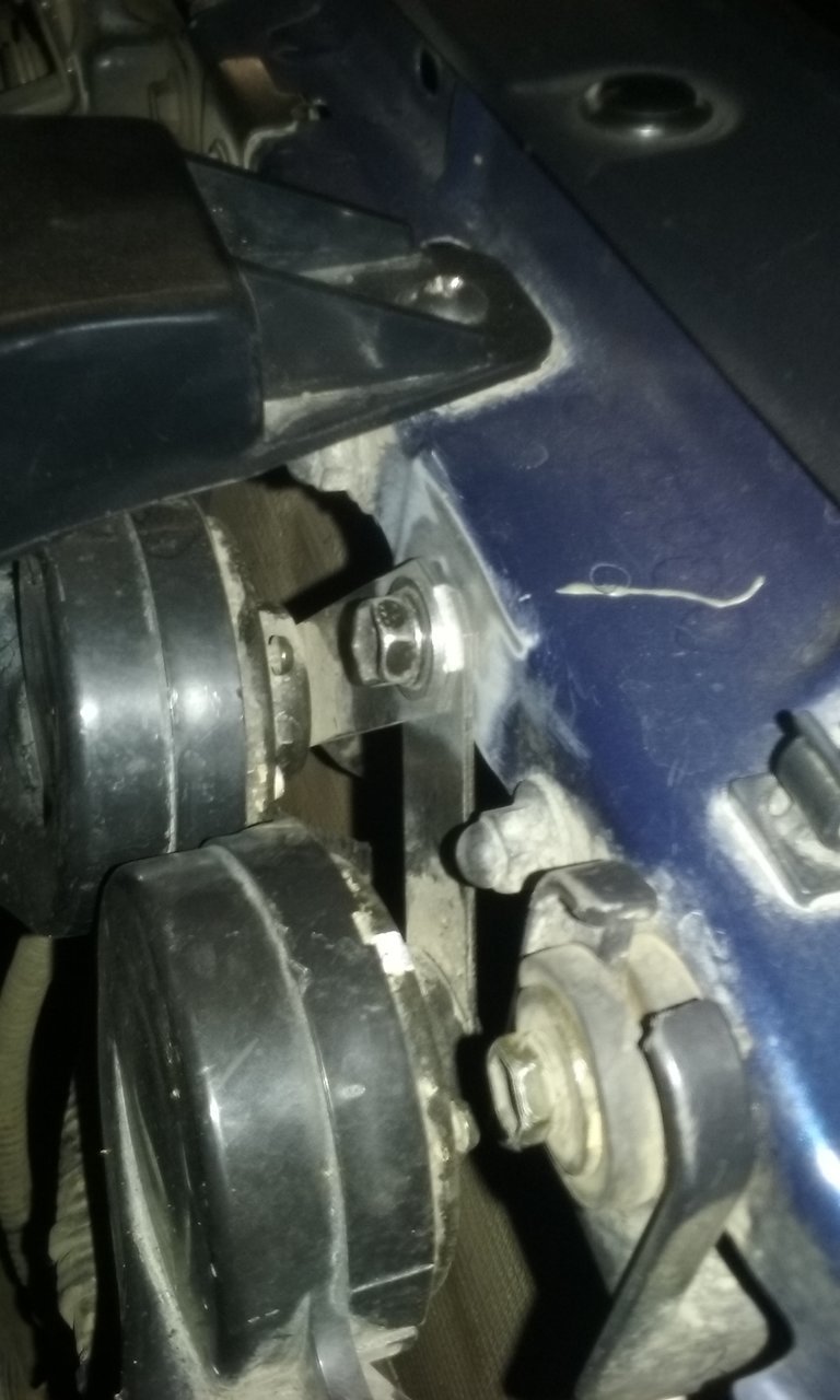

    Sounds like it.
    Cruise working? ABS light on?
    Op, pull ur horns and check for power at the connector.
    If theres power, ground the mount and try it again.
    One of mine only worked when it wanted, it was the ground.
    The mounting point is the ground and mine actually broke off!
    Wire brush the mounting point and remount it.

    I would guess the alarm is a seperate 12v input and the mount is still the ground so your horns work, just not thru the steering wheel switch.
    I replaced the original spiral with the $230 one the first time it went out and went with the $12 ebay one this time.
    So far its fine guess I'll find out...
