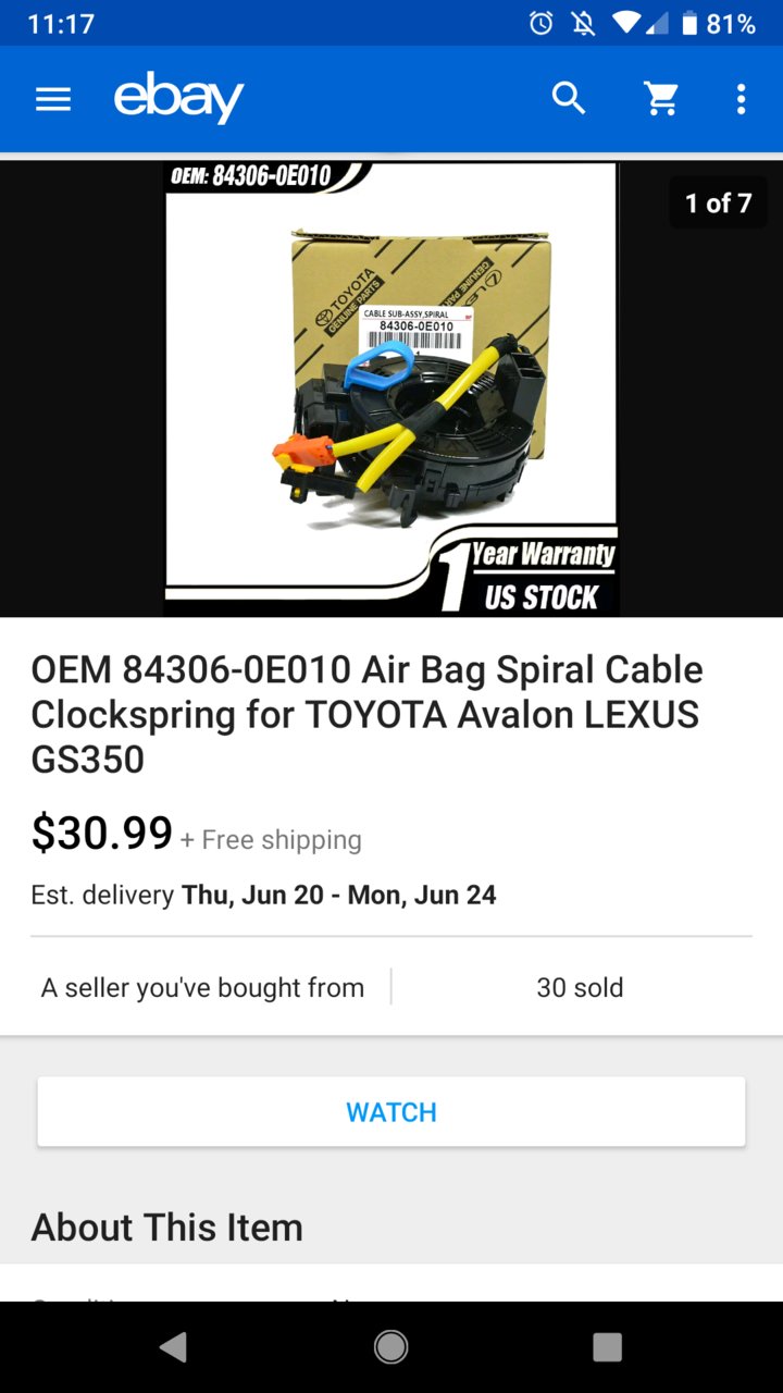

    I must have misread somewhere then..
    Thats not a cheap Amazon/eBay part then. Lol
    This is what I ordered. We'll see.

    I got mine through Gunny. Was reading about the ebay/Amazon replacements going out within a year, so I figured I would go with a genuine OEM part on this.
    It is a really easy fix, even if you have to do it once a year. Takes about 10-15 minutes.
