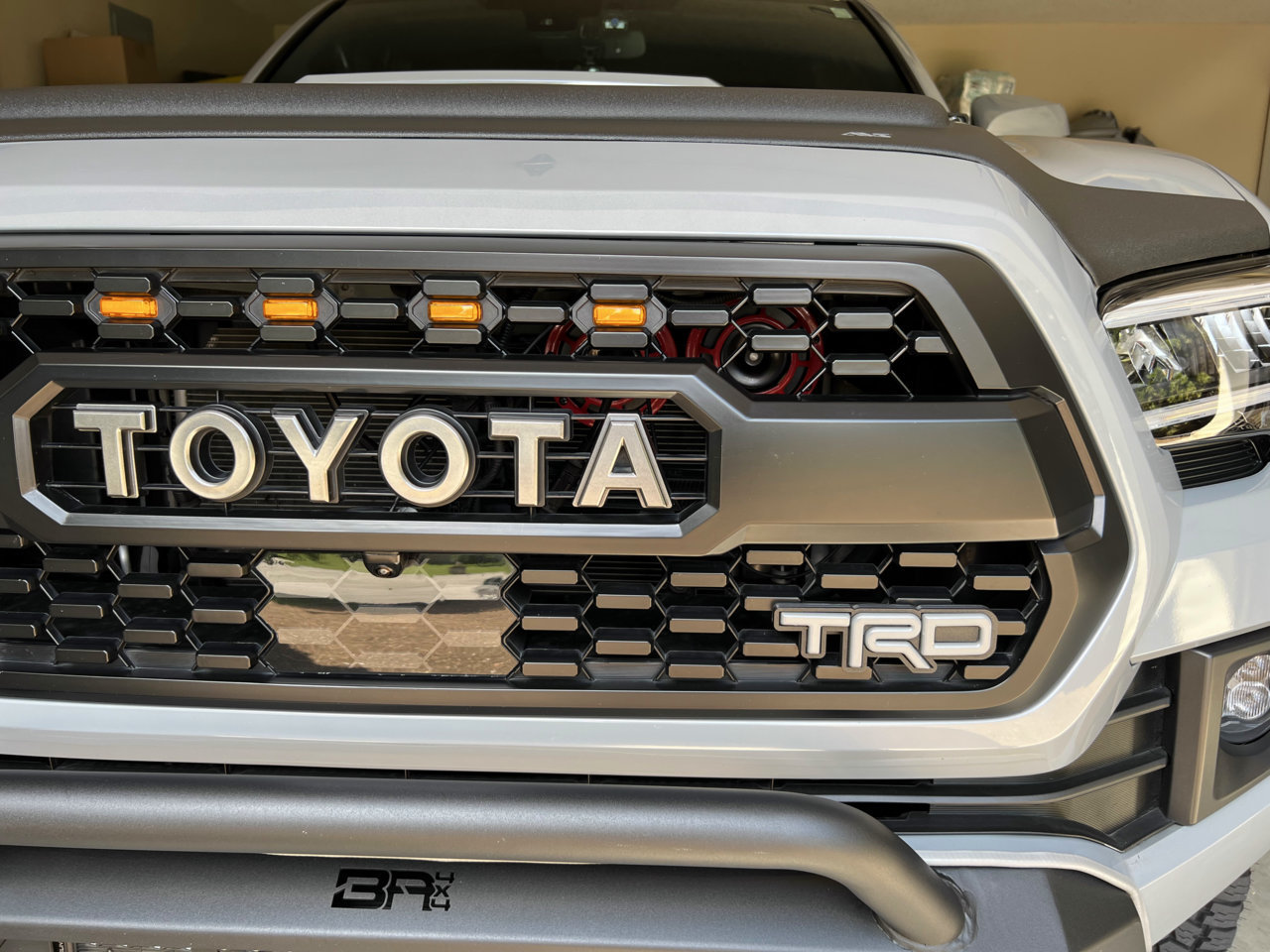

    HELLA Supertones. Inexpensive, very easy install, scary loud.
